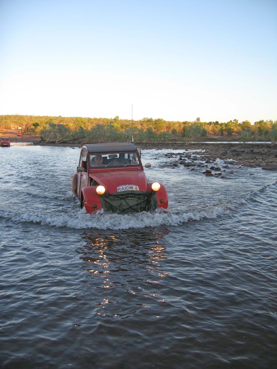

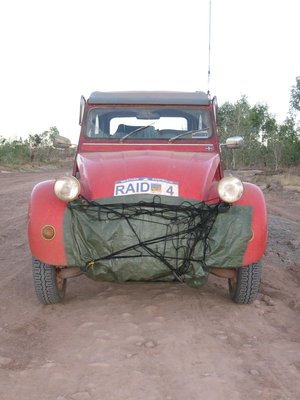

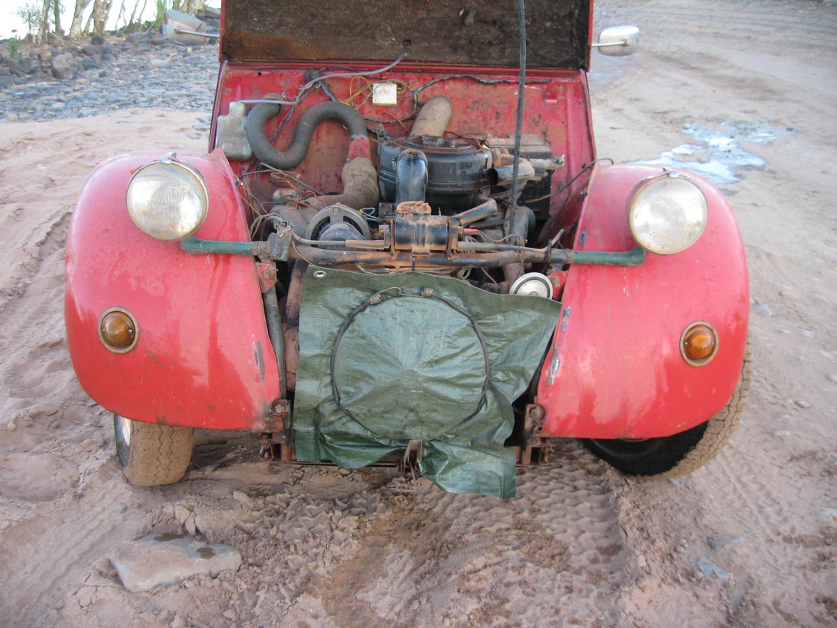

Hopefully, we'll have to cross a few rivers. Its good fun, if you survive, even if you don't.
Bring a plastic cover and do this. If the river/creek is too deep, remove the fan. Electronic ignition is not very safe here, so bring complete points/condensor set if you need to convert ''back'' to points.
