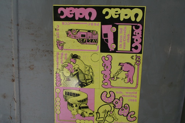

Ah ok. Love the colour scheme. Do you have a better picture of that udac sticker?

Thanks Max, and of course we will advertise the forum throughout the whole trip.
Udac close up:
http://www.studioru.co.uk
September 28th, 2009, 2:12 pm
Post Re: The Walmington
Ah its just a sheet of stickers. (I think)
Cheers.
