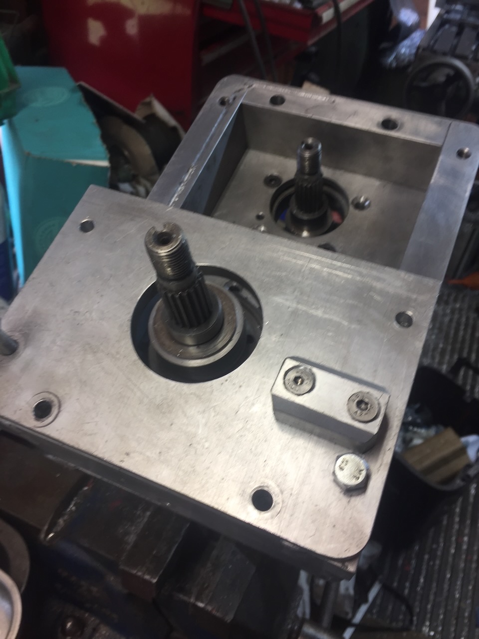

Output shaft selector mechnanism...please ignore the cock-up bottom left :(.

It's no cockup it's an extra oil reservoir.

With this small extension of gearbox, the original amount of oil might be need to put two or three times..?
Looks very nice, waiting to see it completed...
June 20th, 2024, 7:15 pm
Good point, maybe an extra 0.5 litre?
