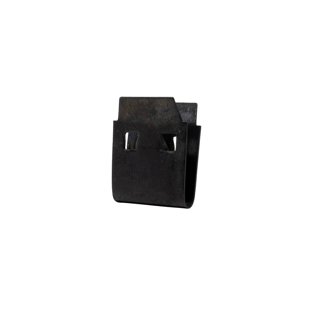

Before spraying the body, we put it together for the test. Now we come across a small problem.
How is that little clamp on the back of the rear mudguards fixed ? We tried to fix it,but we can't get it fixed properly .
March 5th, 2024, 8:12 am
Posts: 2253
Post Re: �1965 2CV AZ
It normally is hammered on from the bottom. Think of fitting the aluminum lining between wing and body first.
