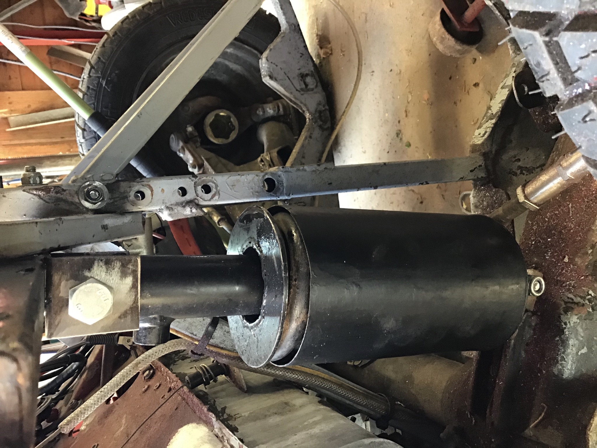

Front strut first fitting, seems to be ok?
The tie rod just clears the bottom of the strut.
Height of strut may require a dimple in the bonnet:(

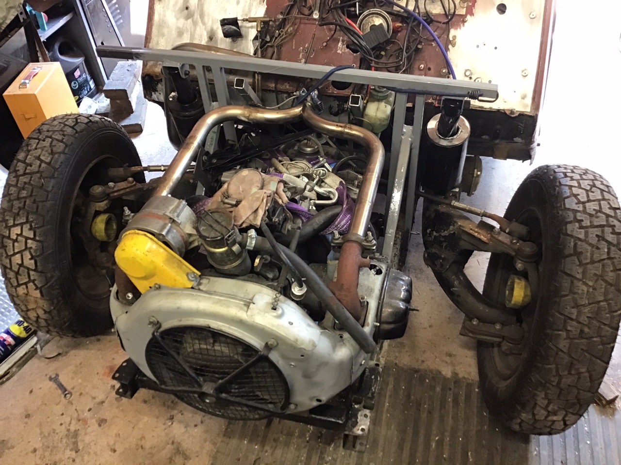

Repositioned one of the front struts, all works ok for clearance and is softer.
But see pics of the subframe?? Its a bit of a mess, so have ordered some new steel, will attempt to design/fabricate a tidier frame:)

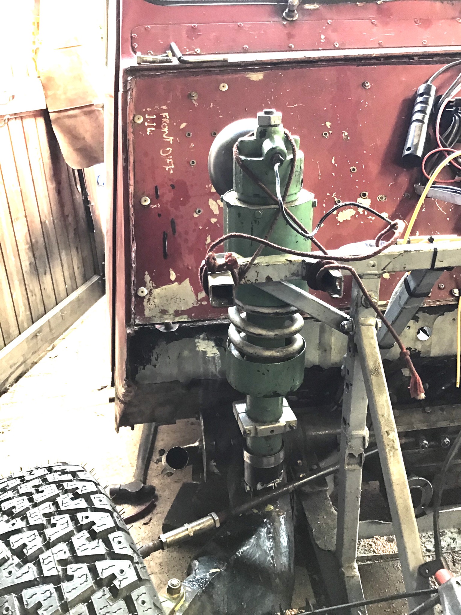

Have made a strut that has the spring working, irrespective of suspension height.
Parts required...
Front view...
Side view...
The top mount sits half way down inside the spring and the hydraulic ram is attached there.
