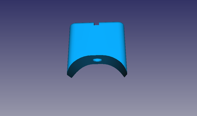

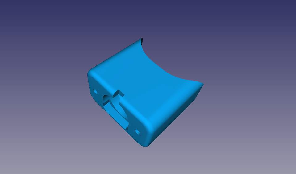

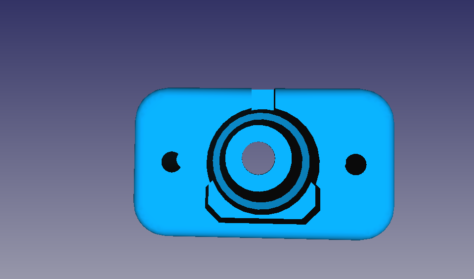

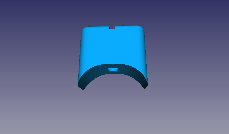

i've been designing injector bungs to go down on the inlets ports.
The idea was to 3D print prototypes in ABS. Then get them CNC'ed from alloy. Then glue them on.

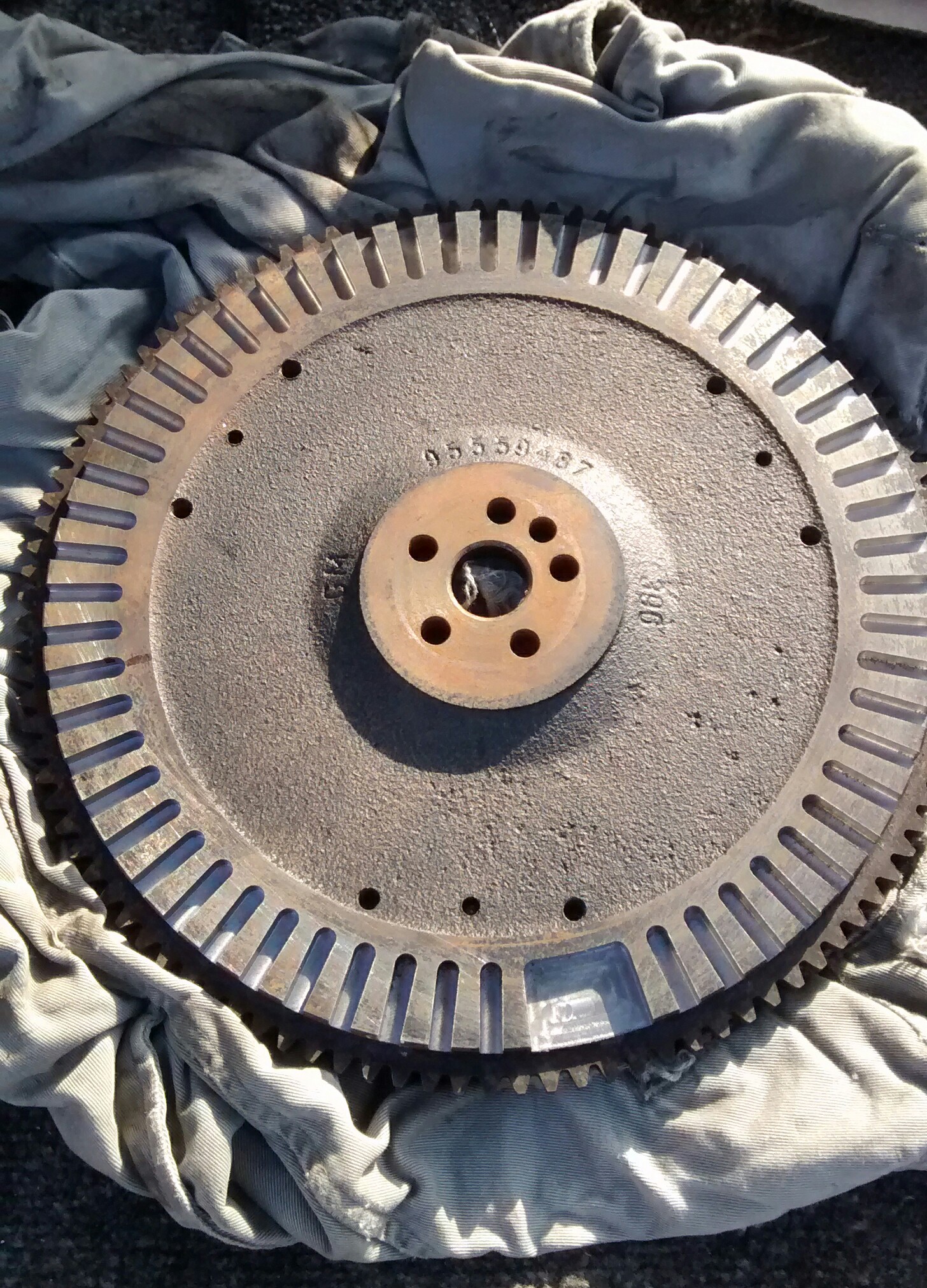

Q. What sort of trigger (wheel) are you using and where.
April 9th, 2020, 6:29 pm
Post Re: Spot The New Part
I had a spare flywheel machined
Fitted it when I swapped engines. :D
April 9th, 2020, 7:10 pm
Like++
Do you have a drawing, CAD etc?
April 9th, 2020, 7:46 pm
I don't, the chap who machined it said dont bother when I offered, as it would be very simple.
Its 60-2, so to balance, the missing teeth, also need to be machined on opposite reverse side.
