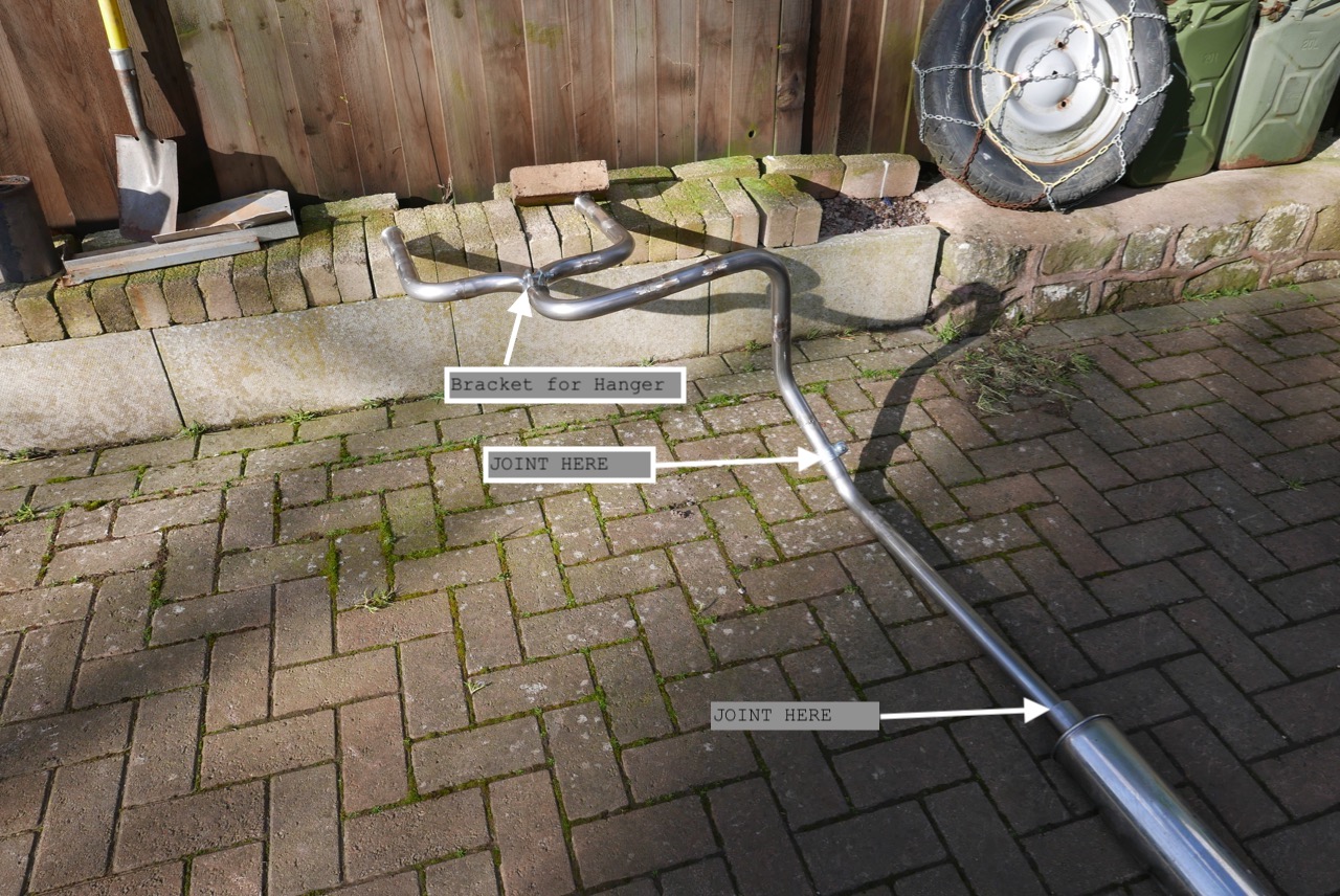

Bit more progress..
Plan to block one end of the exhaust and fill with water/washing up liquid, to check for all the holes and weld those up.
Don't think one silencer will be sufficient as the cross box is missing.

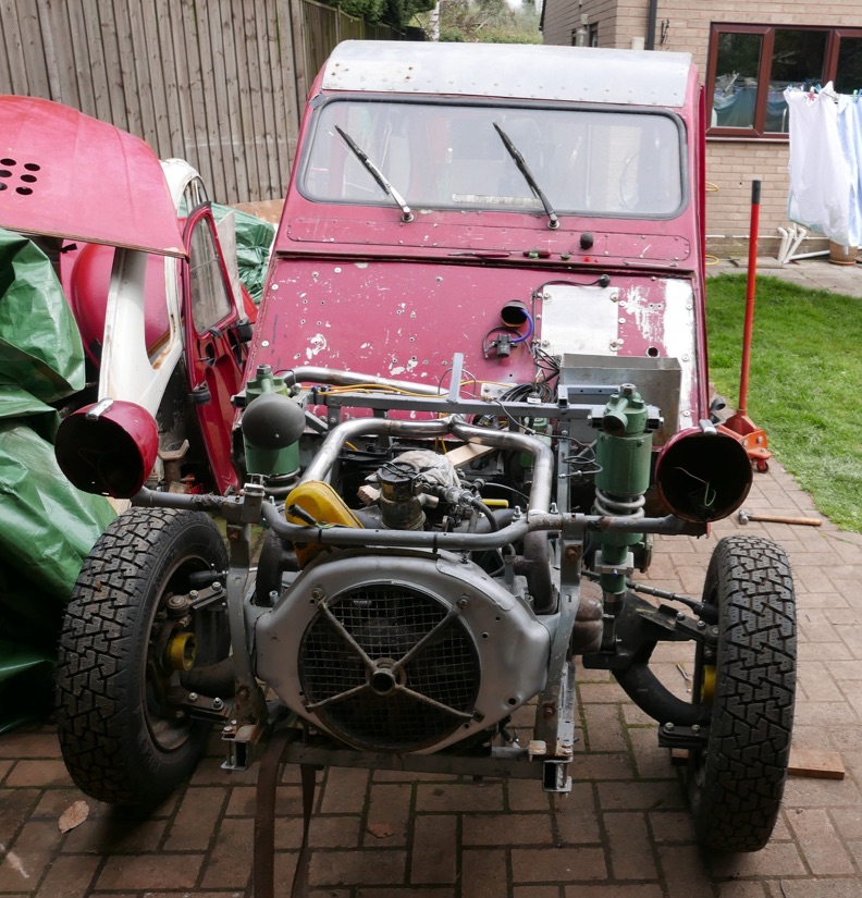

Out in the Sunlight, can now see just how many bits still need to been fettled.

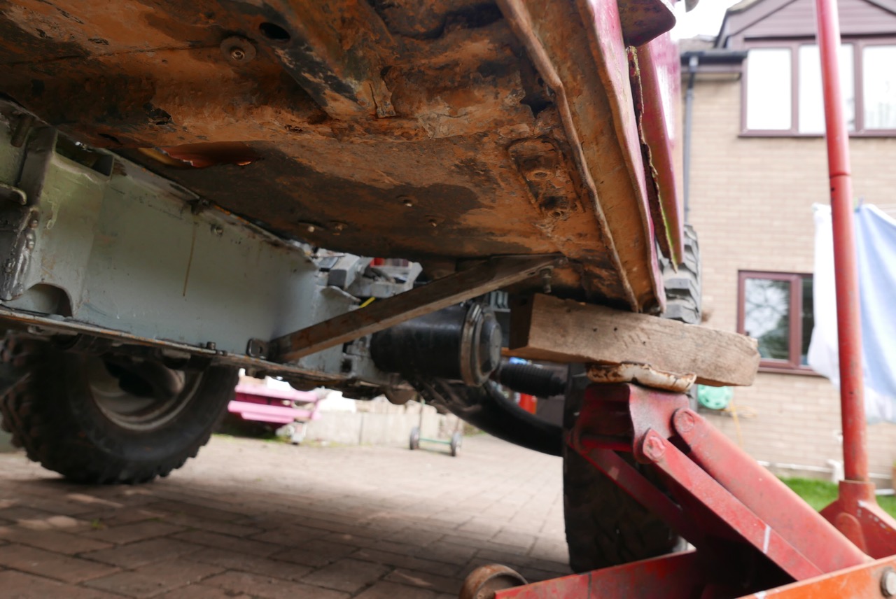

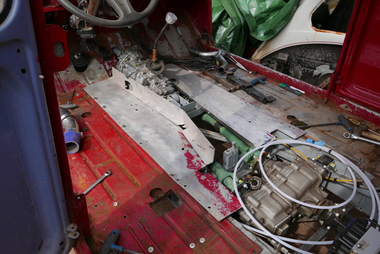

Using the old floors to fill some of the holes in the "colander" body shell also needs a bit o support underneath.

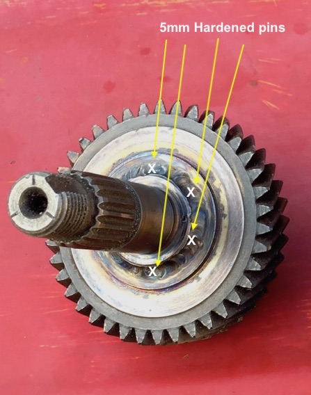

Plan to remove engine/front gearbox and improve the strength? of the transfer pinion.
Part to be modified, currently only welded.
Drill parallel to shaft and push fit 5mm pins.

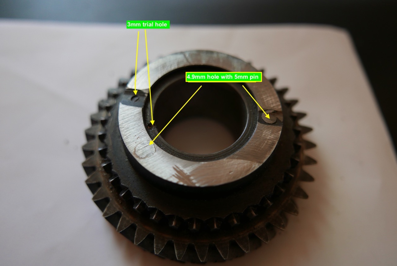

"Try out" to pin gear onto shaft
Using an old gear, have drilled and plugged two 4.9mm holes.
First attempted.
Using 5mm hardened pins od 5mm but they only go in <1mm, had thoughts of getting ground to 4.9mm + but that is a lot of hassle.
Second attempt.
Using 5mm mild steel rod, pin goes all the way through, with small amount of material shaving off as the pin is hammered home.
First attempted.
https://uk.rs-online.com/web/p/machine- ... s/2244476/
Get a reamer, and make the hole to 4.96-4.98mm with that. A little tapered reamer, and you can have whatever size ever works with...
