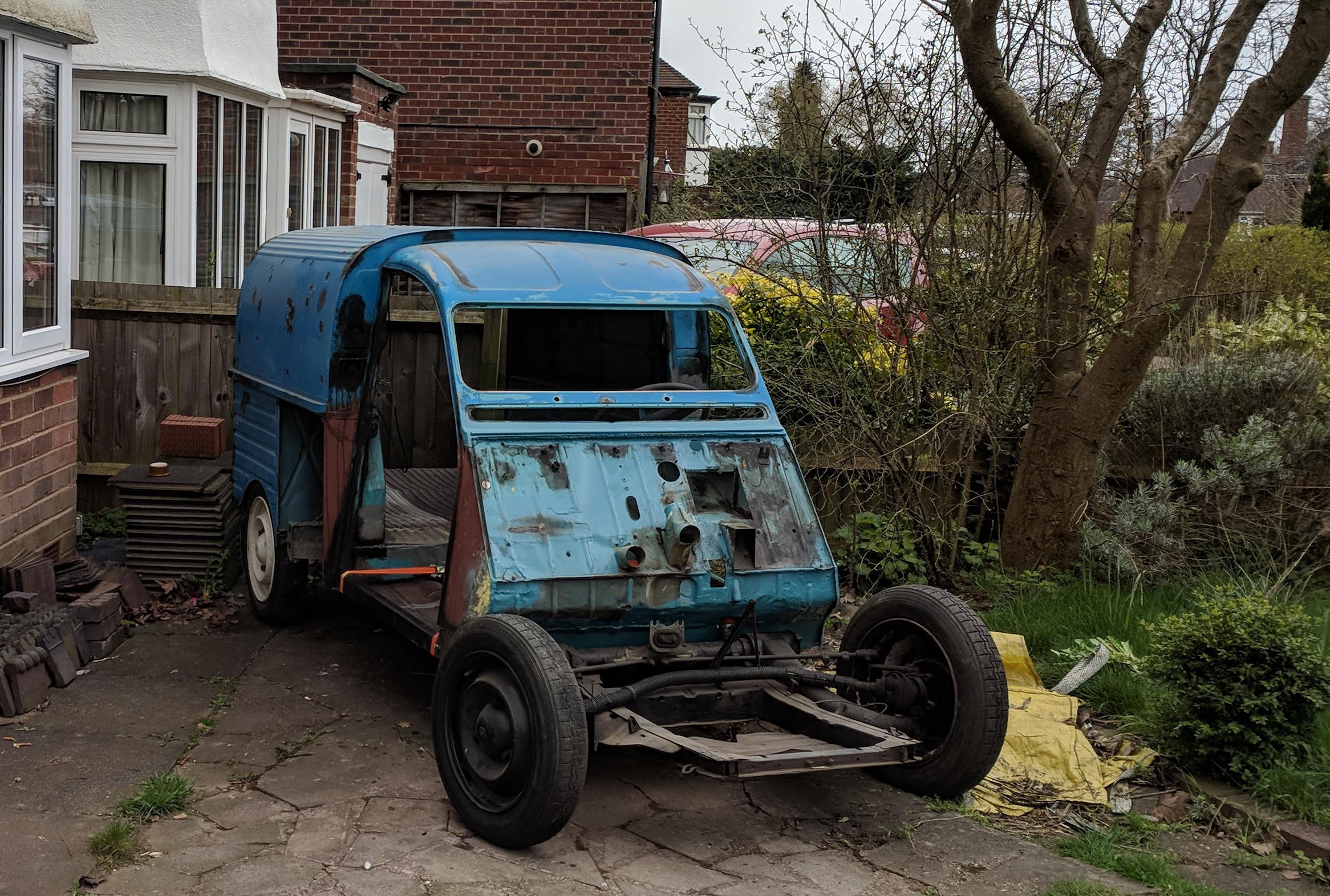

Hello everybody!
I've been away for quite a while, but I'm happy to say that I'm now back... trying to pick up the pieces of a project that had to be put to one side while I attended to urgent matters.
My van has had no attention for 2½ years and is looking a bit sorry for itself. Thankfully it was stored in a dry barn on a farm.
Last week I moved it to my home and re-started my work on the bodyshell.
I'd more or less finished the welding jobs before the enforced lay up. Now it's a case of fixing up the surface rust spots and painting it.
