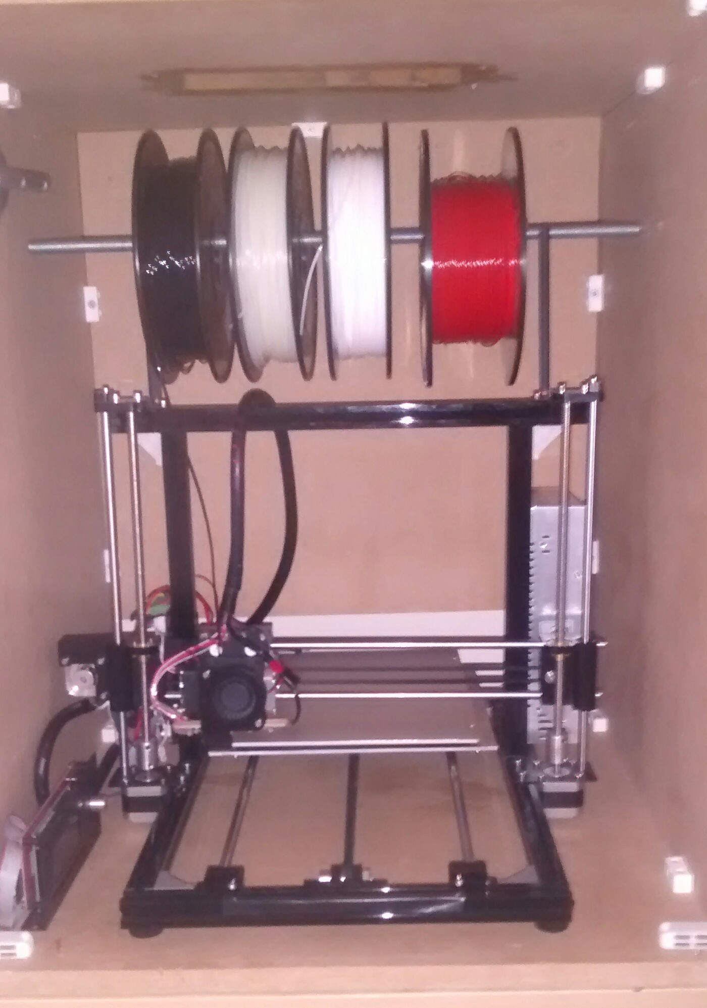

I acquired a 3D printer a few days ago. Just have to learn to use it now. :D
