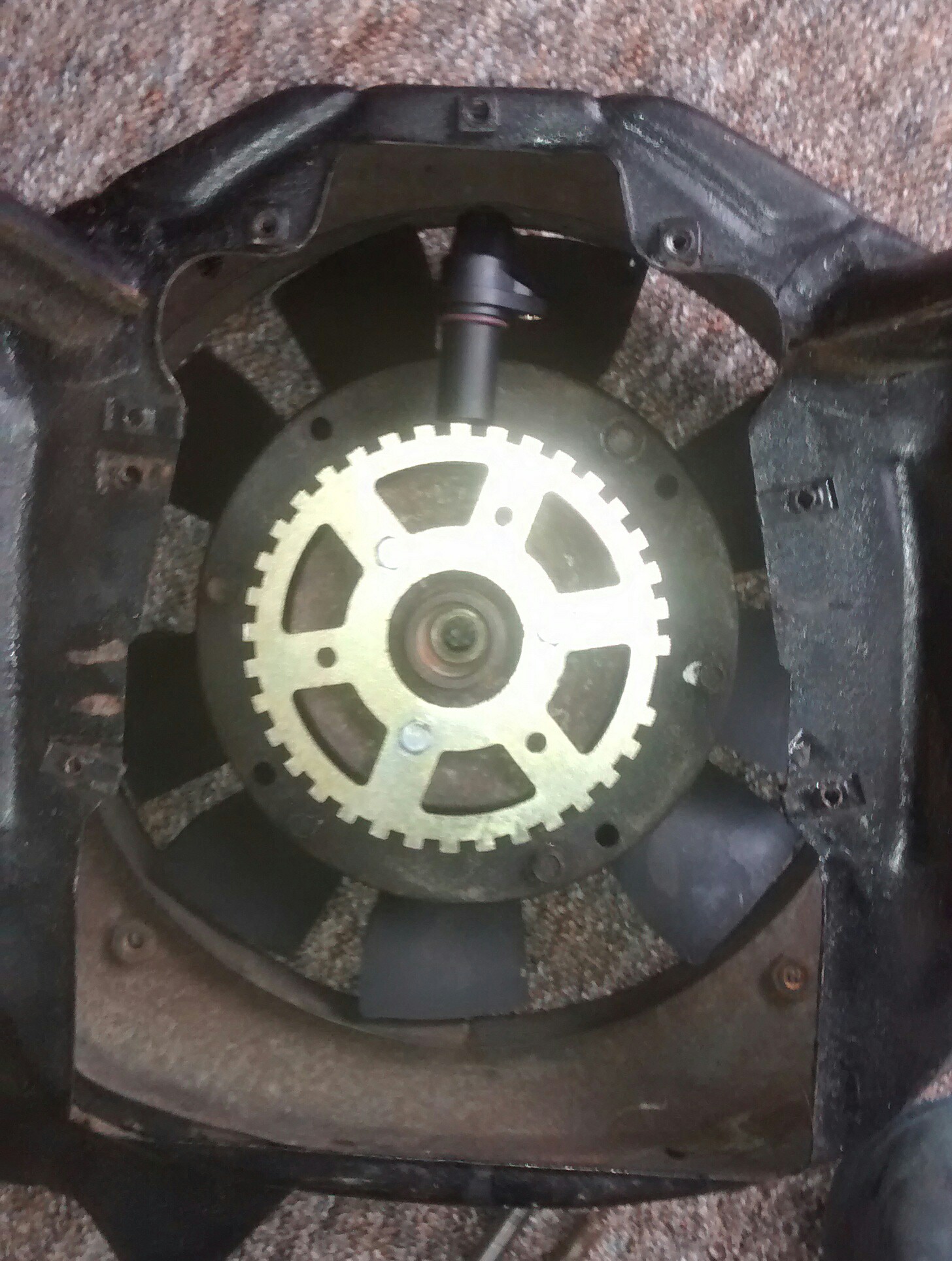

Trigger wheel attached to back of fan pulley.
Manifold drilled for MAP connection
Bracket made for TPS
HE sensor bracket made up but not fitted as have to remove luminition to do this.

File comment: trigger wheel and HE sensor. But I've changed it from this

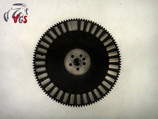

VGS solution
http://www.vgs2cv.be/index.php/en/home- ... ish/tuning

I don,t like the vgs solution. If you have axial play at your crankshaft your signal is gone or you're sensor.. Putting it on the head of the flywheel it always workes..
