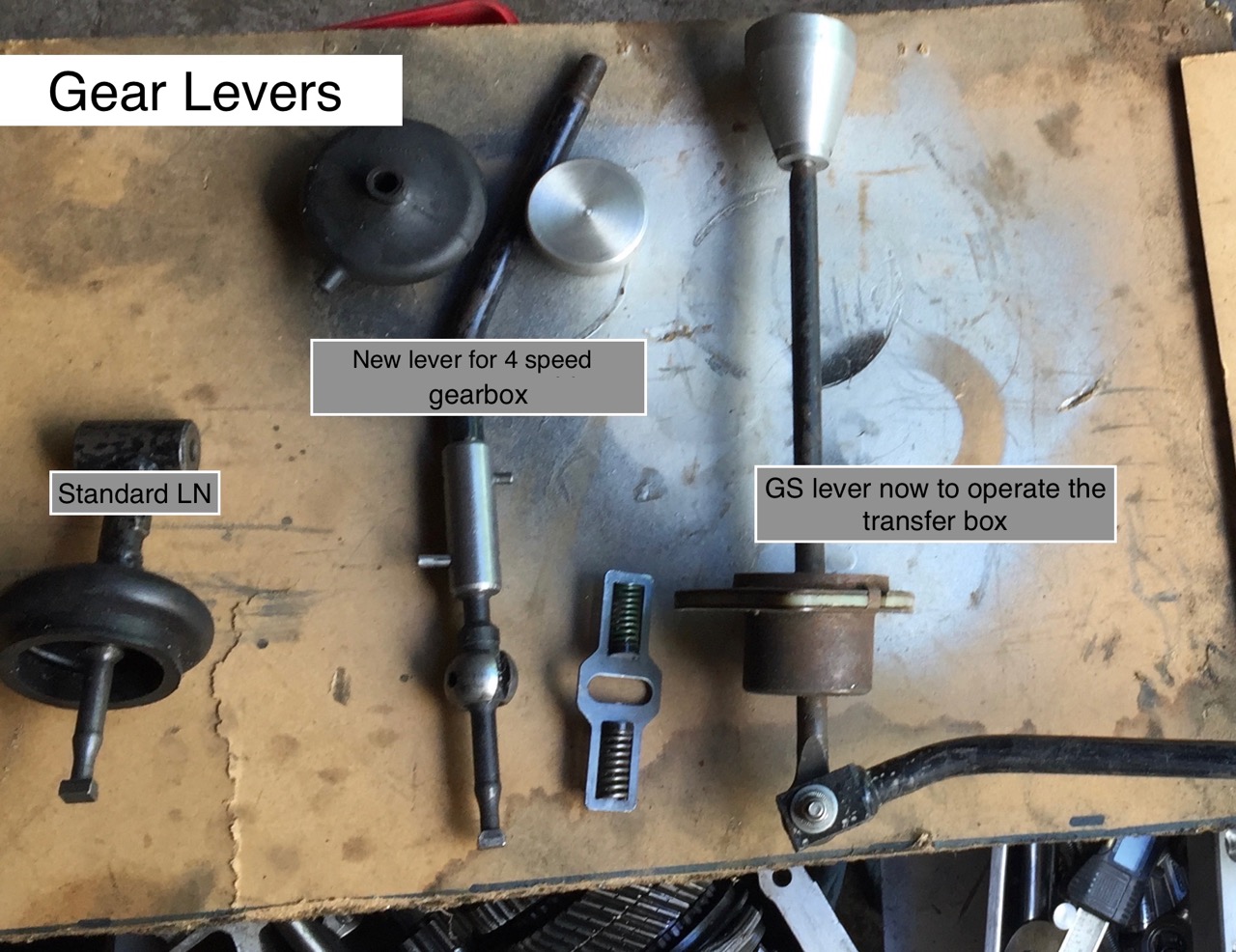

Gear Levers...

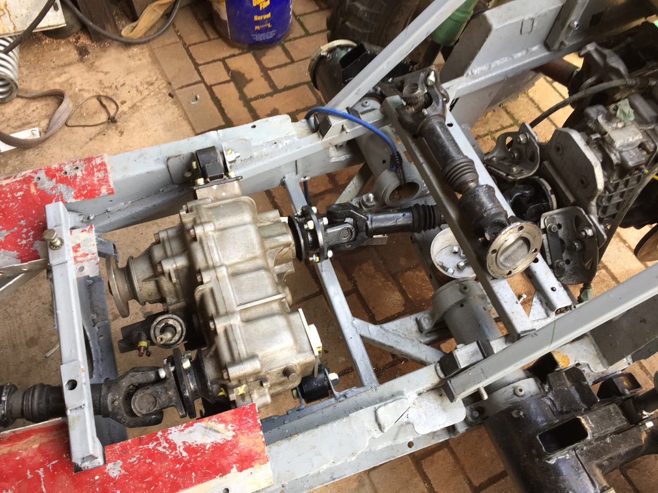

Remote Gearbox bits.

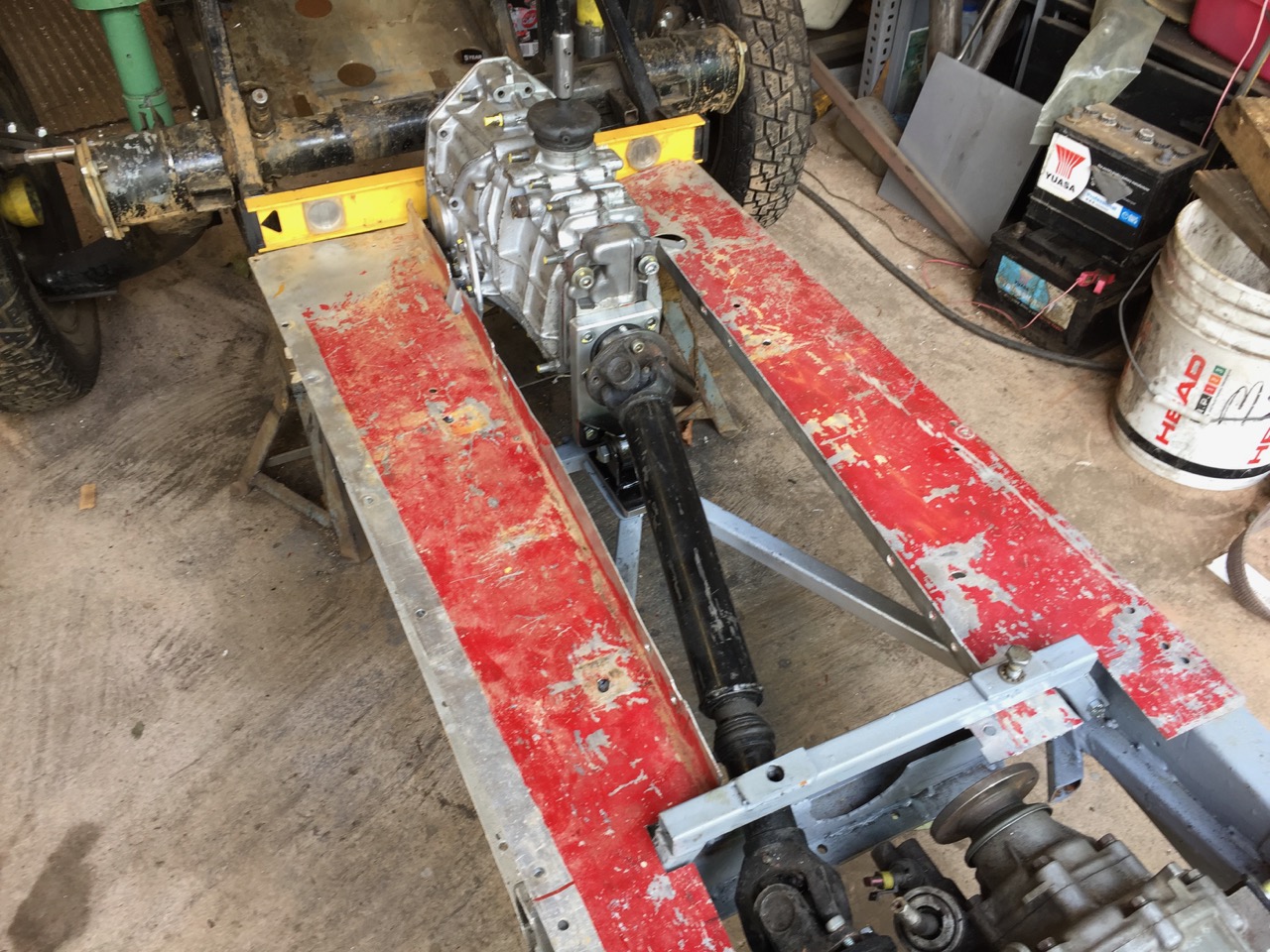

Fitting the Floors!
https://youtu.be/ZuLqfQC3KSY
See https://youtu.be/ZuLqfQC3KSY

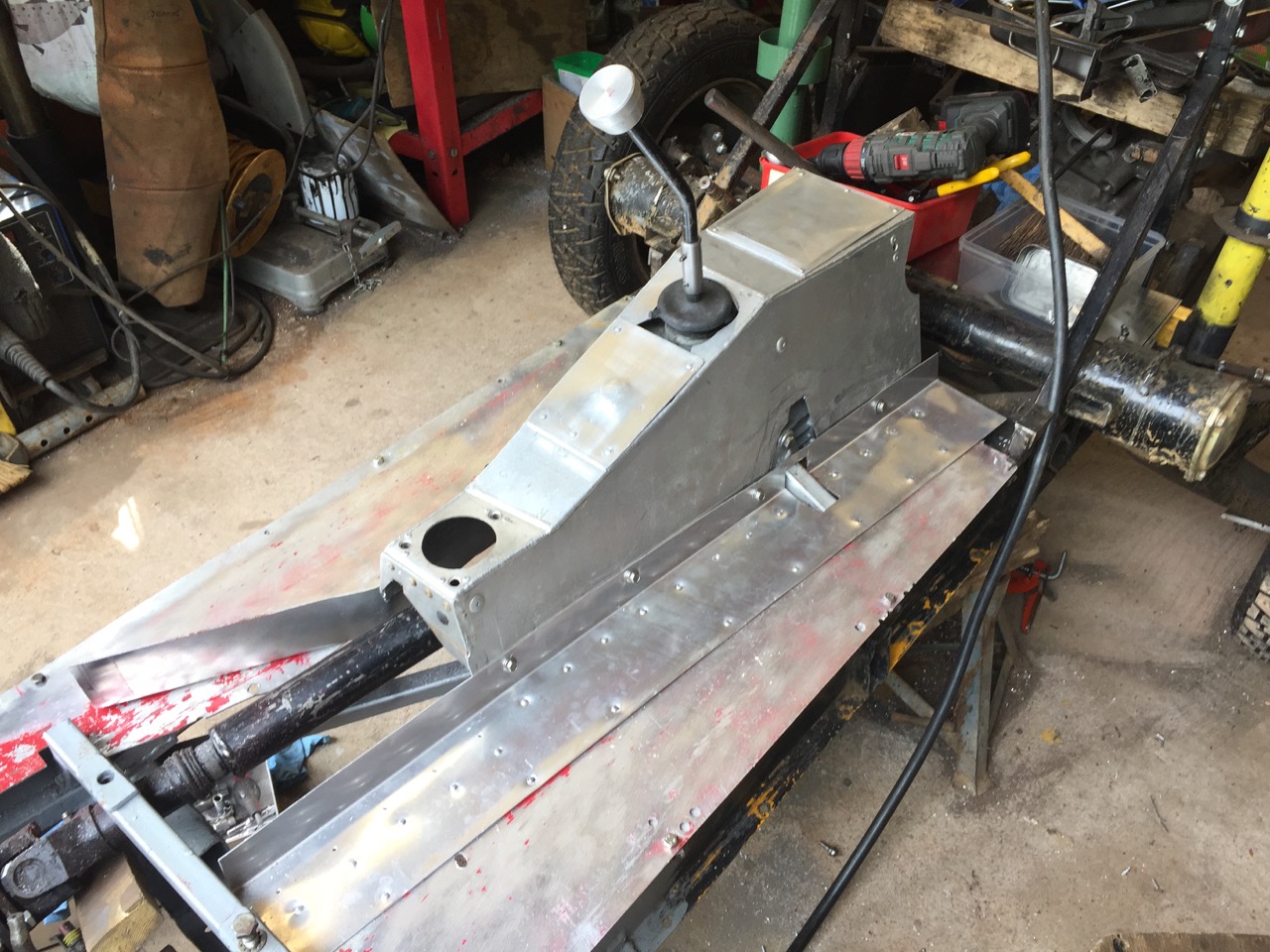

Transmission Tunnel?
Re-used the old floors and gearbox cover.
Make do and mend as the saying goes.

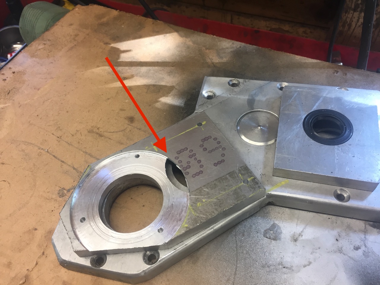

Oil Seal Plates for the Front Diff.
Over zealous with the Mill :(

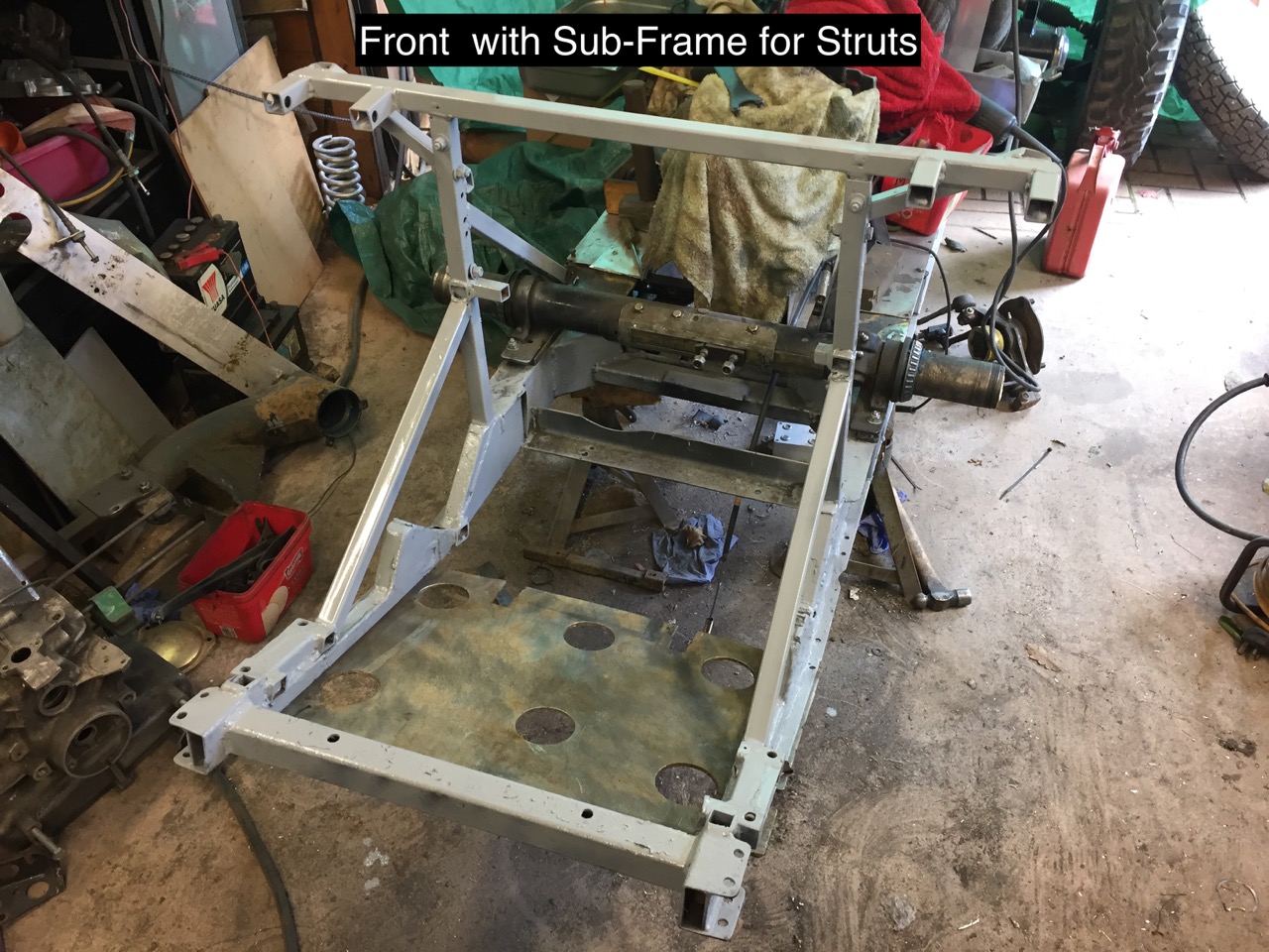

Lots of Lathe/Mill/Drill/Gears/Bearings etc..
Front Diff is almost complete.
