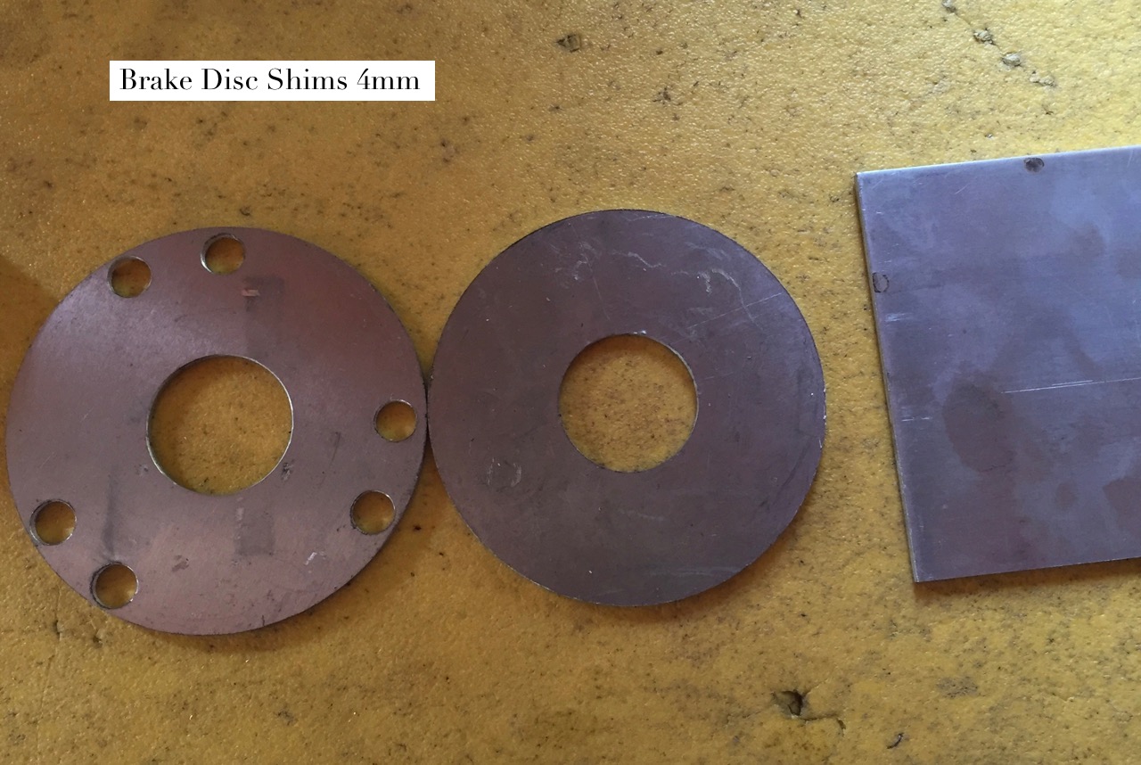

Attempted to fit different Calipers on the Rear Diff.
Had to make some 4mm shims so that the discs don't foul.
Just a bit of jig sawing, milling, turning and drilling ie Standing Still, sweating buckets as its 31C

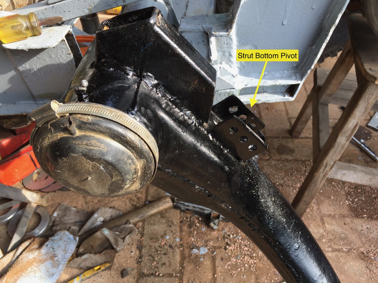

Rear Arms.
Bottom mount for the strut now has 3 positions to allow for adjustment of the spring rate.

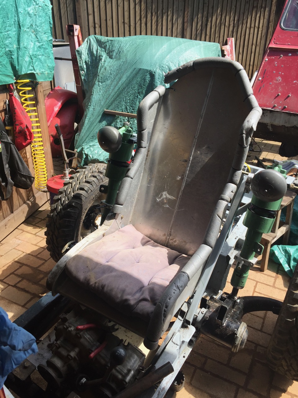

No room for a proper 2CV rear seat.
Shall I fit this seat ? (with seat belt)
July 2nd, 2017, 12:35 pm
game of throne... well sort of.. :roll: :roll: :roll:
July 2nd, 2017, 6:31 pm
Posts: 2303
is it an ejector seat?
July 8th, 2017, 3:32 pm
2 people can push you out of the mud better then 1.... SO mount it.. Its a win win for you and a cry cry :cry: for them...
