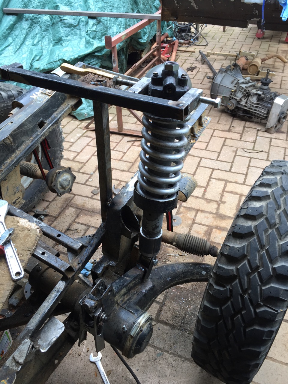

Rear Suspension.
To stop the excessive "ROLL", going to fit coil overs struts to the rear suspension, same as the front suspension.
I plan to make a frame, that bolts to the chassis, with holes (Gaps) in the rear floor.
The frame will be mounted after the body has been fitted to the chassis.
Lot of measuring and try outs photo's show one side of the rear setup.
Don't think a standard rear seat will fit even with the struts canted to the rear.

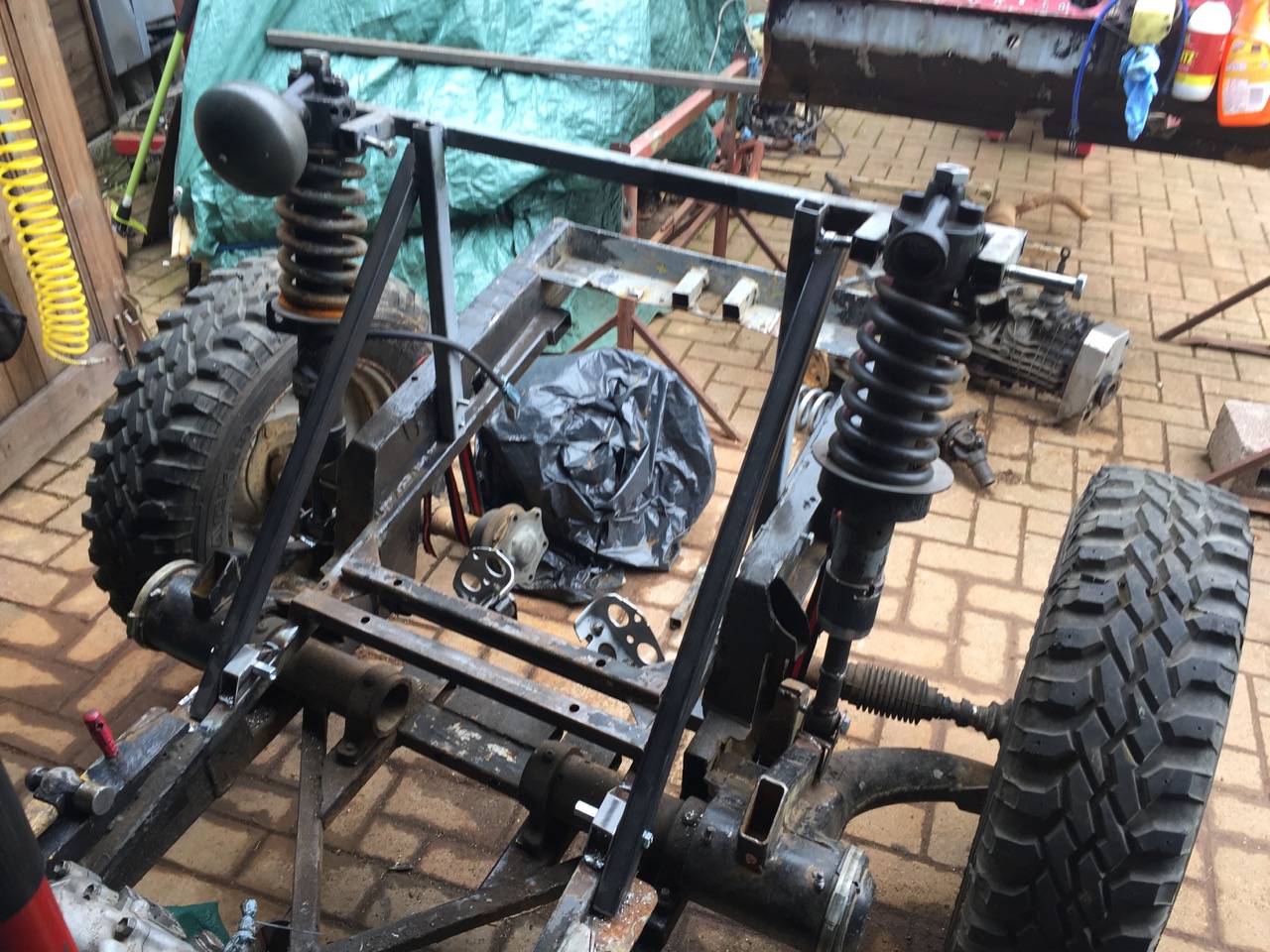

May 30th, 2017, 1:17 pm
Posts: 2258
Rear Suspension.
Have pretty much got the spacings for the Rear Springs and also the static ride height figured out. :)
Need to weld up the lower springs mount on the struts.
The frame is just bolted to the chassis.

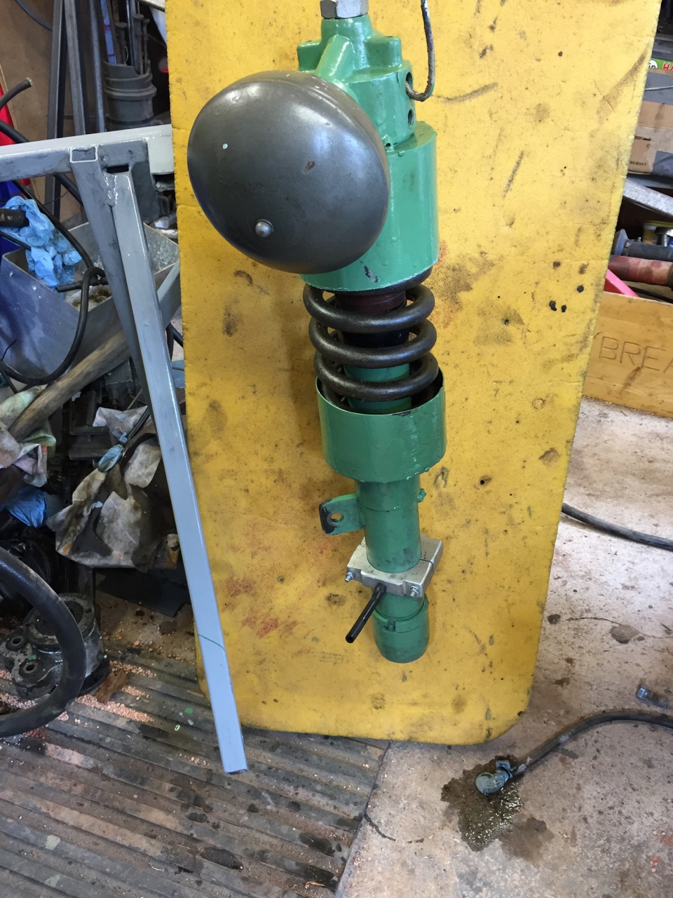

June 10th, 2017, 12:55 pm
Posts: 2258
Progress seems to be happening as I have now started to paint stuff, ran out of the other colours
so used some Myford green.
Rear Strut almost complete.
