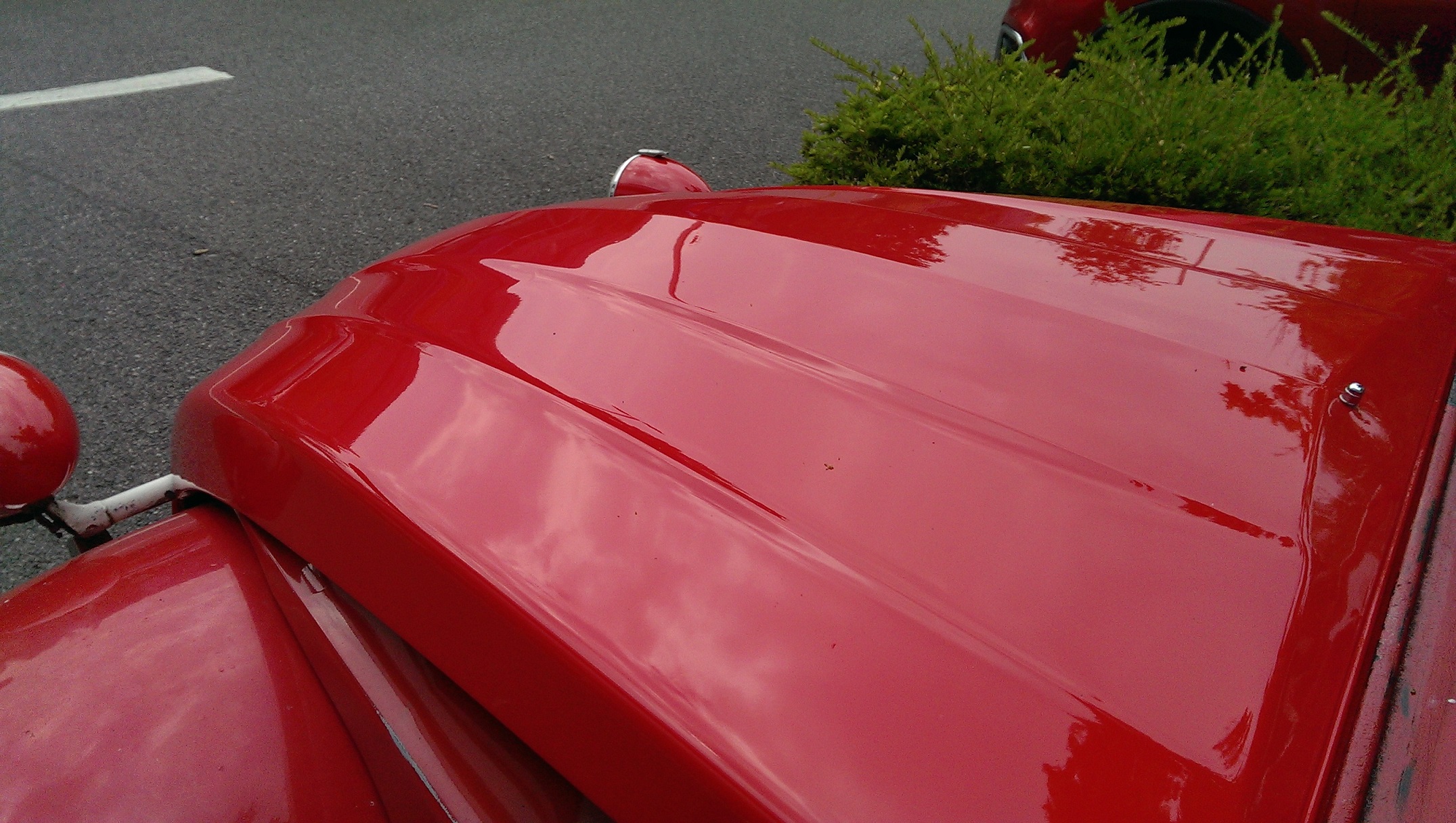

I've machine polished the remainder of the paint on all the panels I could bring indoors. Shiny! Also got my bonnet painted professionally - money well spent I expect, as he said the paint should be UV resistant and its been baked etc. It looked like a total bag of poo before even after polishing so I'm pleased with that. Example of door shinyness! Putting these back on the car made the rest of the bits that I hadn't done yet look really funny...

And shiny bonnet.

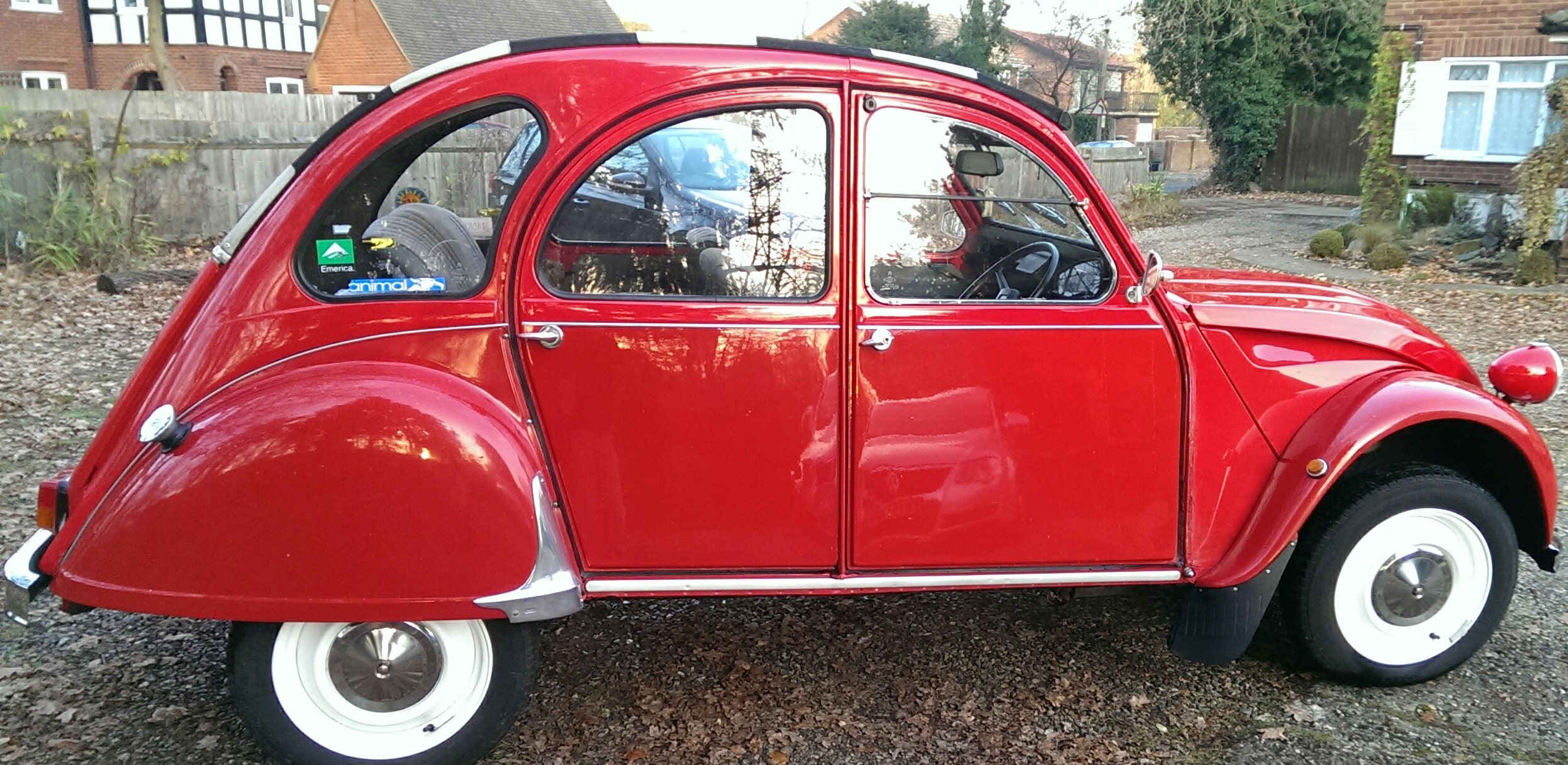

First wash and brush up since putting it back together. Very pleased with how it looks. Next up will be new wings, painted by the bodyshop if possible. I got a quote of £90 each if I paint the backsides.
It's fine as it is for now though. Now to angle to get some new wings for Xmas.....
