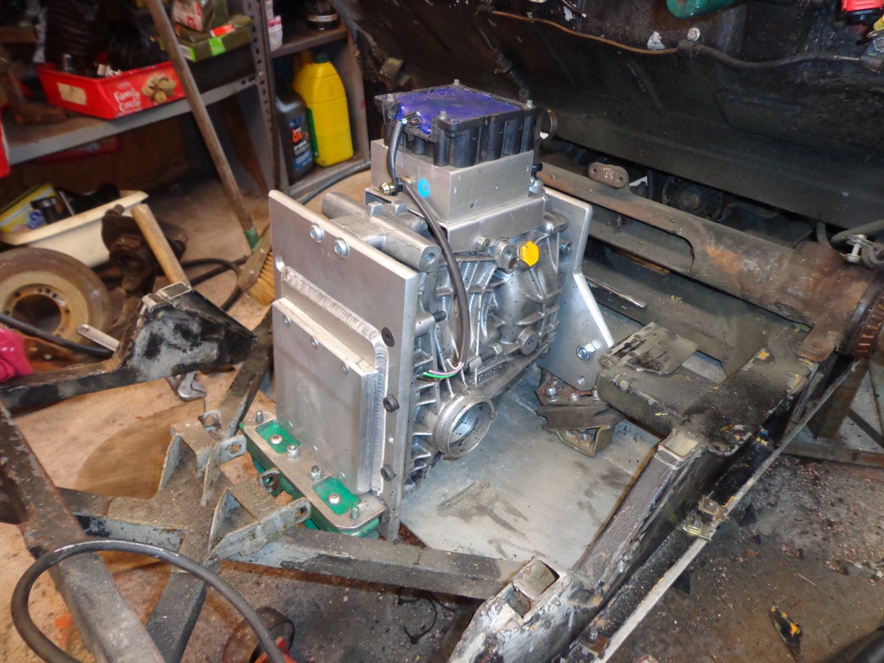

Fitted revised Transfer box with lower ratios it also site 2.5cm lower in the chassis.
See https://youtu.be/TiPV2IRYi3M
Fitted new front diff good clearance for prop shft under the axle cross-tube.
See https://youtu.be/2Rxk4ZqeImI
