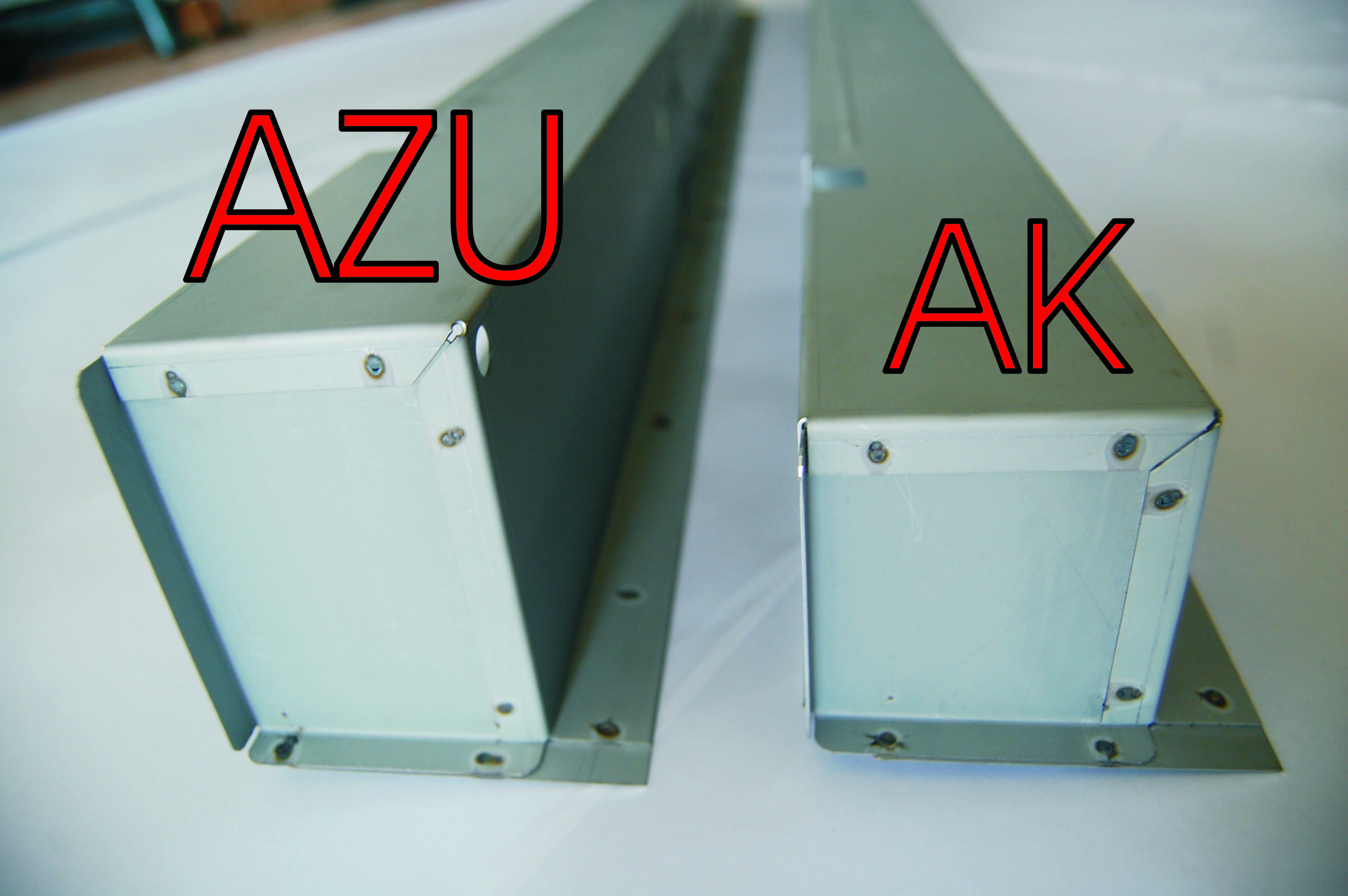

Post Re: Van repairs
Peter... AZU has shorter chassis so back crossmember is higher than AK...
www.2cvkeza.com
