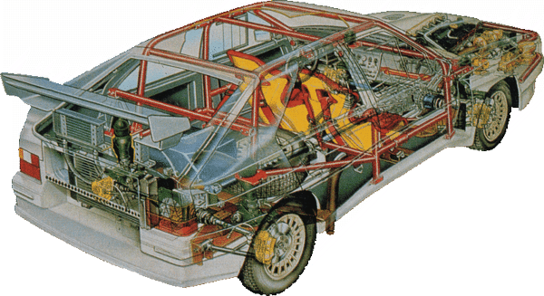

Putting in an aloy petrol tank will save you the tankguard which you have now about 3kg I guess :lol: :lol: :lol:
Turbo will be hotter for your engine oil then supercharger, supercharger has its own oilcircuit.
Turbo runs normally on engine oil.. However you can make a second oil circuit with external oilpump, and a big oilcooler somewhere at the rear end of the car in the rearwindow/lid or something like that... we must be creative in this..
I also love my big oilcooler in the frontfender(s), I will do this also with my beamer... just like my Turbo car...
