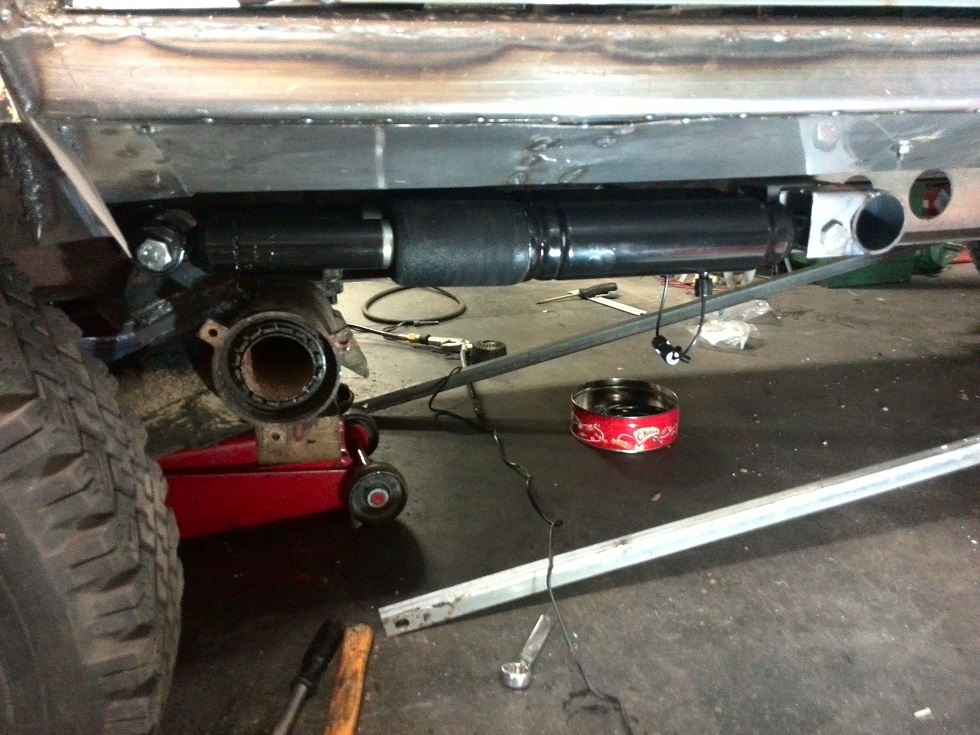

Last year around this time I bought some airshocks and today the time has come to put them under my car.....
So here we go....
First I bought some steel tube 60mmx3mm to make a cross-tube through the chassis..
Then I attached some U profil 60x60mm to host the airshocks..
Some sawing and welding and dryfitiing the shocks
Next is to put the tube through the chassis and mount the other two 60x60 U-profile..
As you can see the mounting eyes at the wheelarm needs to be on top of the axle, so lets modify the arms..
At last the shocks can be mounted..
So heres a little video, of the shocks... Theres only a little travel because the rearwheels
are hitting the body, next I need to modify the Louis Barbour reararms.. so then I have full suspension travel...
Full of air the suspension is very soft.. maybee to soft for raid but ok for trail-driving as I'm planning to do with it...
Maybee theres the need for 2 more schocks we will see...
