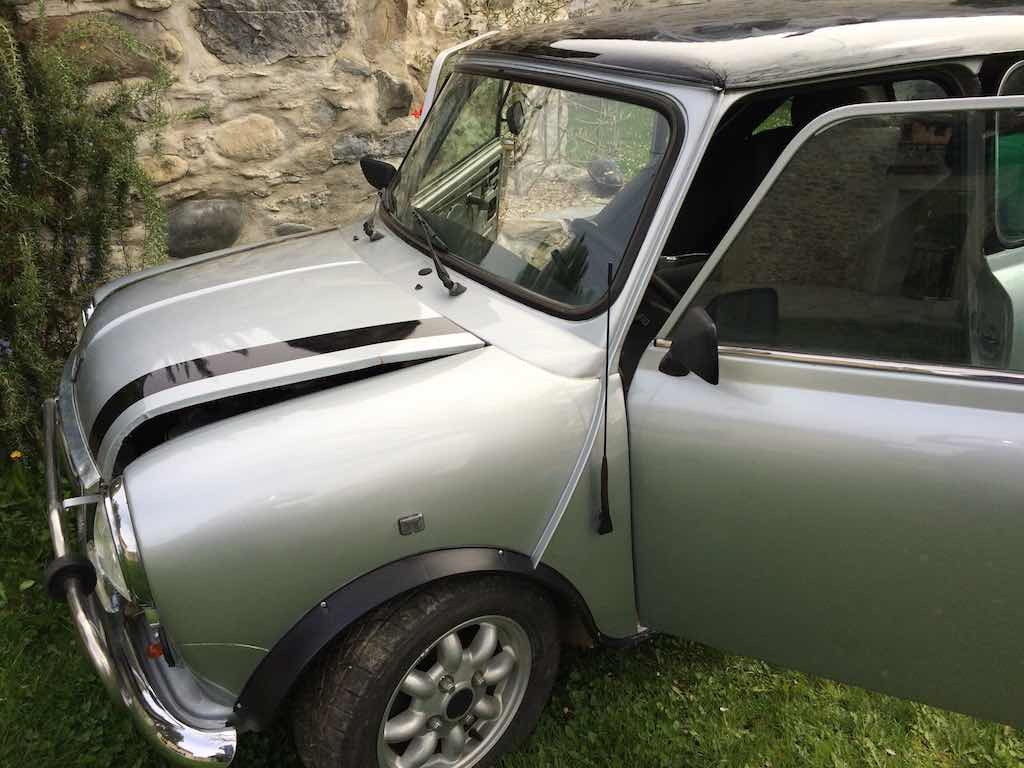

But then while we were there he was selling an Austin Mini 1000 from 1984. Bodywork and engine are perfect. Just has not got the time to look after it as his is renovating a barn and house (he lives in Toulouse and this is the weekend house). So I got my Lewis interested and just mentioned it to the guy and he went from €3500 straight to €2000 and in France that is an utter steal the condition it is in plus for Lewis who is 22 the insurance will be €130 per year and no car Tax. So Lewis will look on Sunday and probably take it. He will sell his current mini 1000 and I will sell the 4L he is using at the moment and I will also sell the Turbo Dyane (if anyone is interested). And that will be it for us for a while.
