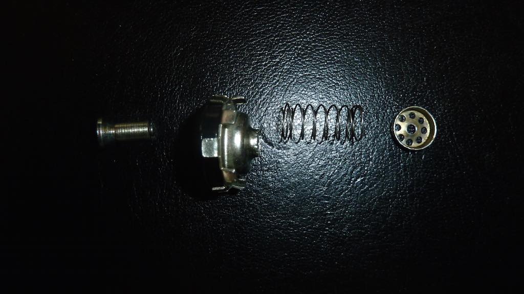

I went and bought an Eezibleed kit as the one we had seems to have disappeared :? Put it on as the instructions (20PSI off my Dyane spare ) and the fluid rushes into the Master Cylinder.
Went to the rear right brake drum, opened the bleed nipple expecting it to gush out (I have used this kit before on my son's mini) but just a slight trickle. This cannot be right.
So off comes the NEW master cylinder and I open it up to compare to the old one. I did measure the plunger orifice too and the new one is 44mm long and the old one is 46mm so not sure if that could make any difference :?:
But when I opened up the new I had a few too many parts floating around in side. The little non return valve had unriveted itself and the spring and holed disk were just rattling in the chamber. Hence the pedal going solid and no liquid able to exit the master cylinder.
Not too happy but I have my old (new replacement non return) part from the old Master Cylinder that I will put in now and try.

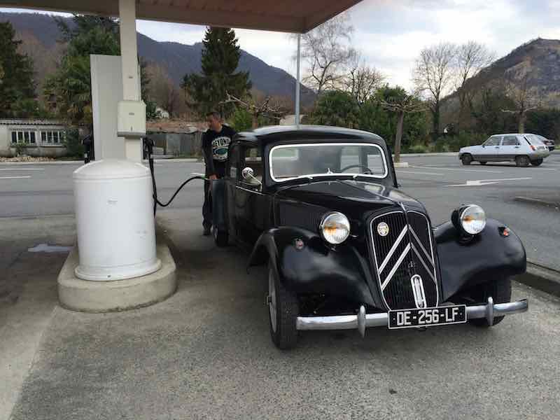

March 18th, 2015, 1:57 pm
VINNY IS BACK ON THE ROAD :D :D :D :D :D :D :D :D
1st time on the road since 1970 (just been told by the last owner who we stopped by the house and tooted, hello!)
Took him over the petrol station and put in 30 litres and up comes 30 litres on the fuel gauge...so that works. Lots more work to do to get him tidy but for now, he is a running Traction again :D

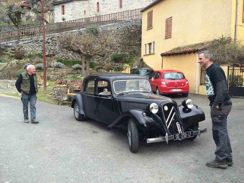

Here is the previous owner taking a look - all the family came out, joking how many babies were made int he back..... note to self, clean thoroughly :lol:

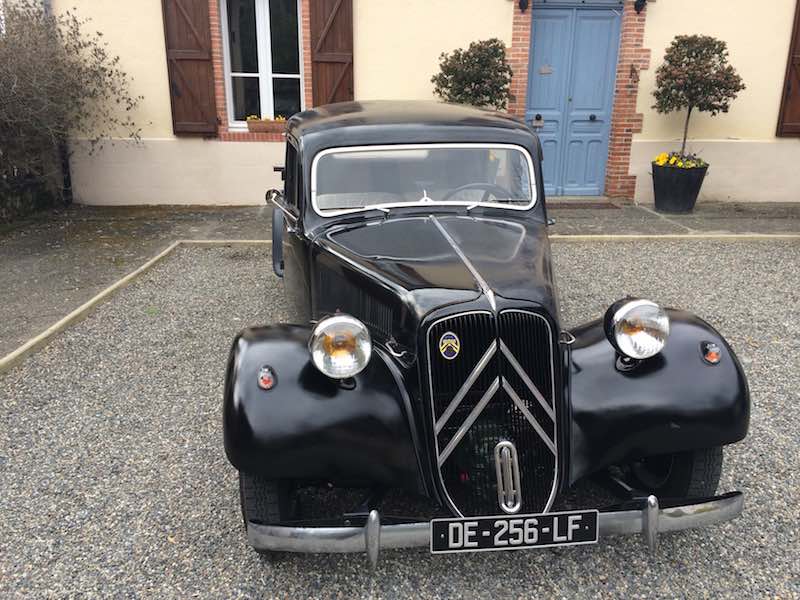

Parked outside his new home.
