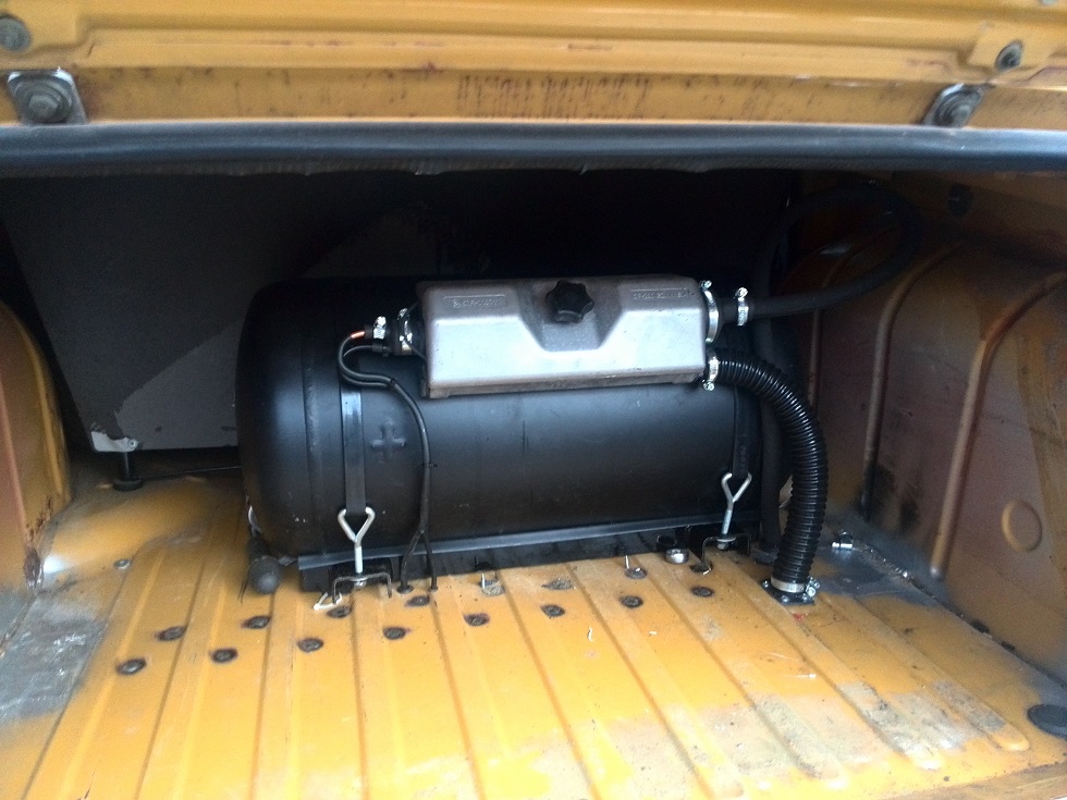

The tank I bought for 95,-- euro delivered to my door..

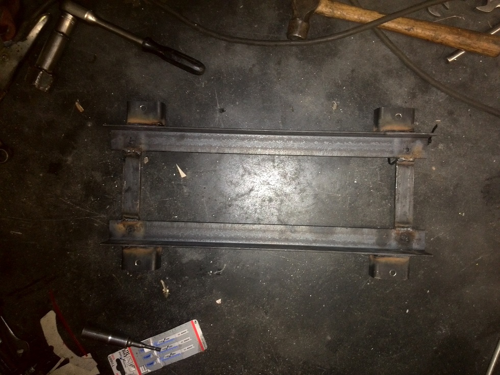

some pieces to make my own tankframe
a littlebit of weldie weldie :lol: :lol:
testfitting of the tank...

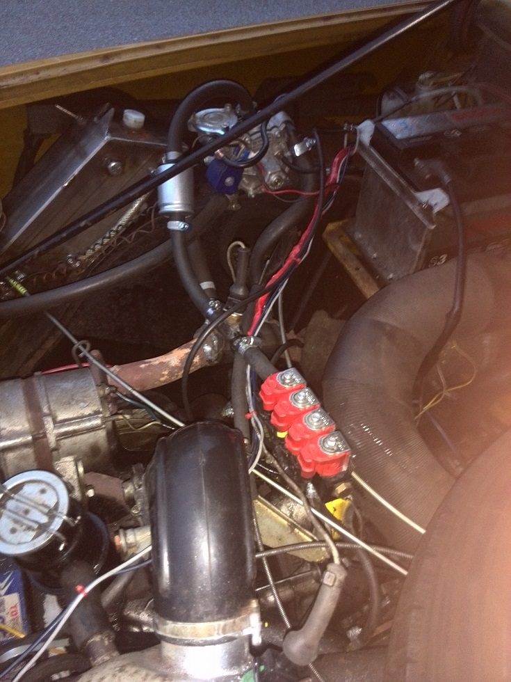

and a look into the engine-bay...

I see 4 injection-valves (red) in your last picture - I assume you still have the 2-cylinder engine mounted and not converted it to an Ami-supre 4 cylinder ? Does this mean you apply sequential LPG-injection with 2 injectors per cilinder ??
with LPGO almost nothing is standard, also this application is a little bit technically upgraded - keep up the good work Geo !
January 29th, 2015, 1:24 am
Post Re: LPGo's Ami 8 berline 09-80-MS
These are the injectors comming from my Bx-sport and yes I now have several possibilities...
At the moment I'm running semi-sequential injection with 2 injectors... So I have 2 injectors available for 1-2-squirt... If somithing goes wrong I can directly switch to Megasquirt and drive on.....
You need to know it is harder to get a car run on lpg injection rather the Petrol.. The ARF bandwidht of gas is much less then petrol.. So if my engine runs decent on LPG it will surely run decent on Petrol...
and if I don't need to switch to Megasquirt anymore I can make sequential staged injection as you wish... However if we want to do our setup (1 BMW 1150/1200 throttlebody you best you can run is semi sequential...
Please take a look at this I found this at youtue, it is very interesting, but again using the software of Megasquirt and I'm doing my own as an extra handycap...
[YouTube]https://www.youtube.com/watch?x-yt-cl=84838260&v=lcwrLTaYJ_o&x-yt-ts=1422327029[/YouTube] use it just for the principles of it.. Ofcourse I'm doing it in another way...
If I talk to the so called pro's and tell them I use only 1 pickup, there are laughhing and tell my this can't be done that way, you need at least a thirtysomething to 1 triggerwheel to make it happen.. but hey we know better don't we :lol: :lol: :lol:
