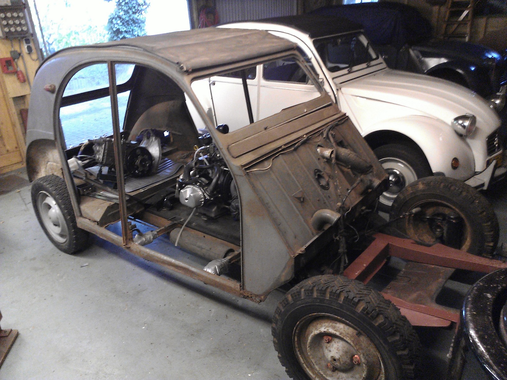

most of times though... :mrgreen:
In fact, this particular car and website inspired me to build my own 4x4.
i am building it on a 61 chassis (which is rotten underneath)
