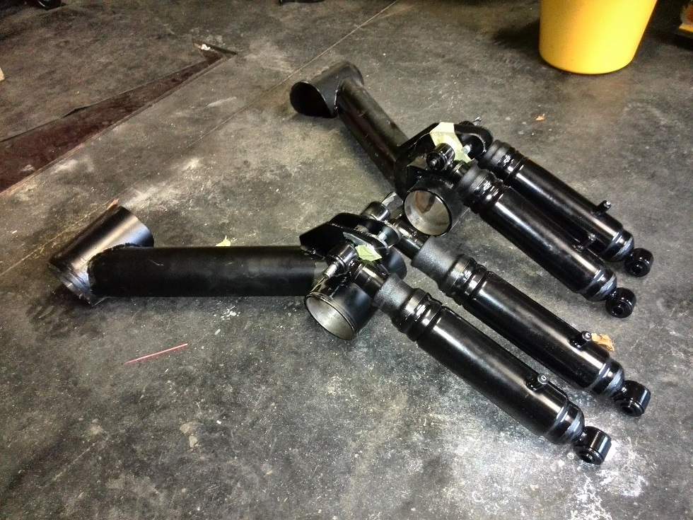

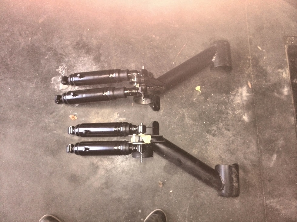

Now this rocks doesn't it.....
Barbour 4x4 rear-arms with 2 airshocks each. This is what I had in my head for over 2 years (luckely no voices) :roll: :roll: :roll:
Walking around with a bo*er looking at this... sorry....... Can't wait to see my car going up and down on air....

Post Re: A 4x4 is (re)born
Nice!
Something like 15 cm from arm pivot center to shock pivot center?
April 17th, 2014, 8:16 pm
AZS wrote:
Nice!
Spot on...... 15cm armlength 45cm, so ratio 1 to 3. Fingers crossed it will work...
I sure do help you hope it works.
It would be great to have a well working suspension/damper combination in one unit, well a bit more units in your case ;)
What's the diameter of the "bag" and the piston rod?
