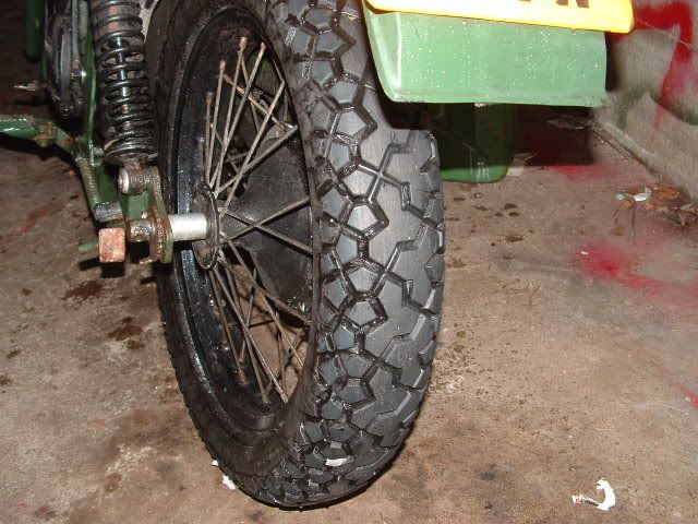

I think I'd be more inclined to go for a "squarer" section "Trials Tyre" if I was gonna down that route [by "trials" I mean those little bikes you ride over logs & barrels etc] .....Moto-X tyres are intended to be cornered [and banked over at speed] .....I dunno if Trial tyres are available in 15" size though.
Note the squarer section in the first pic [this is a semi-trials tyre I use on my "off-road" Rotax engined Armstrong MT500] .....
.....compared to the [all round use] tyre on my "road going" MT500 ....
......I might add here that I dont do trials or Moto-x .....just a gentle bit of "Greenlaning" suits me these days.
hth
