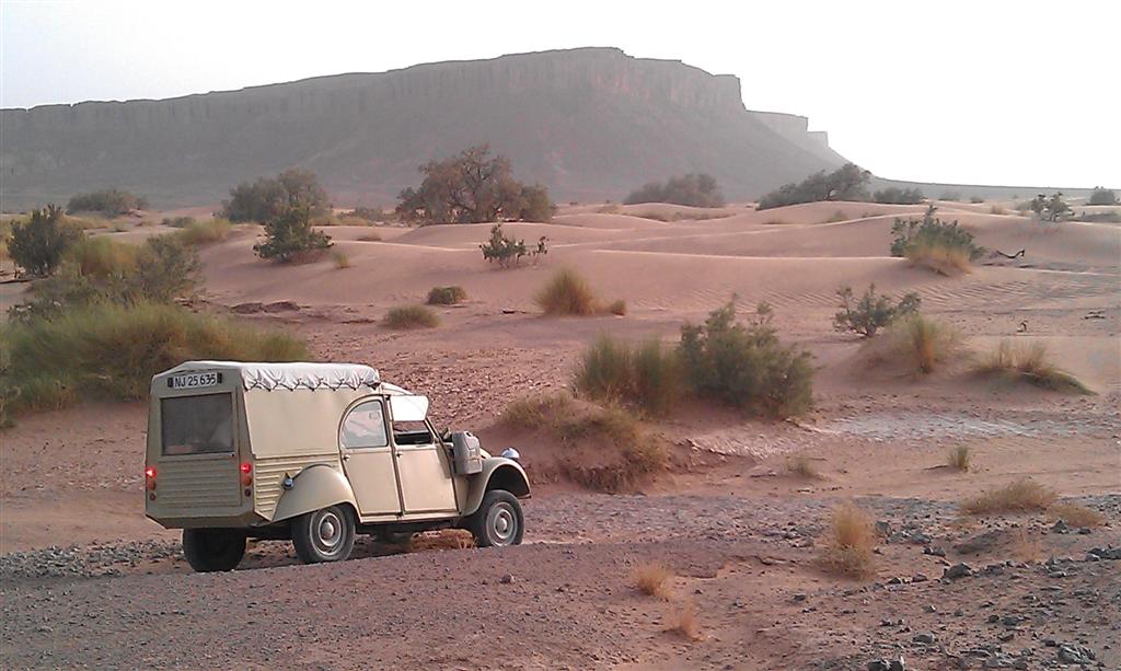

The first photo shows how it looked when I came, at low speed from rocks to sand. The car runs with my nomal pressure ( 16 psi front and 20 psi back) when entering the sand I imediately fellt the wheels digging, knowing that pressing the gaspedal will cause the car to get stuck, I just pressed the clutch.
After lowering the tyrepressure to 6-7 psi (same as the agricultural tractors with superwide tires) I just release the clutch a little bit above idle and when the cars rolls i can carefully speed it up.
The low tyre pressure means that the rolling restance is so low that it requires wery little power to get the car rolling.

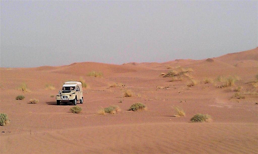

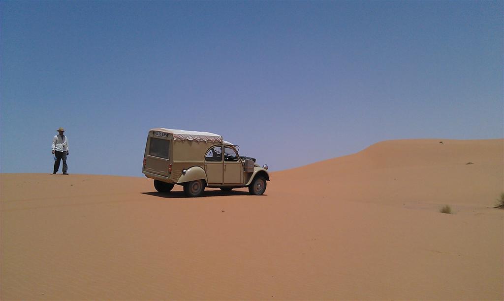

We vere driving hundreds of kilometers i sand. One trip took 4 -5 hours through deep sand with lots of dunes (1st and 2nd gear) following a track from Wiki-logs, oploaded by a couple of Land-Rover drivers, who had marked it as difficult.
I am not going to say that it was easy. We vere both deeply concentrated in reading the shape of the following dunes. When you are alone out there and the temperature is 54 Deg.C, the water reserves are limited, then it is no fun when the front wheels lift from the sand when passing dunes, being aware at one hand the danger of bending the chassis and on the other hand keeping the speed so that you dont find your self at low speed in the hole between to dunes.

File comment: Lock at the track behind the wheel first it has been digging at 16 psi then comes the fine pattern at the surface when the car powers itself up after lowering the tyrepressure to 7 psi.
Also notice how little compressed theese wide tyres are.

File comment: In the background an example of dunes we were driving through.

File comment: Up high in the dunes
