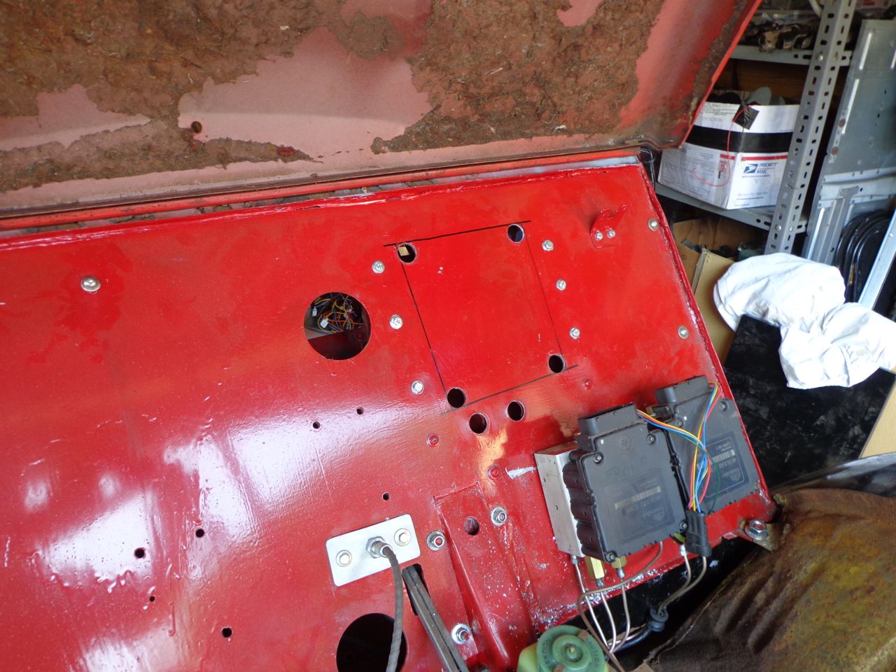

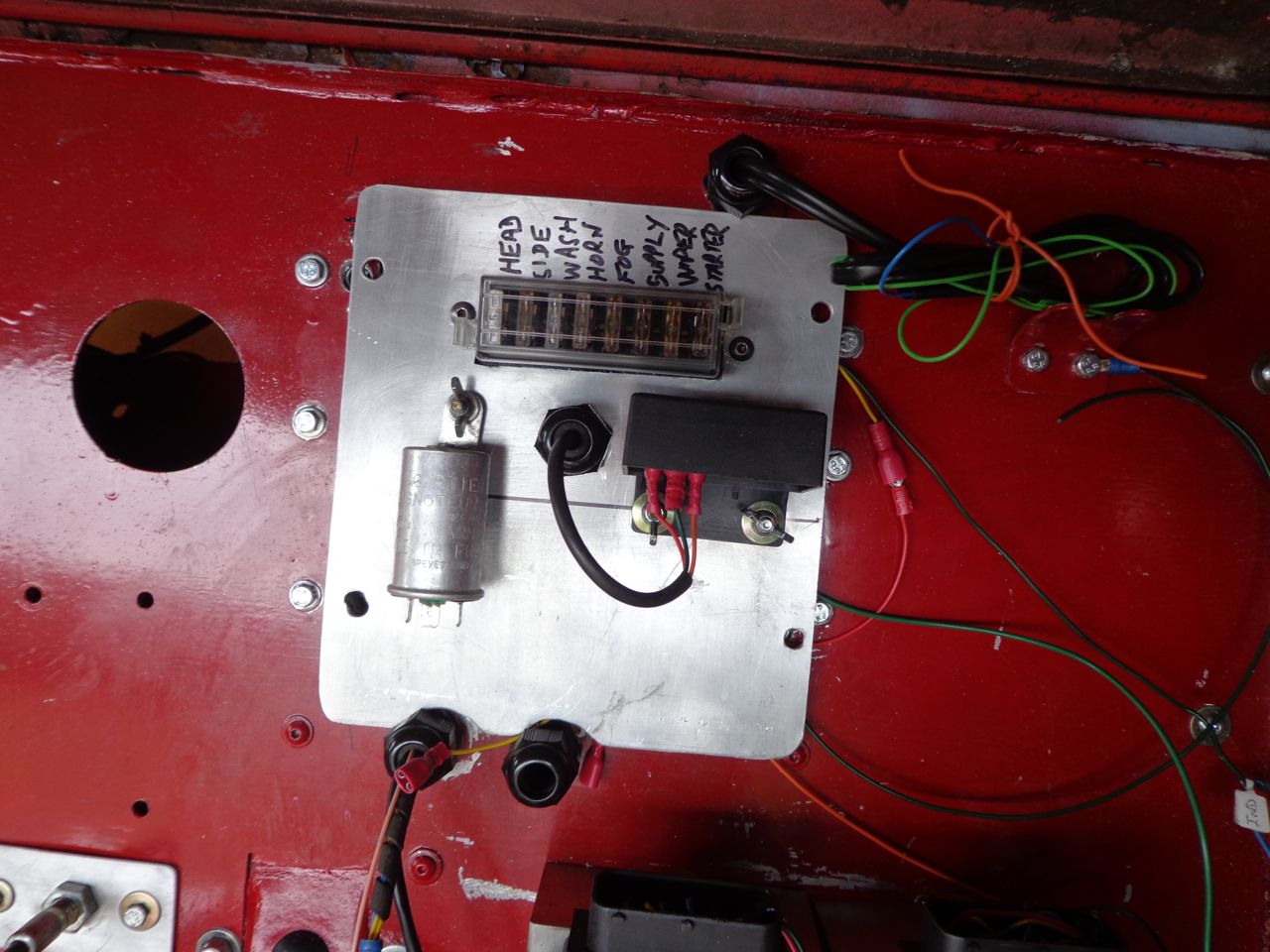

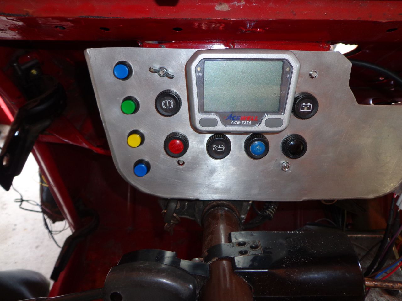

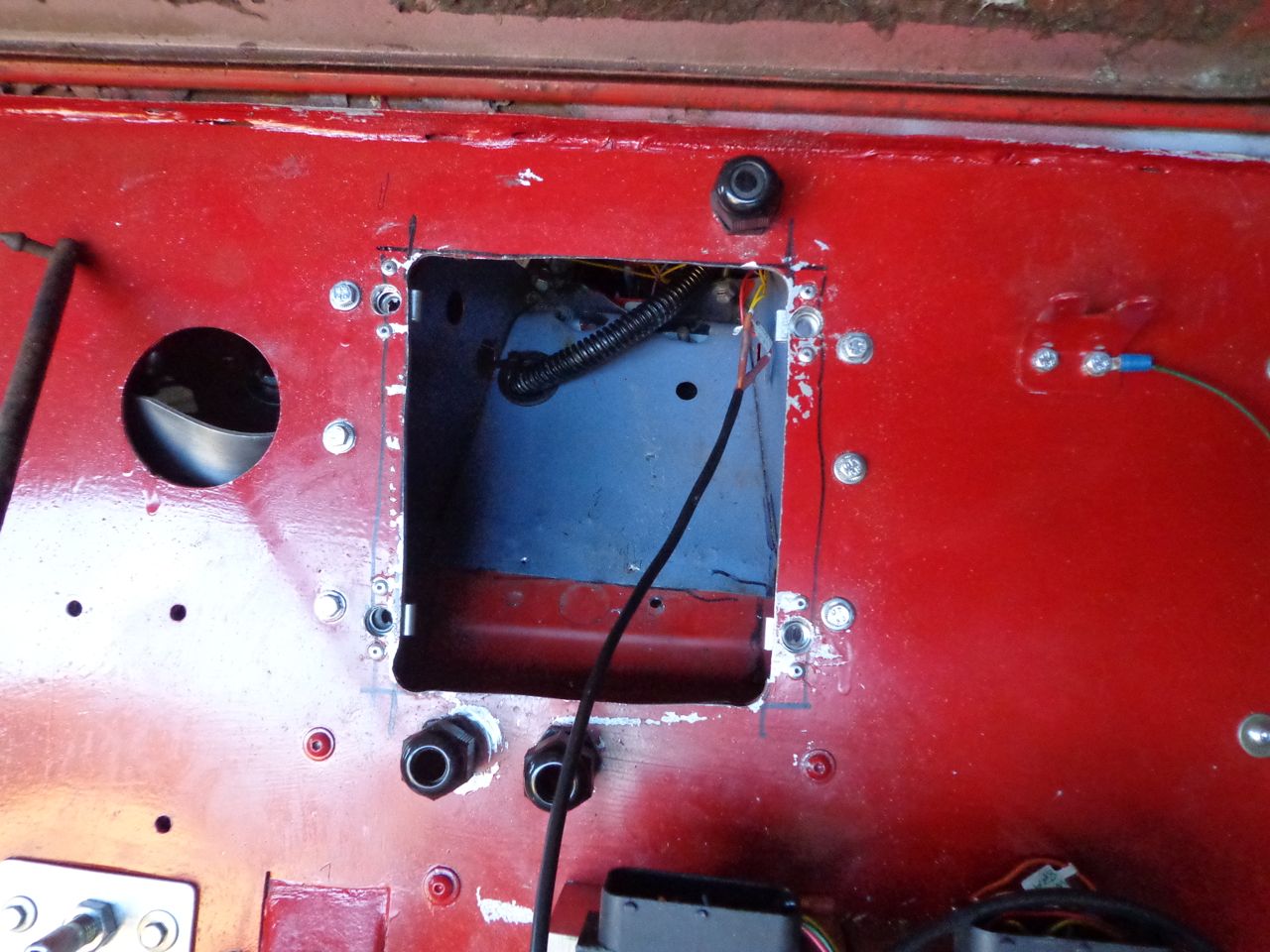

WIP on Dashboard and Wiring

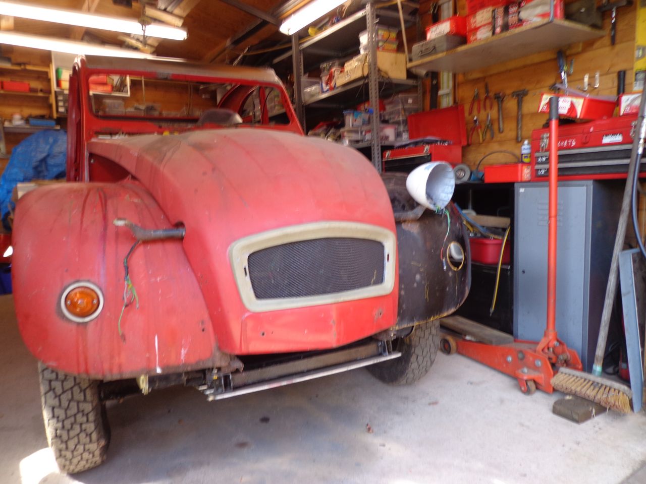

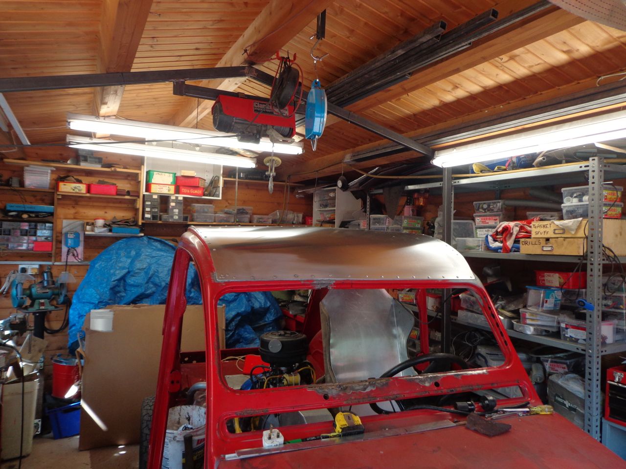

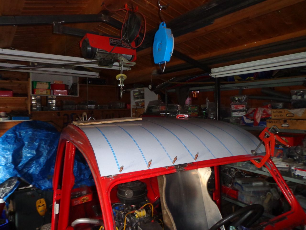

Roof and Grill
Broken Plastic Grill fixed with mesh from an old fireguard, Chevrons to be added

Posts: 816
Looks so good pete!
Is it alloy or steel roof?
Why is it you made a ridge roof? Aesthetic, to make the body more rigid, just interested, I think it looks the tits!
Harley
August 17th, 2013, 10:08 am
Online
Posts: 2258
Had to cut the roof bar and the top of the windscreen to give more width for the door catches.
See viewtopic.php?f=19&t=3279&start=140.
Roof is alu, lighter and very easy to work with,.
When all the rivets are in its more rigid

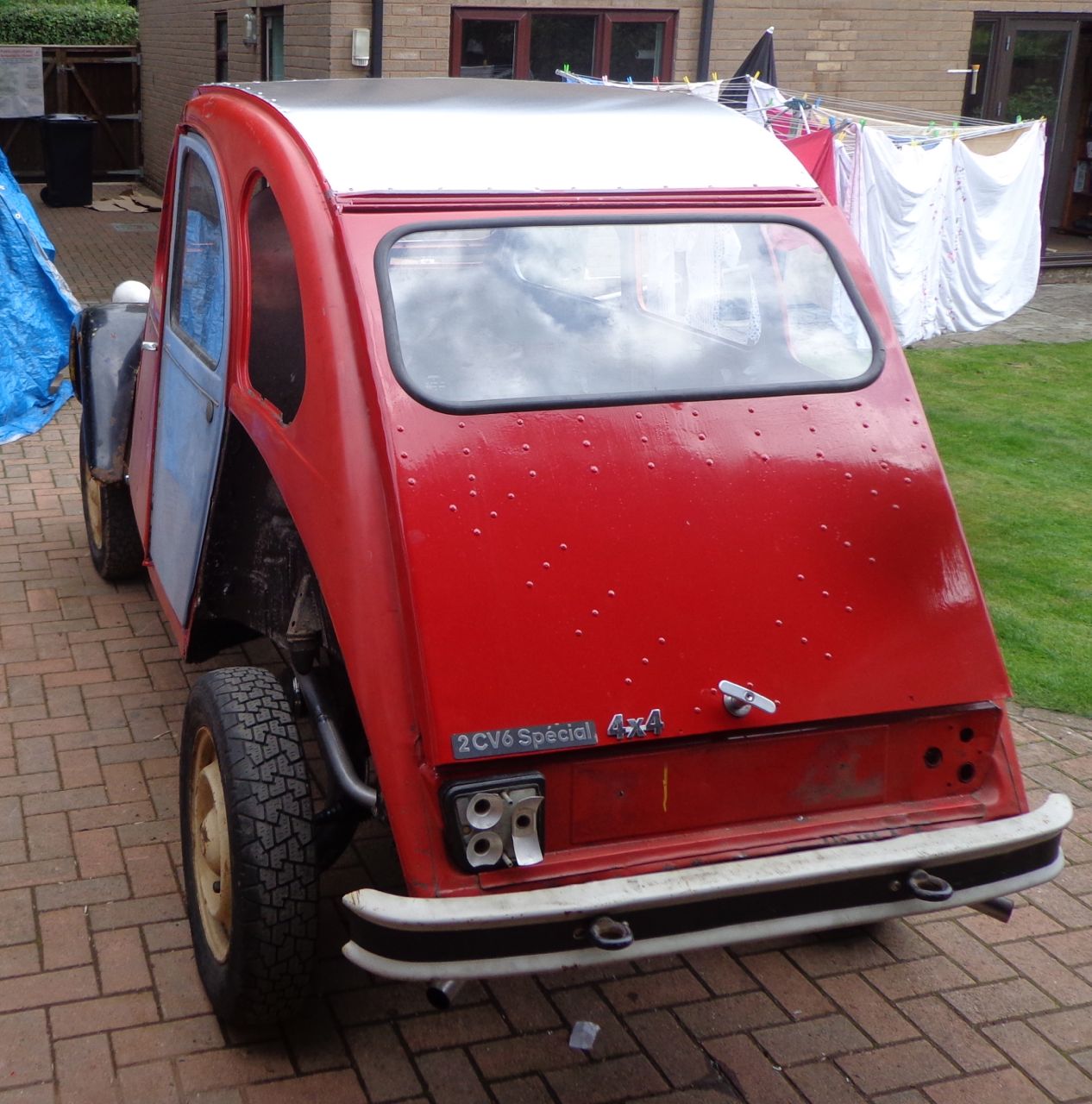

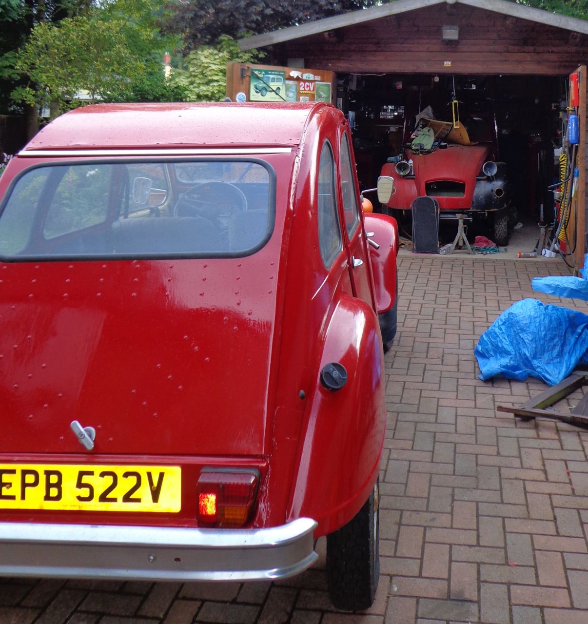

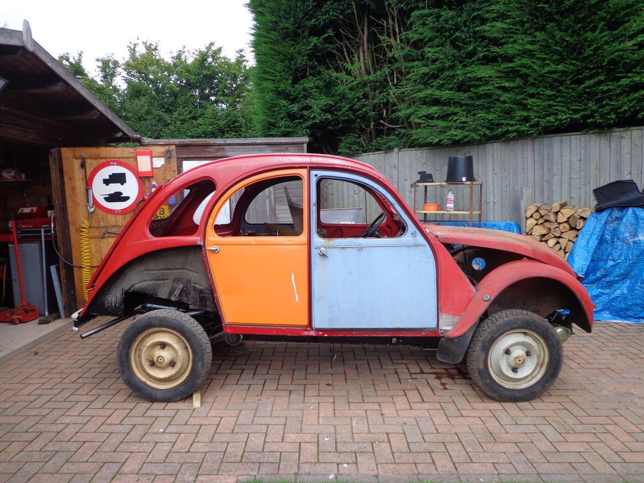

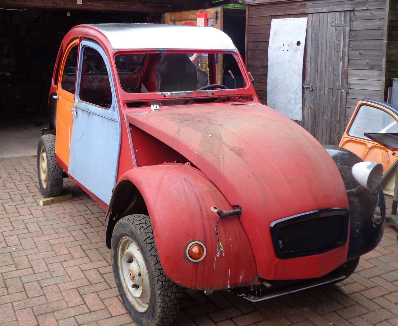

Looking tike a 2CV?
