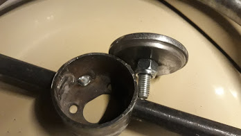

dash all back in an nearly finished wiring.......Got my steering wheel cap done today.
Started with a rough cut from some scrap 10mm plate.
Tickle with the grinder and add something for lathe mounting
My mates dad then added a step to fit boss using his 60yr old churchhill lathe. Then then I mounted in my drill, and added some shape with a 40grit flapwheel in the grinder...

Good results, like it.

:) nice
