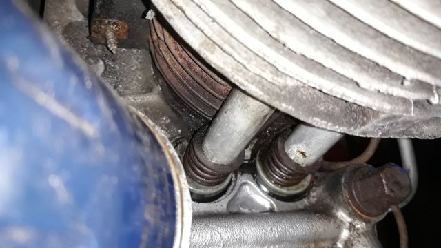

Well.......stripped a million fixings from all of the front shroud and the bottom cylinder cowling so I could check the oil feed and the pushrod tubes.....
Oil feeds all dry if a little rusty. Cleaned up all of the residual mess and fired the engine up. The problem was immediately apparent, a holed pushrod tube :(
Some reading in the forums suggest a number of options:
1 replacement
2 aluminium welding/brazing rods
3 Chemical metal
4 Rubber patch and jubilee clip
Since first two options involve head removal, I think I'm going to go with either 3 or 4 for the moment so that I can get the van on the road for the remainder of the summer and tackle the head in the winter.....
Any preferences for option 3 or 4 ??
