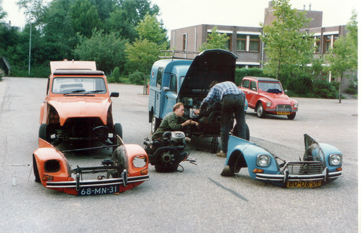

Rob you loosened to many screws on the Dyane. There is a trick but you have to be with two persons. After disconnecting several bits you can take the complete nose off. Here you can see Geo and me doing a transplant on a acadyane.
