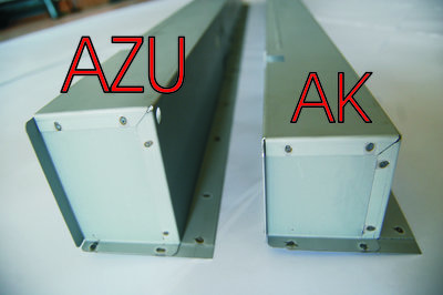

Peter... AZU has shorter chassis so back crossmember is higher than AK...

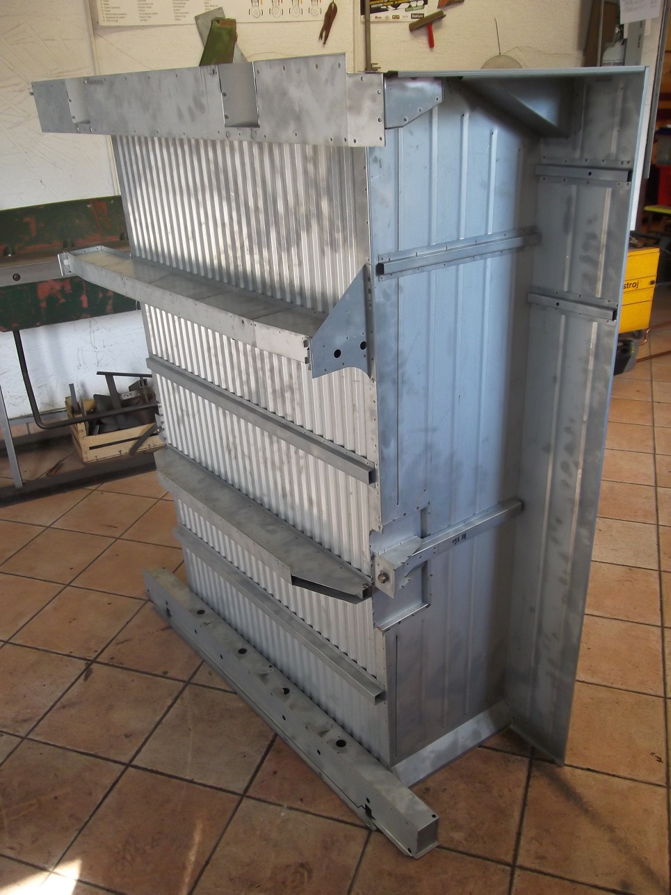

rob massey55 ... I just looked at your van pictures there at Flickr... "crist" ... looks like big job at that AZU ... :)
For cars like this I produce and assembly complete back bed ... It is AK350 on photo but I do assembly AZU, 250 and Acadiane sets as well...
Ask Roy ECAS for some more AZU panels... like 2. and 3. crossmember, side B post panels and inner wings. It will be easyer for you to rebuild this AZU completly with my panels...
AK350 izdelki 2015 proba sestava varjenje (20) m.jpg [ 439.41 KiB | Viewed 146183 times ]
