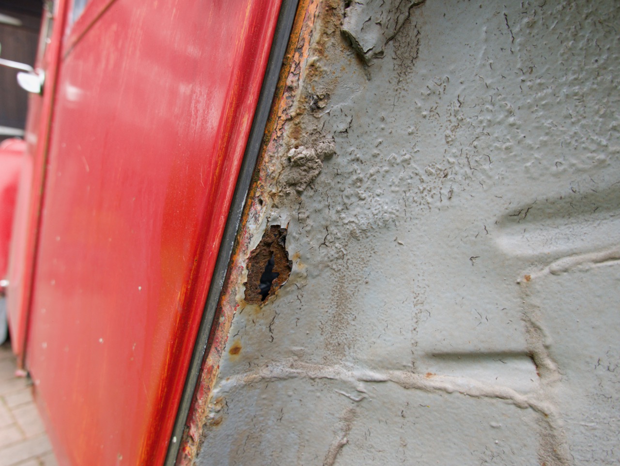

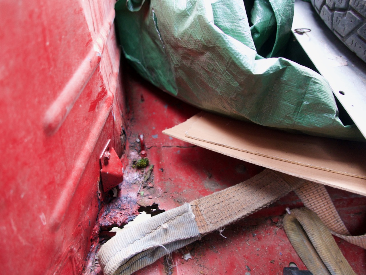

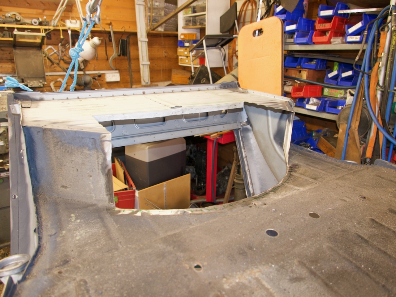

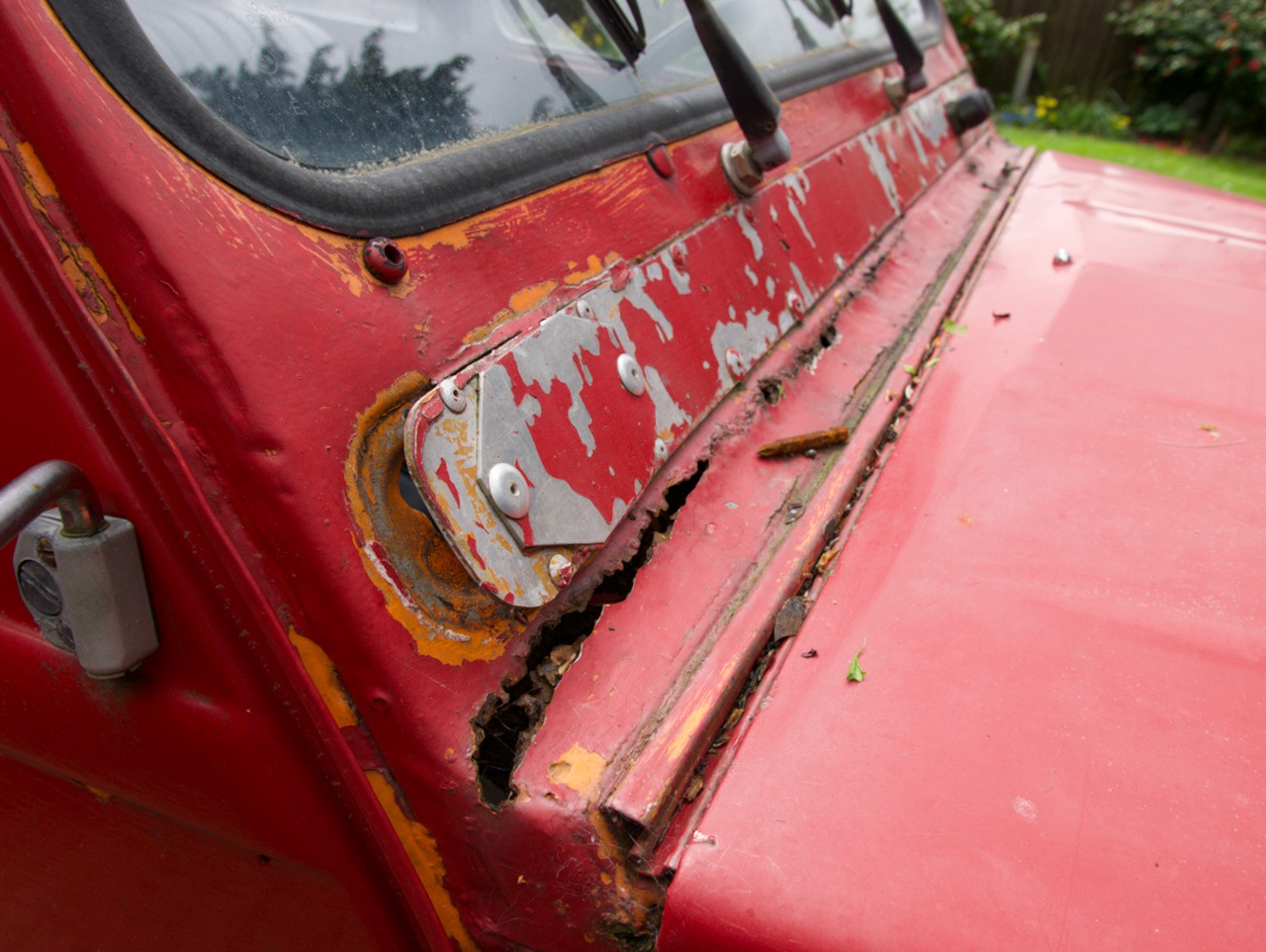

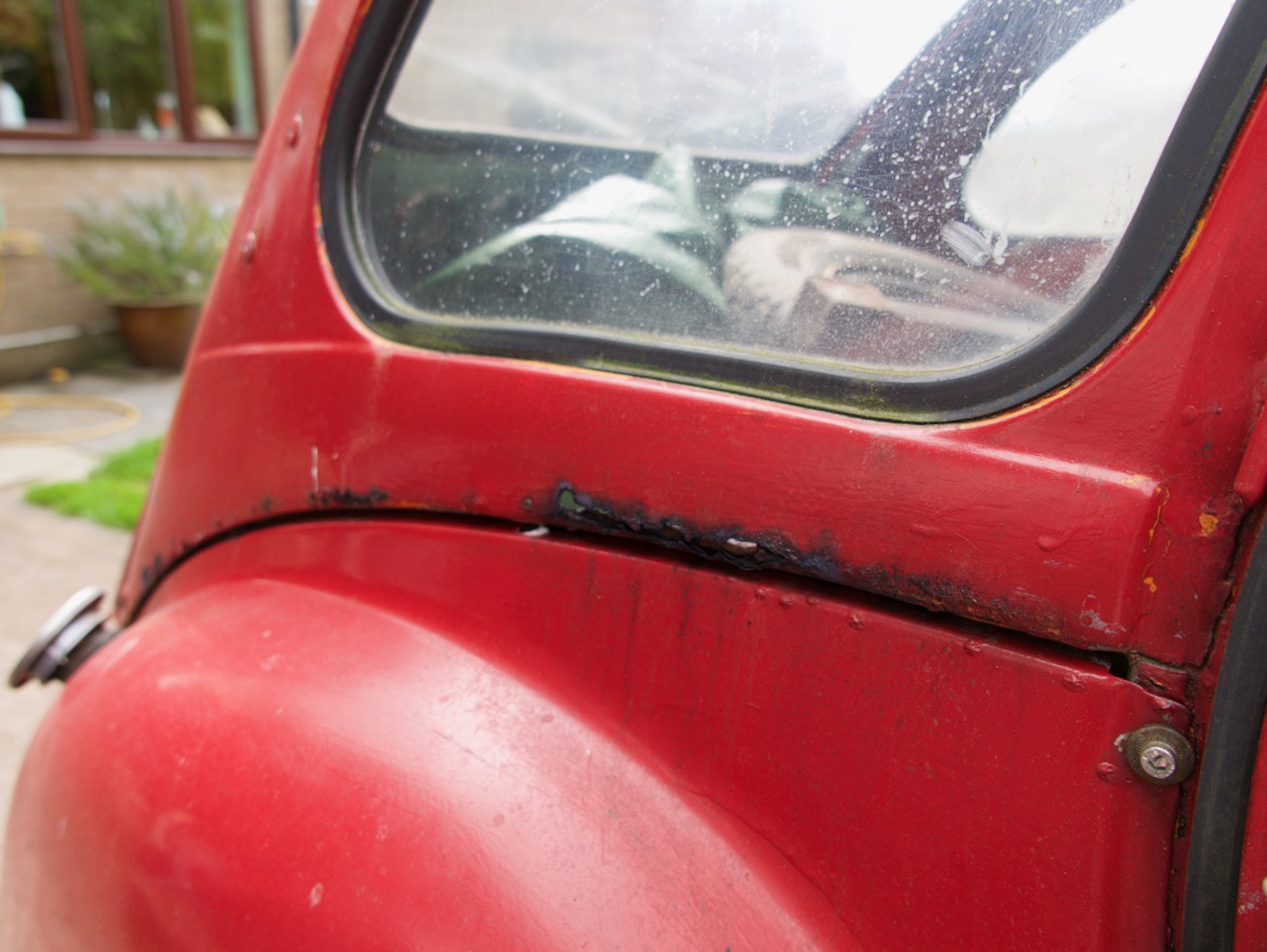

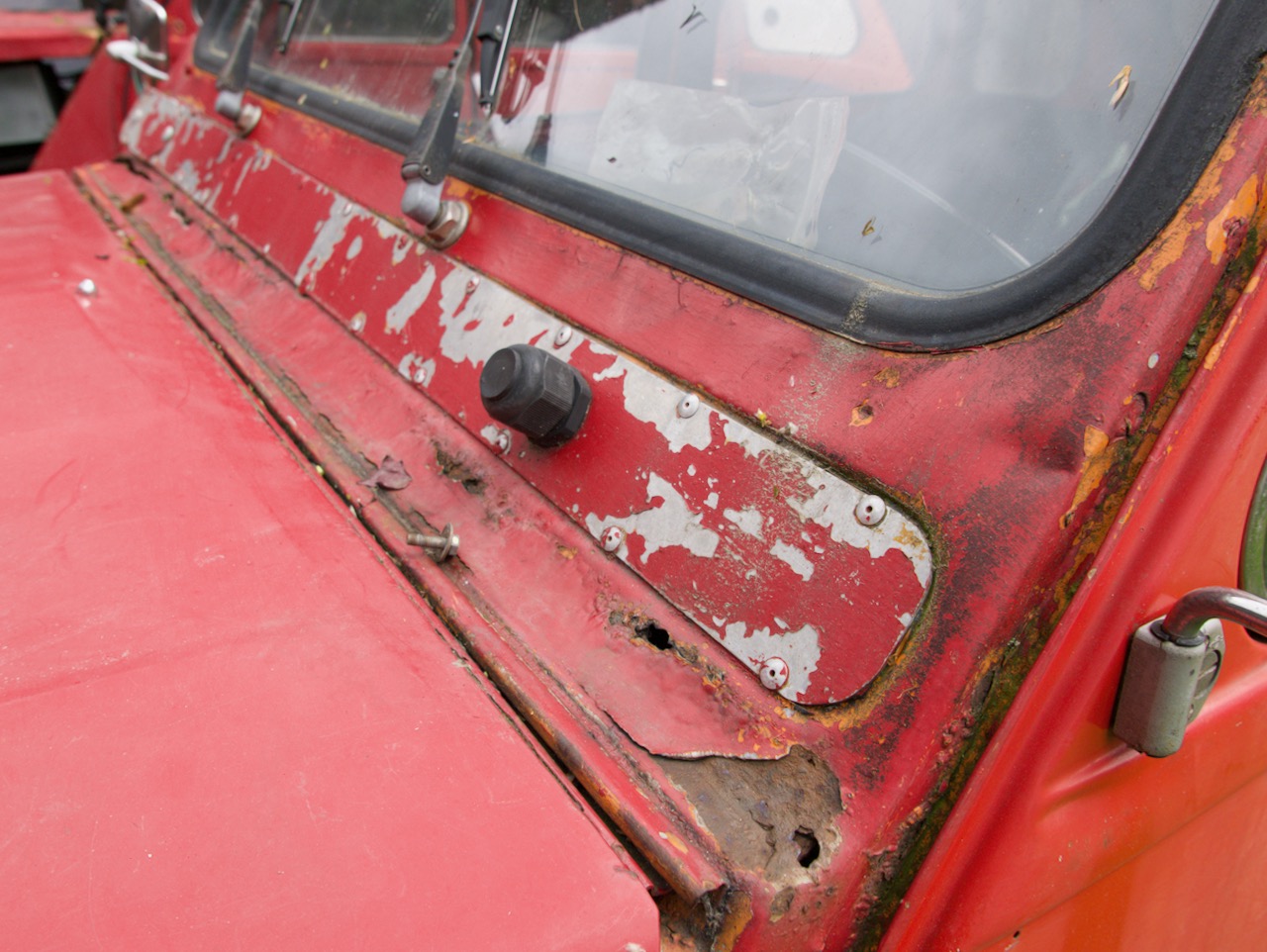

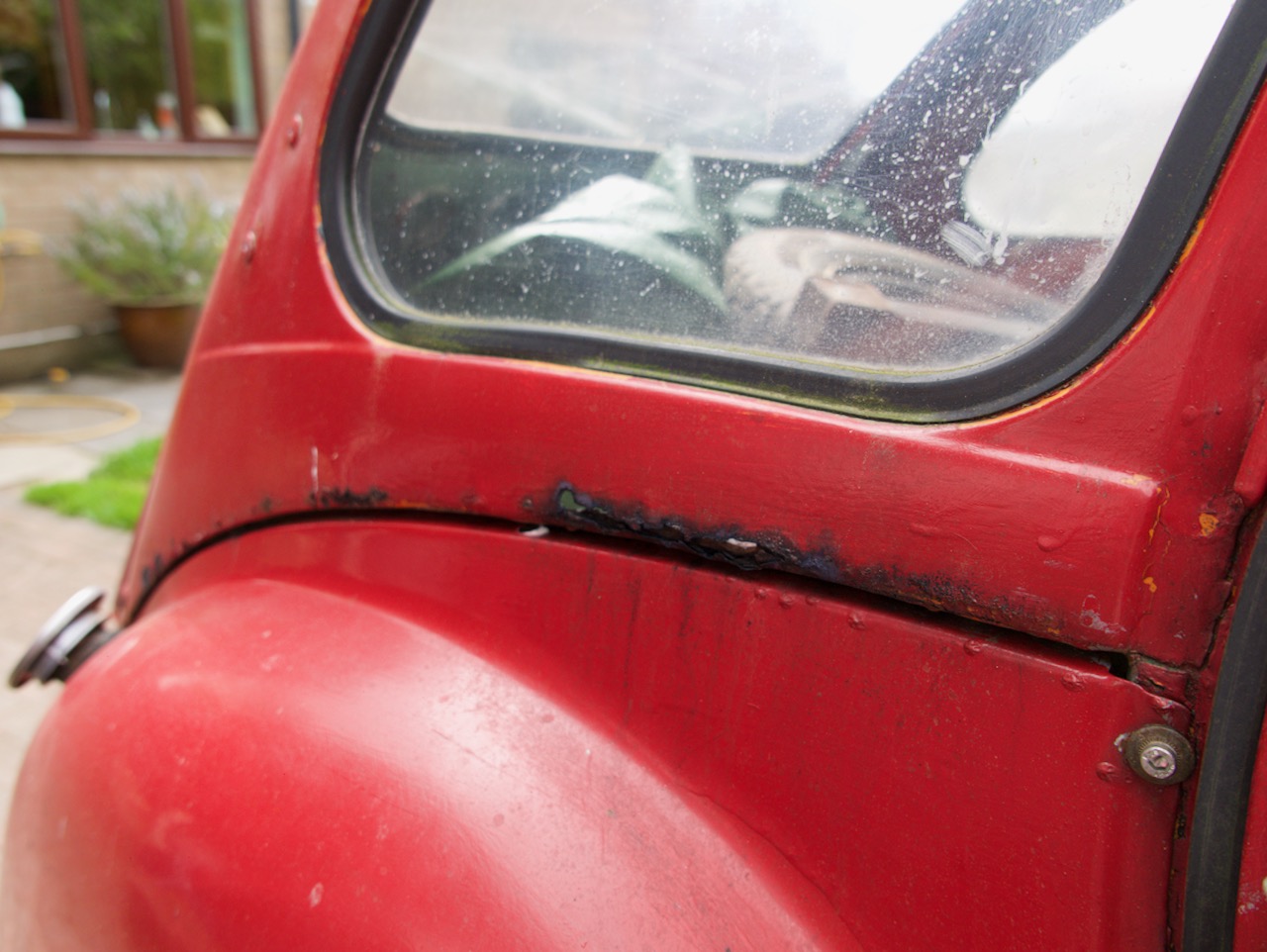

Got myself a refurb body shell as the current item is very tired.
Now to cut a big hole in the lower bulkhead for the prop shaft :)
Old Body Shell....
Low bulkhead and boot and the following.

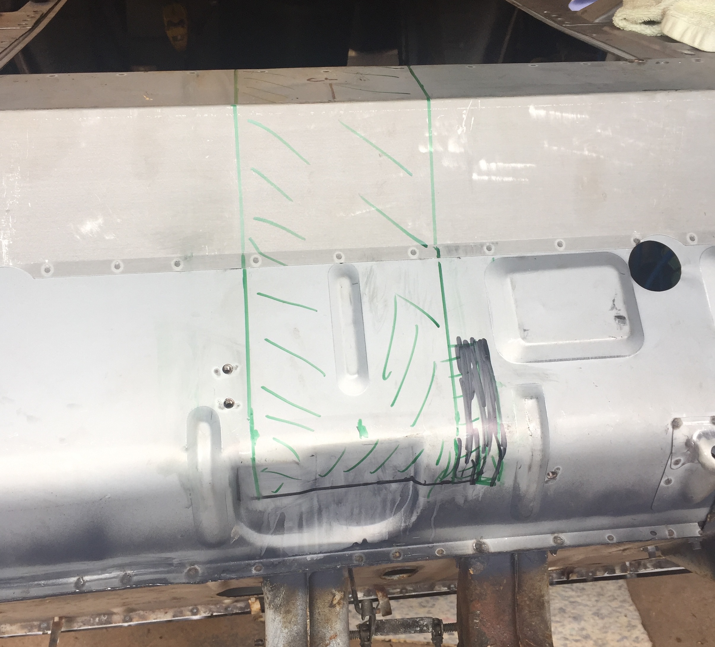

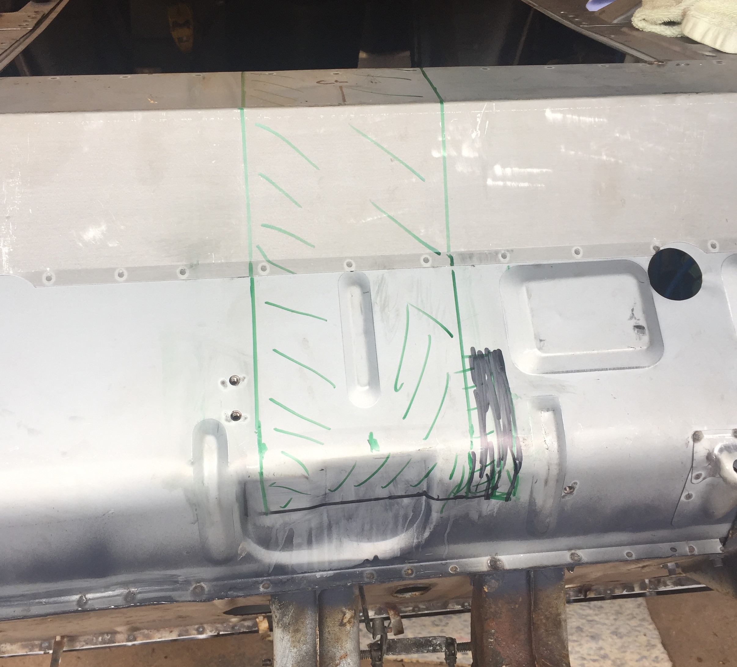

Markout the GOOD metal to be removed...:)

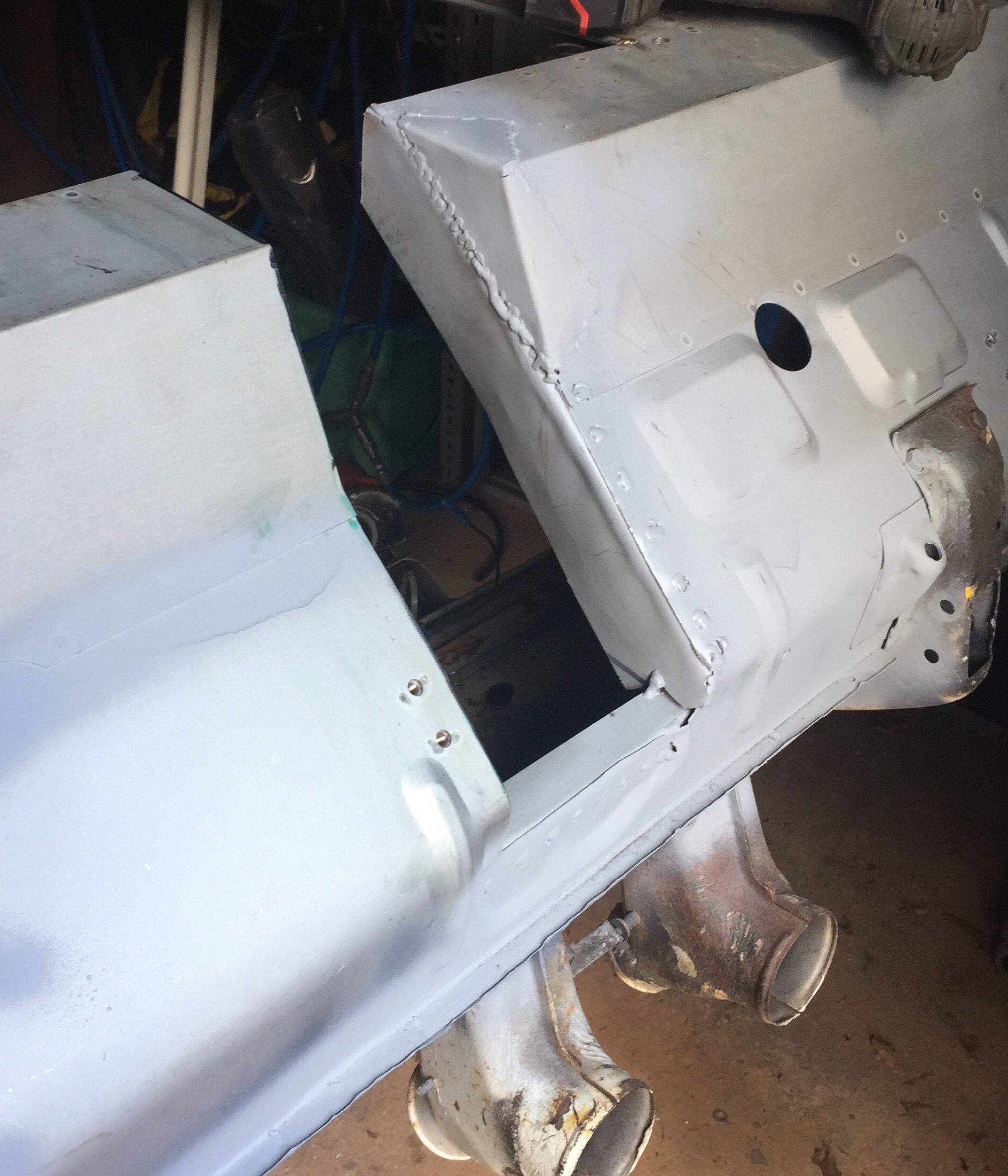

Added some good Zintec to the hole with some average welds

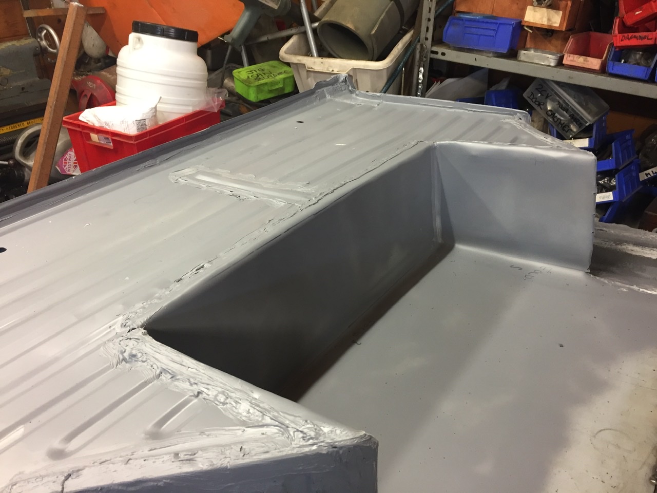

Yet another large hole, this time in the boot.

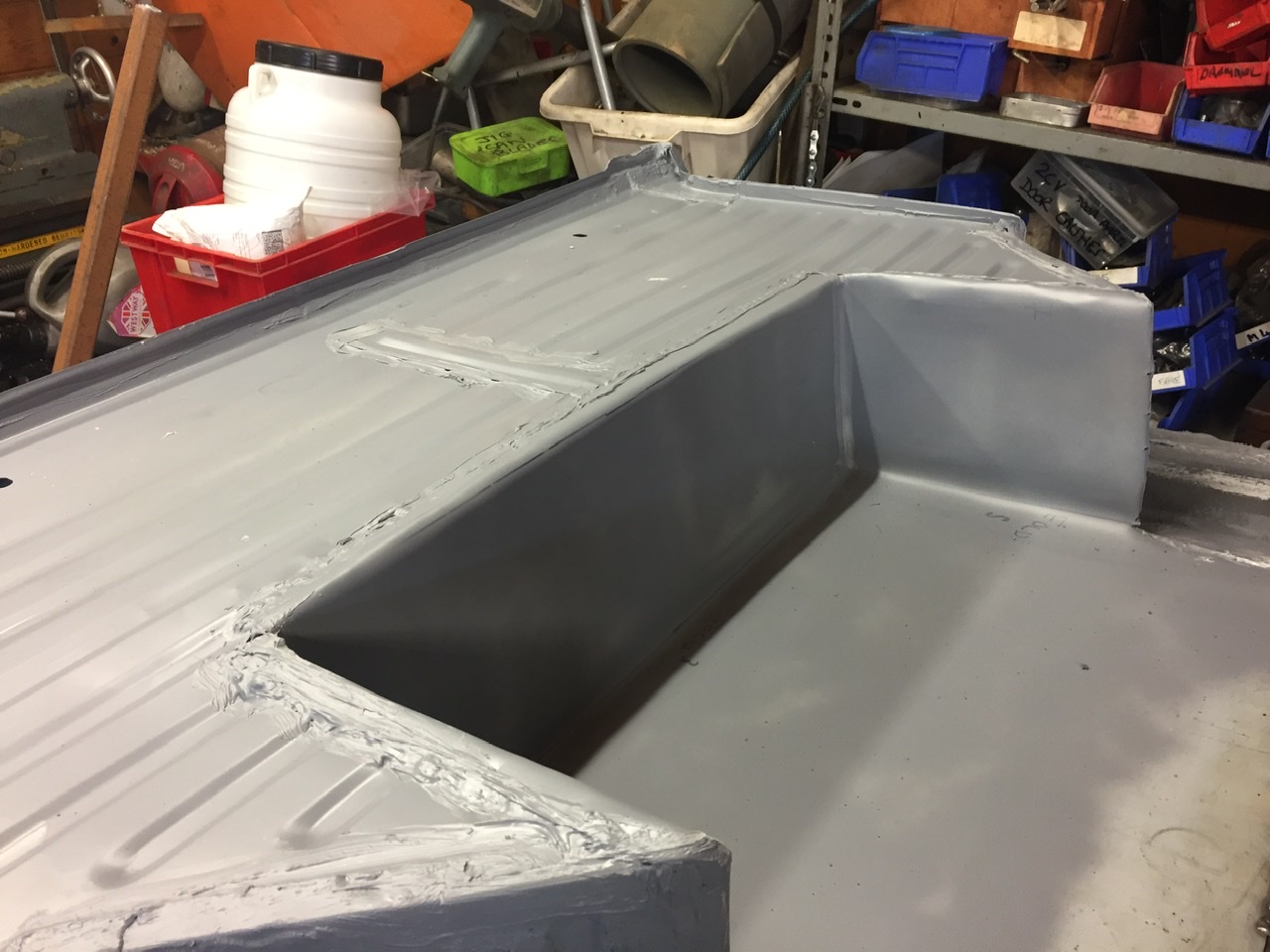

Covered with Primer and Seam Sealer looks reasonable :)
Added a kg or Two as the metal is 1.5mm where as the original is 1.2mm or less.
