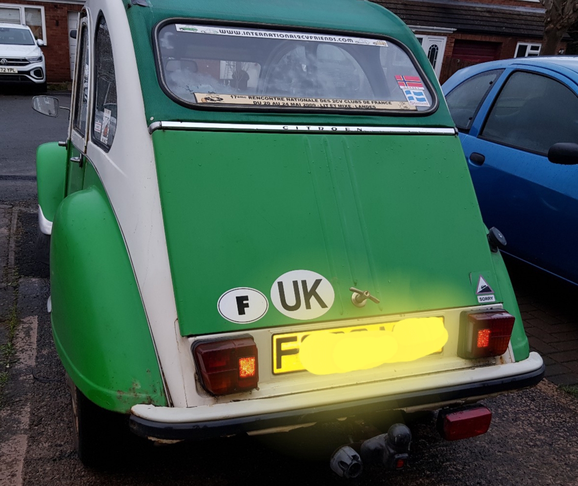

Test photo
Edit:- That worked
December 28th, 2022, 5:15 pm
