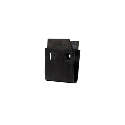

Before spraying the body, we put it together for the test. Now we come across a small problem.
How is that little clamp on the back of the rear mudguards fixed ? We tried to fix it,but we can't get it fixed properly .
March 5th, 2024, 8:12 am
Posts: 2278
Post Re: �1965 2CV AZ
It normally is hammered on from the bottom. Think of fitting the aluminum lining between wing and body first.
Here an interesting catalogue for you with also the later 18HP models
http://jplerouge.free.fr/2cv/2cv%201949-68.pdf
