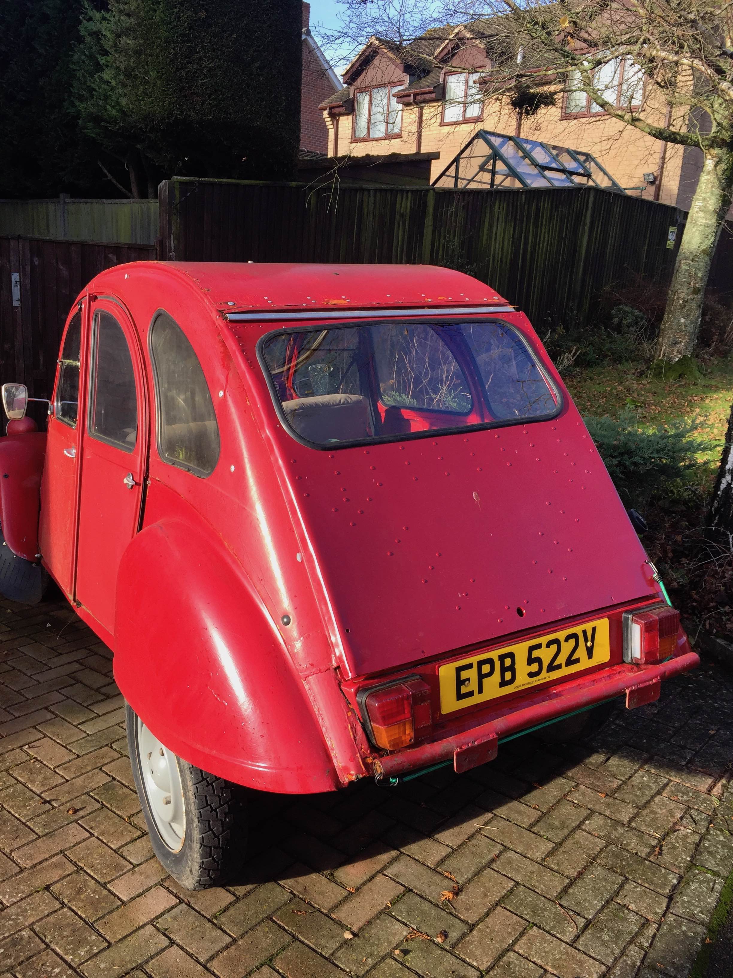

Respray? of tail gate, reinforced hinge area, new window from Acrylic sheet, previous one is somewhere on the Autoroute near Reims :o ?

Post Re: My 2cv
love the rear sweeps :lol:

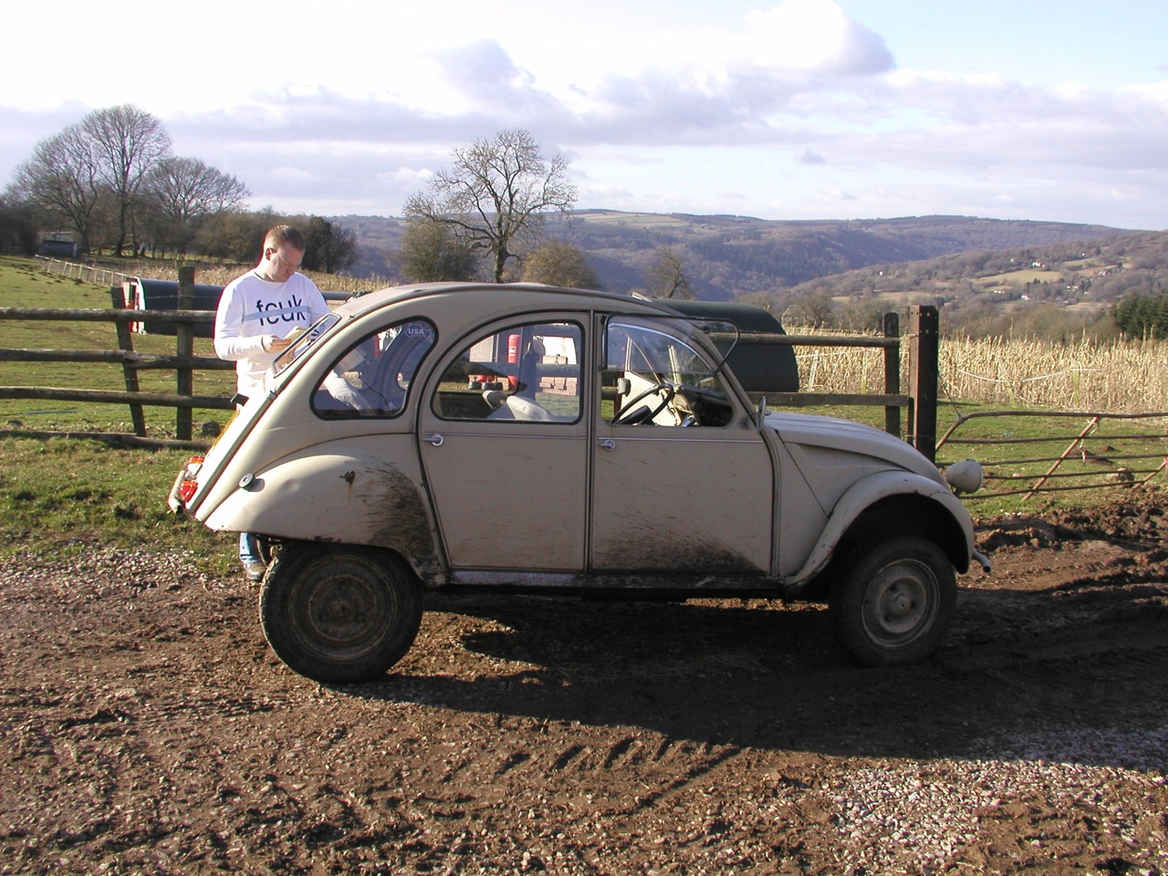

Post Re: My 2cv
Was previously chopped off had it welded back on by LB :(
As it was In 2006
