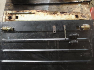

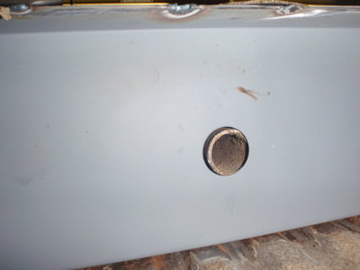

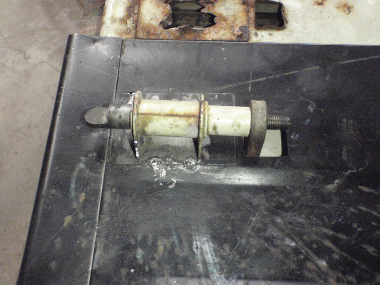

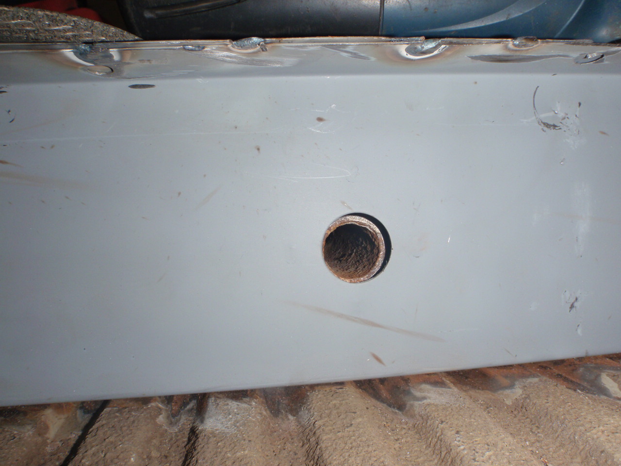

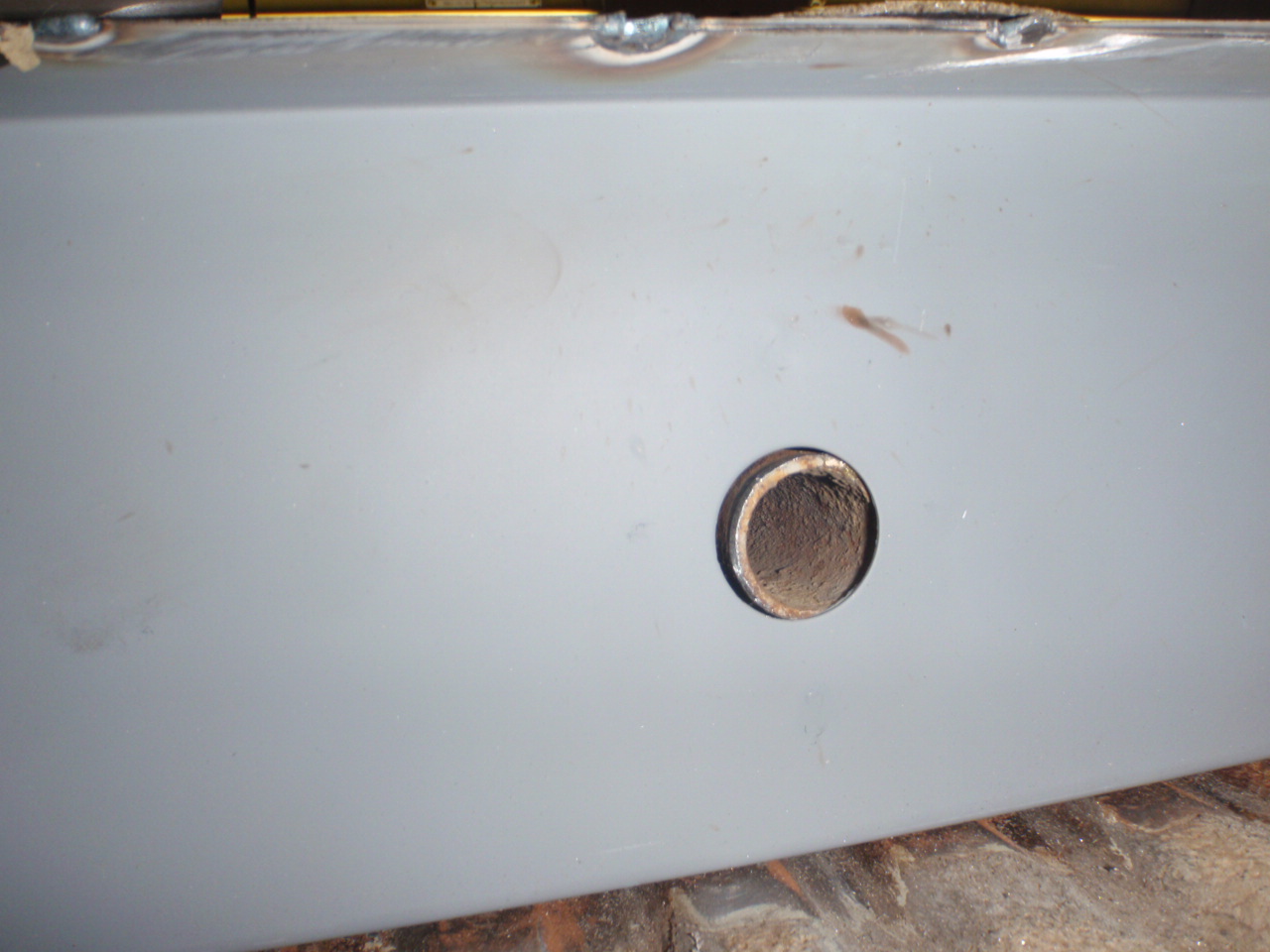

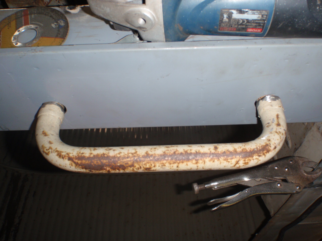

Did some adjustments today and bit of welding (gasless juhu)

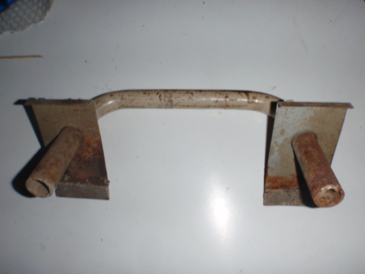

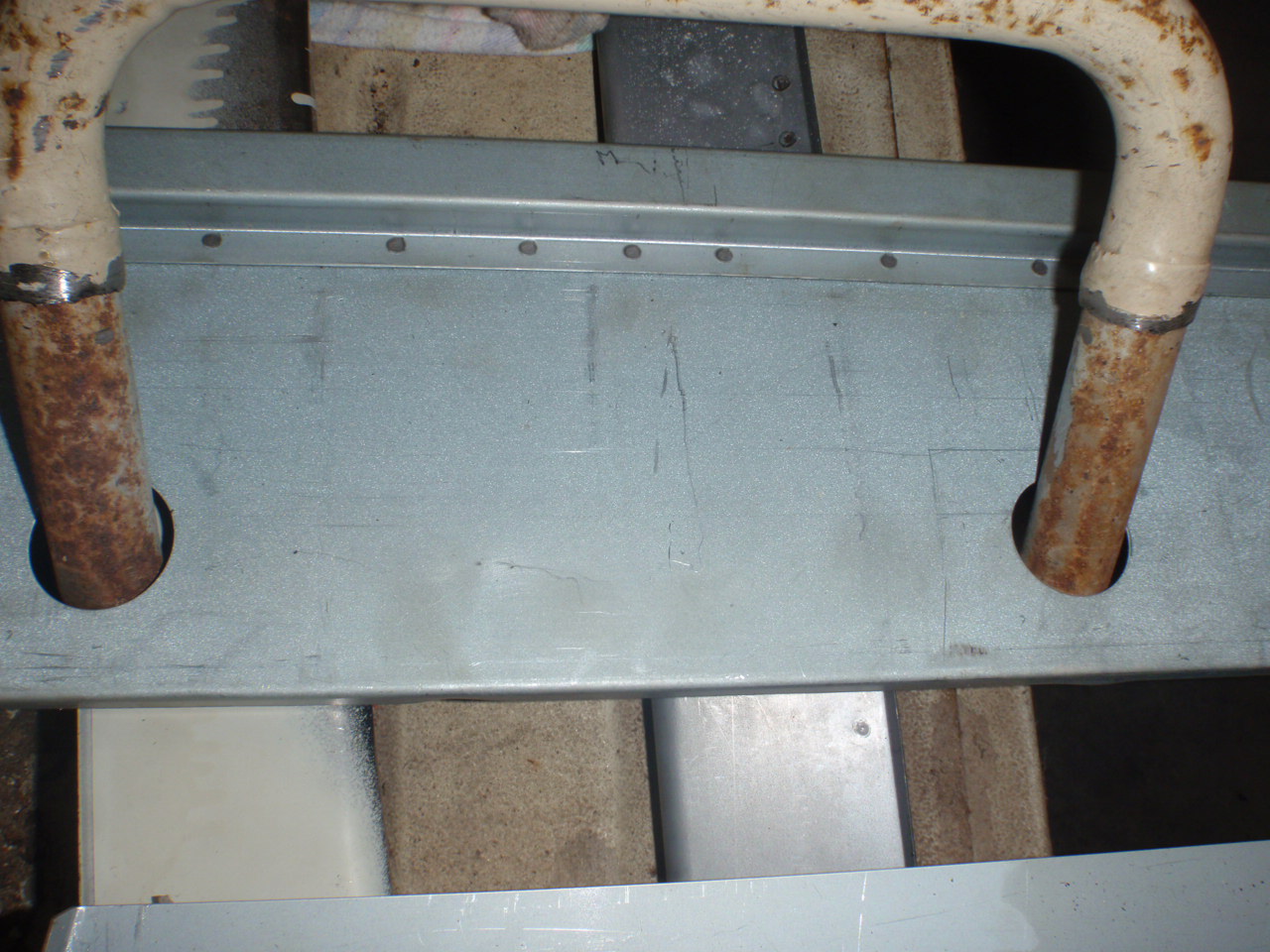

Janez small correction for the bumper holes. I gave you 250.5 mm between the tubes, should have been 255.0 measured from center to center.
Used a file and problem solved in a flash, no worries.

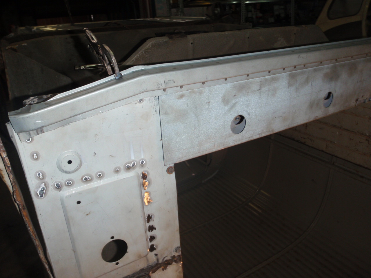

The AK 400 panel is the same except holes are bigger.
AK 400 panel

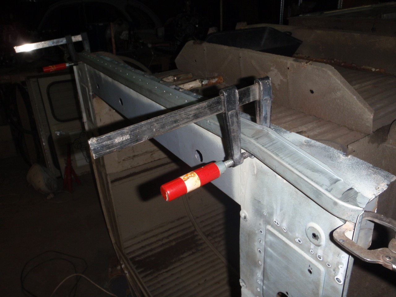

Lining the panels up is good fun, when things fit.

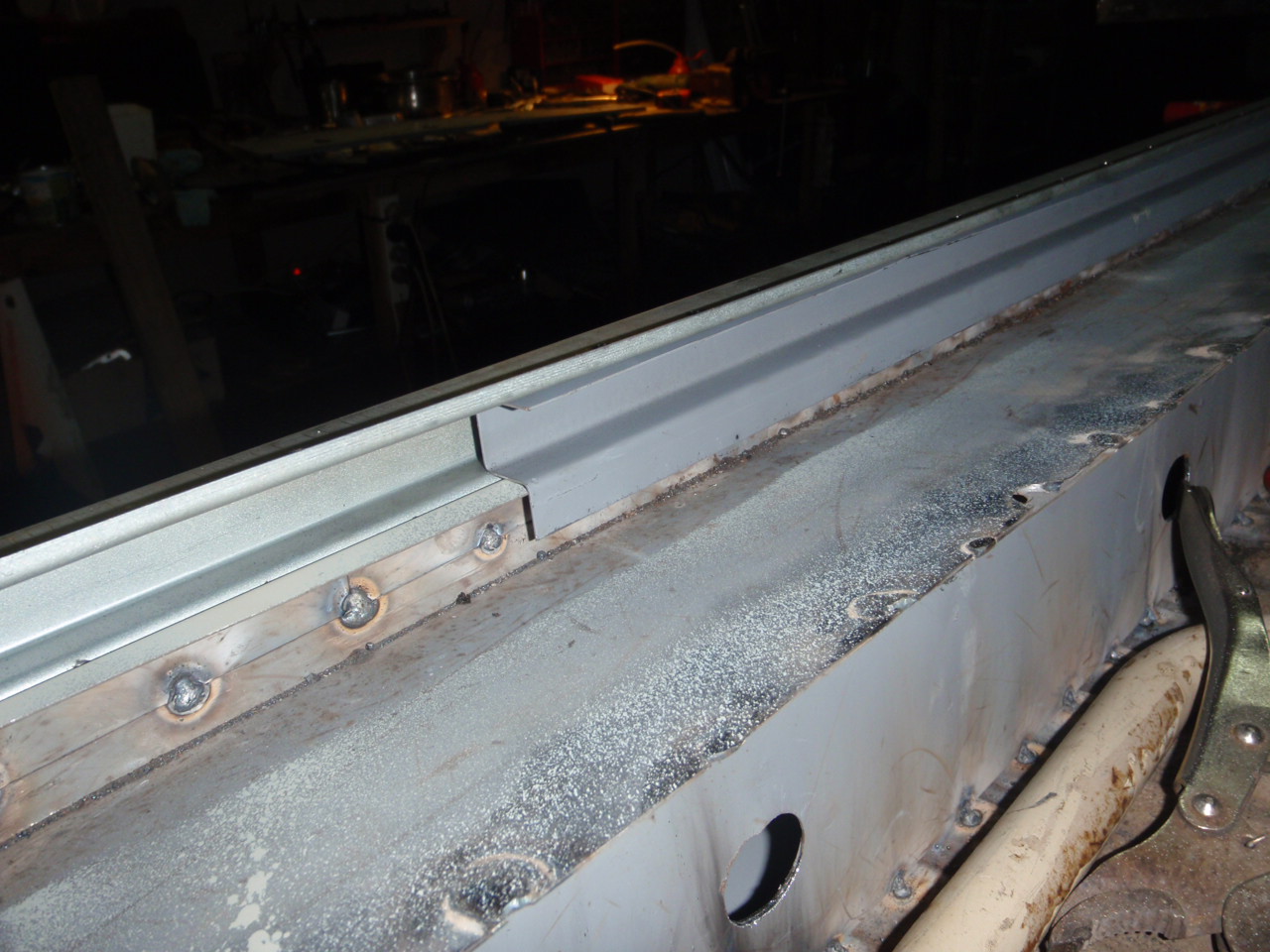

One thing I missed was the back panel between the cross box and the rear vertical panel but easy done.
Looking forward to spring, only 2 degrees in the garage. IT IS F......G COLD.

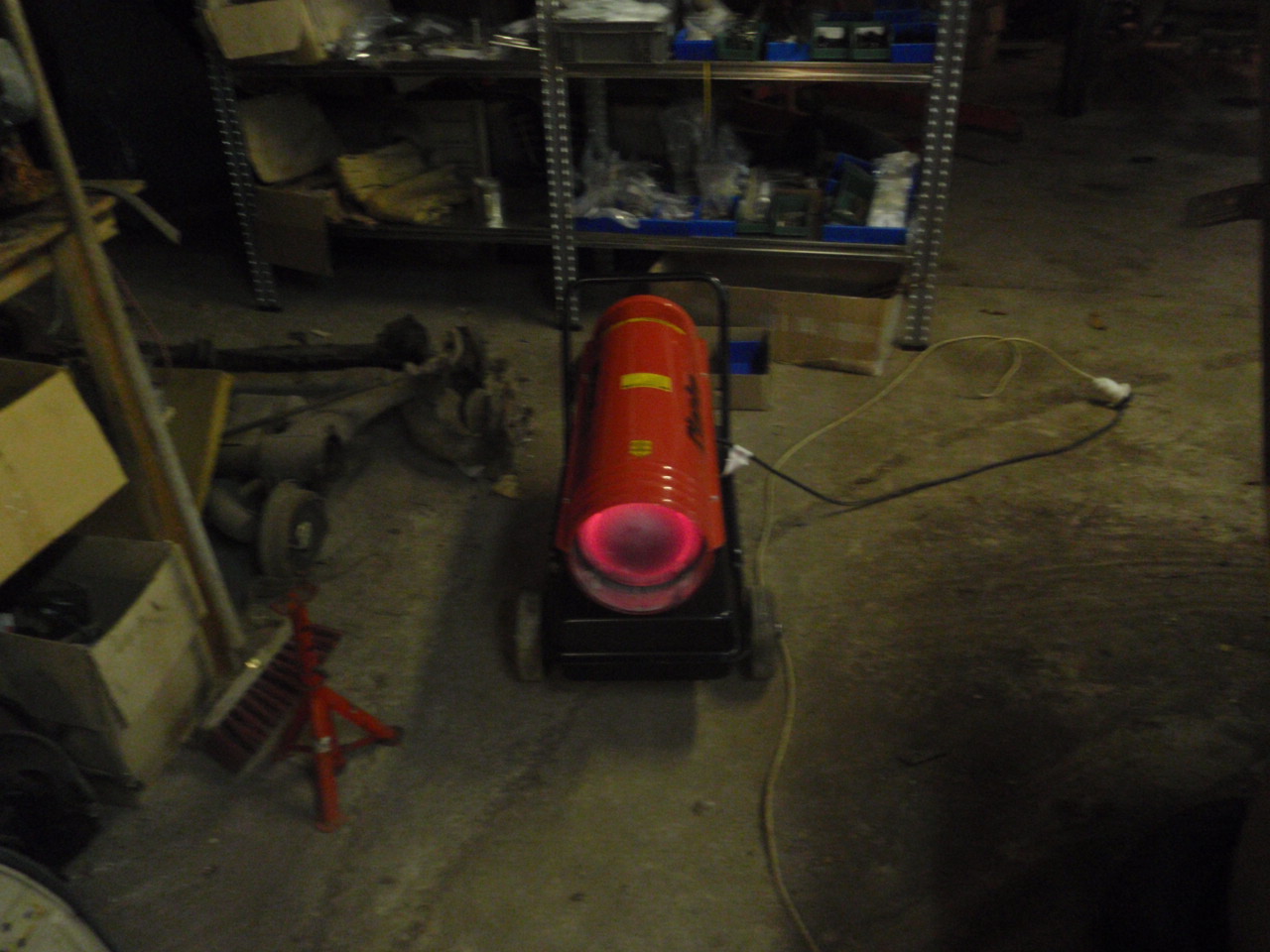

An UK fellow (local) want to sell me this thing. Lovely to work in front of but move 1 meter away sideway and you don't feel the heat at all. Can't decide to buy it or let it go...!!!
Buy two (or three!) - or move to Australia :lol:

Those space heaters are pretty good at throwing some heat into a big space. Unfortunately they also create an awful lot of moisture while doing so because they exhaust into the workspace.
I used to have a wood burning pot bellied stove in the workshop. If you have a ready source of scrap wood it is a brilliant way of heating the workshop. And there were bacon sarnies for lunch........

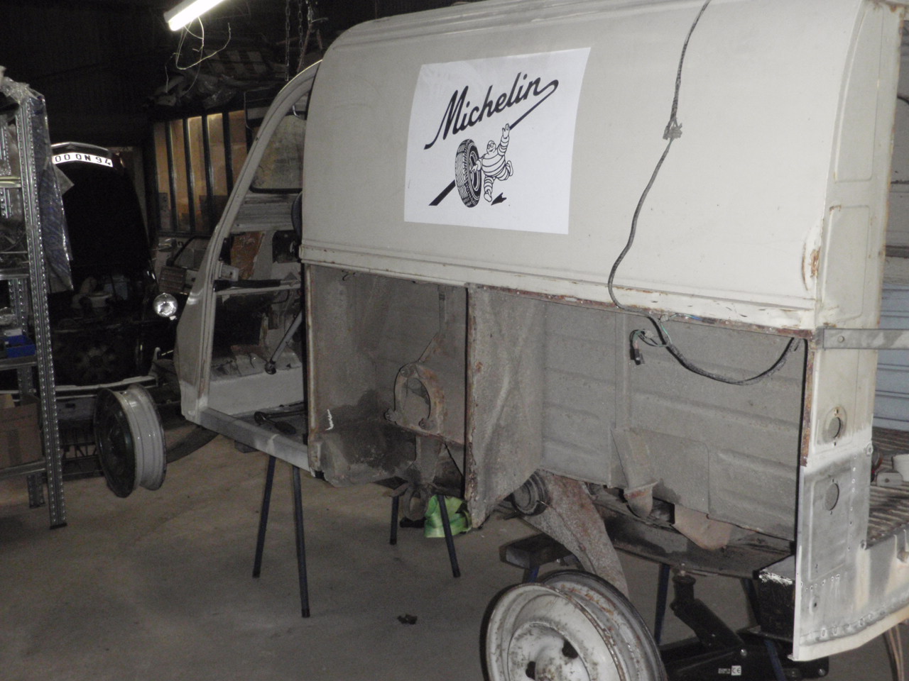

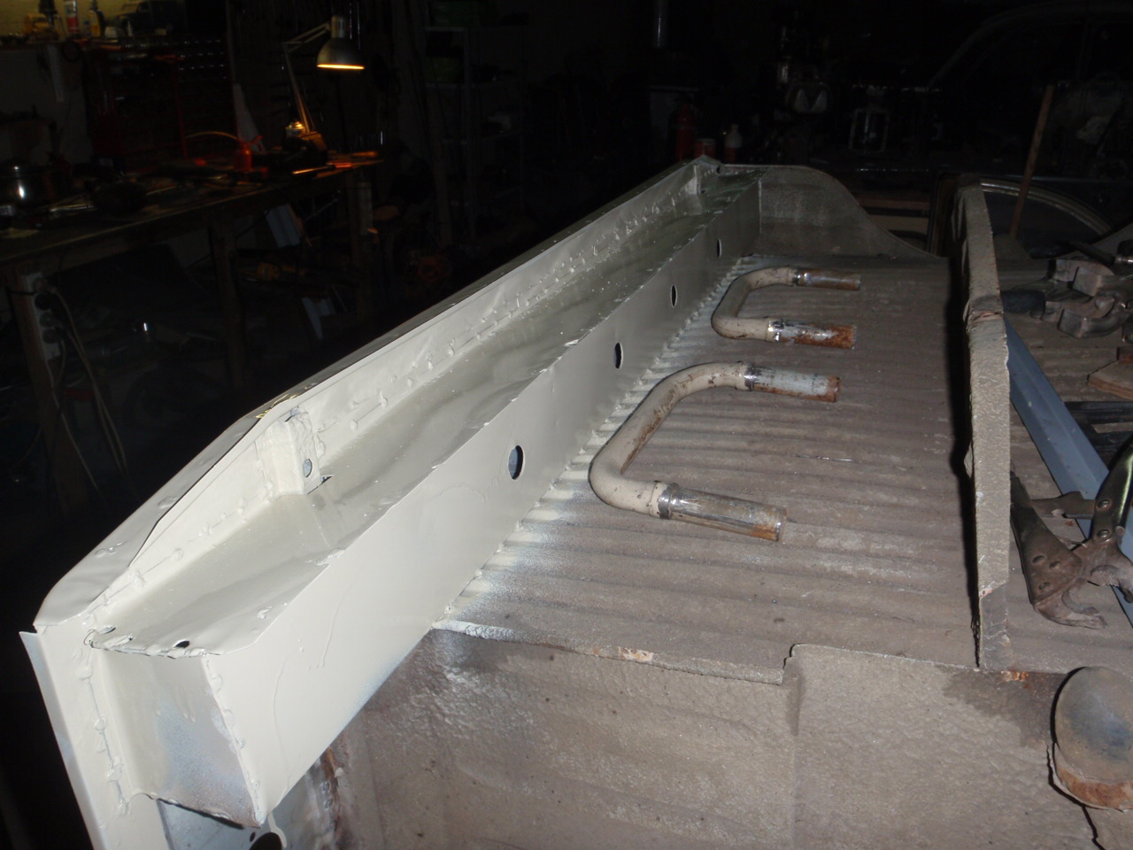

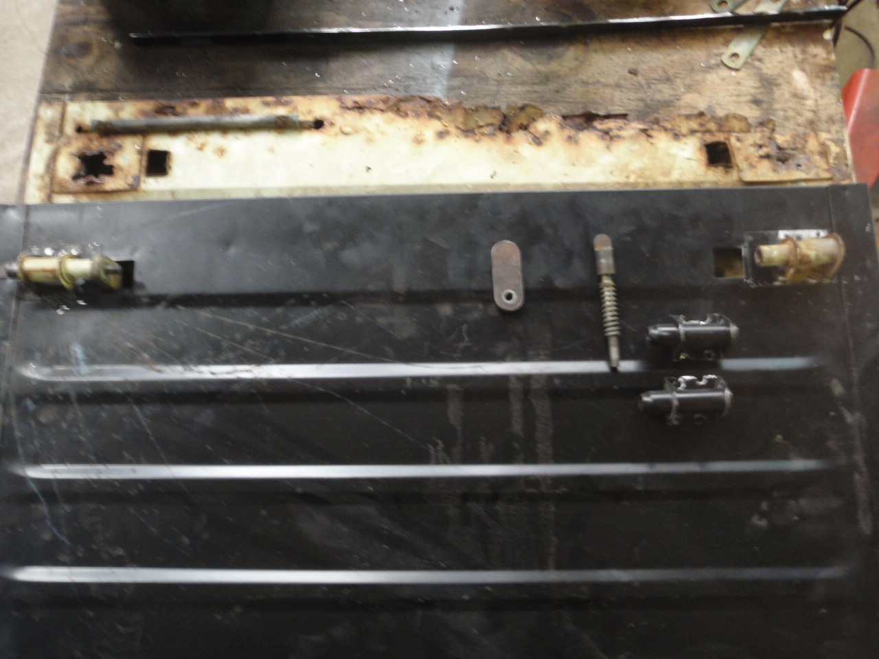

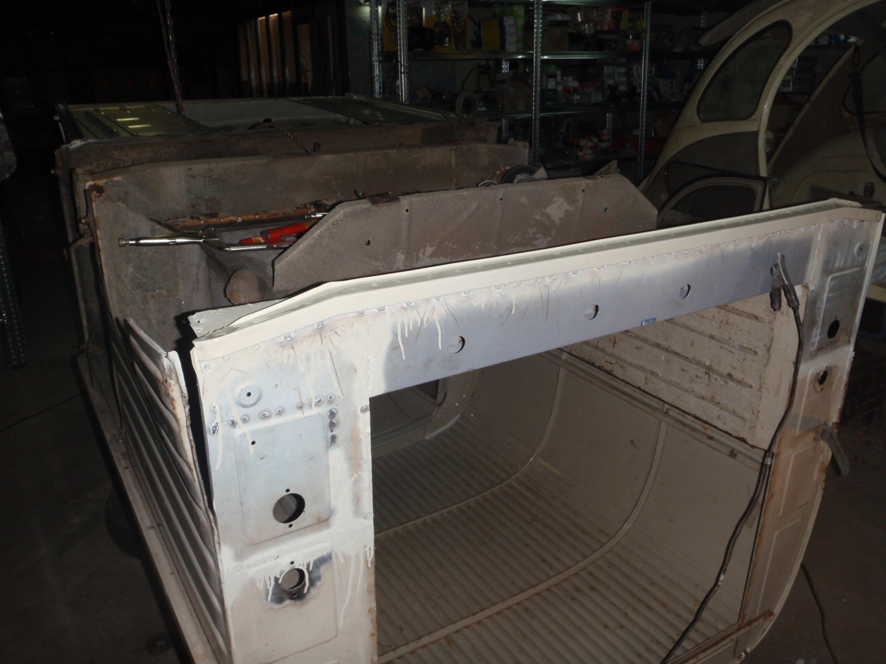

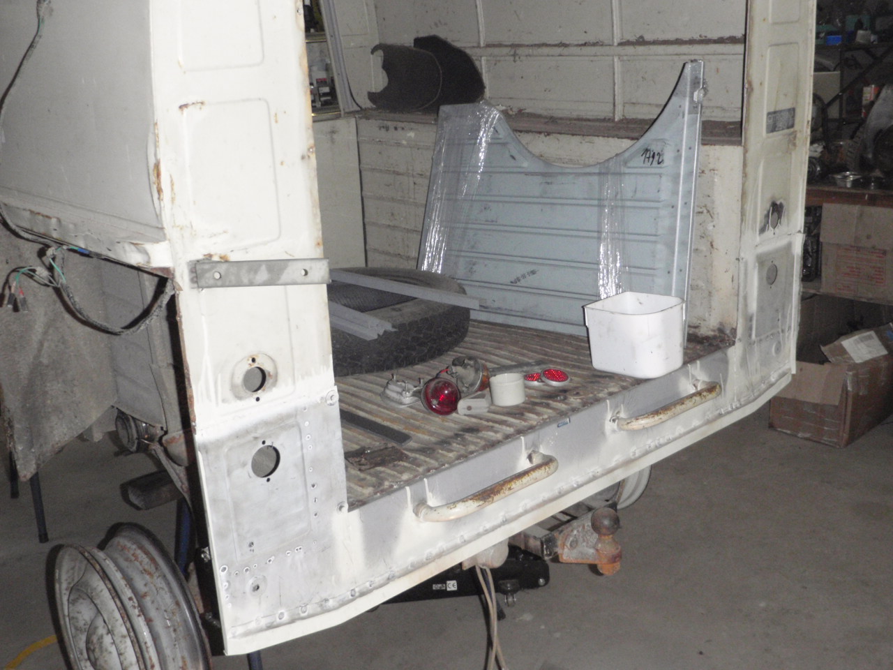

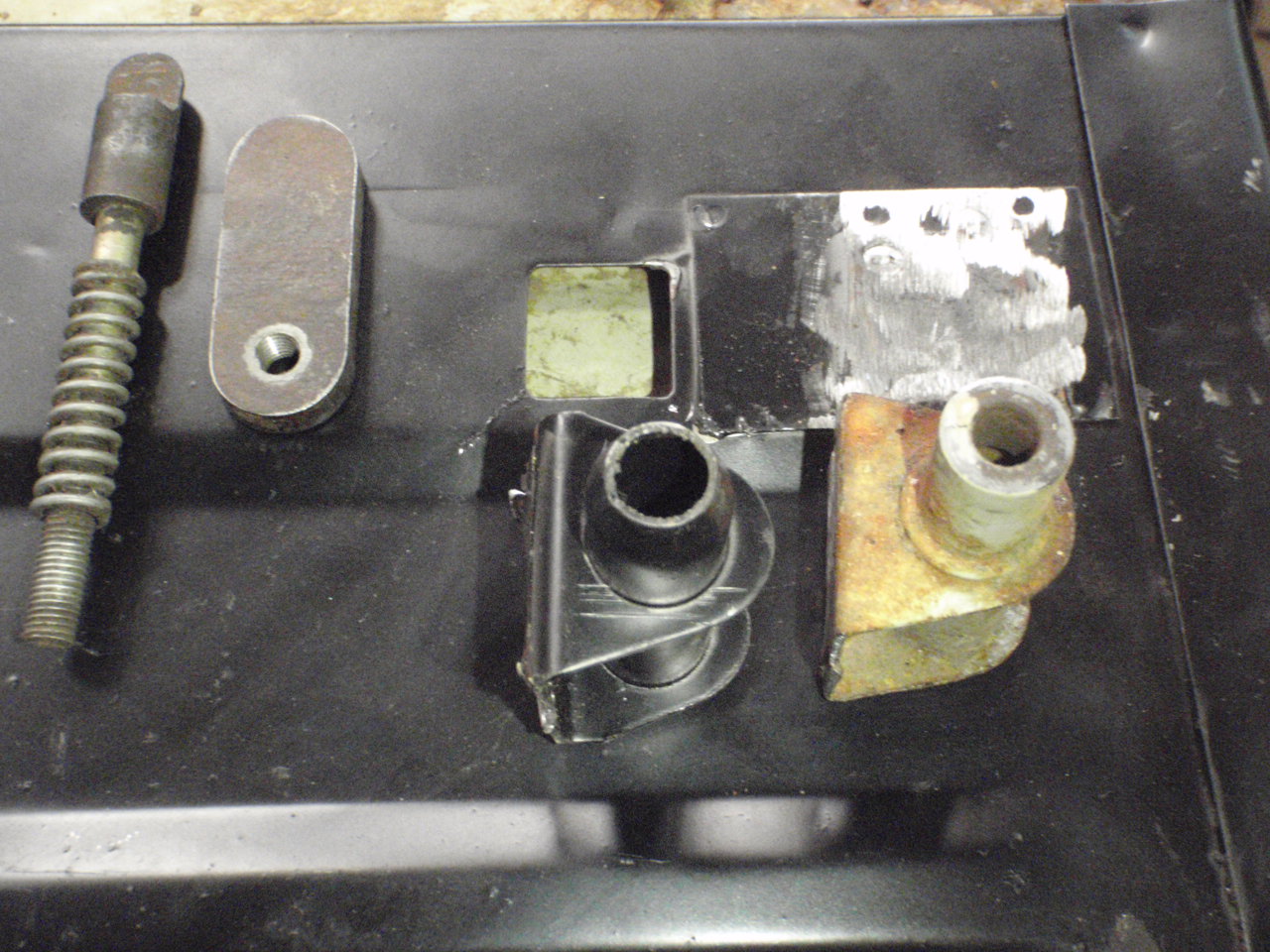

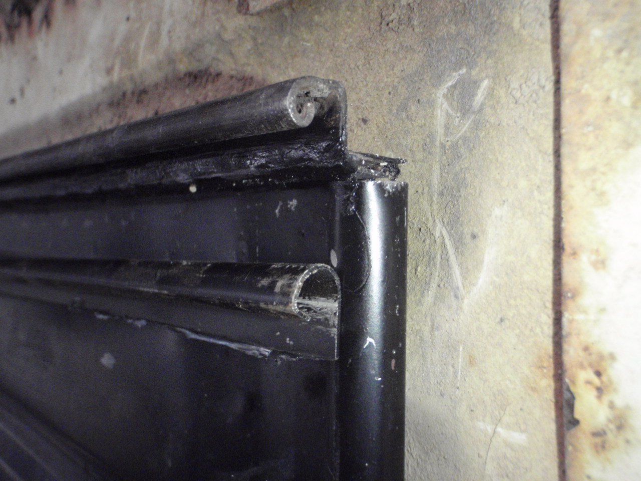

Winter is over, I can continue work on Odin. Done nothing since Nov, too bloody freezing cold. Thanks to Janez in Slovenia, the rear cross bar is now in place and it fitted nicely, thanks Janez.
Working on the side panels now. Bloody reproduction panels do not fit very well. Lining up the rear side panel mating the sparewheel flap is just hard. The sparewheel panel is way off. Had to cut the hinge off and move over the original. The panel was hanging too low so the two lock didn't fit. At the same time, the lock holders are also too big in diameter. The spring didn't have any effect just moving around with no tension on. Had to move over the original holders. What a f...g nightmare fitting these crap reproduction panels.
This van MUST be ready for Raid Afrique :o
