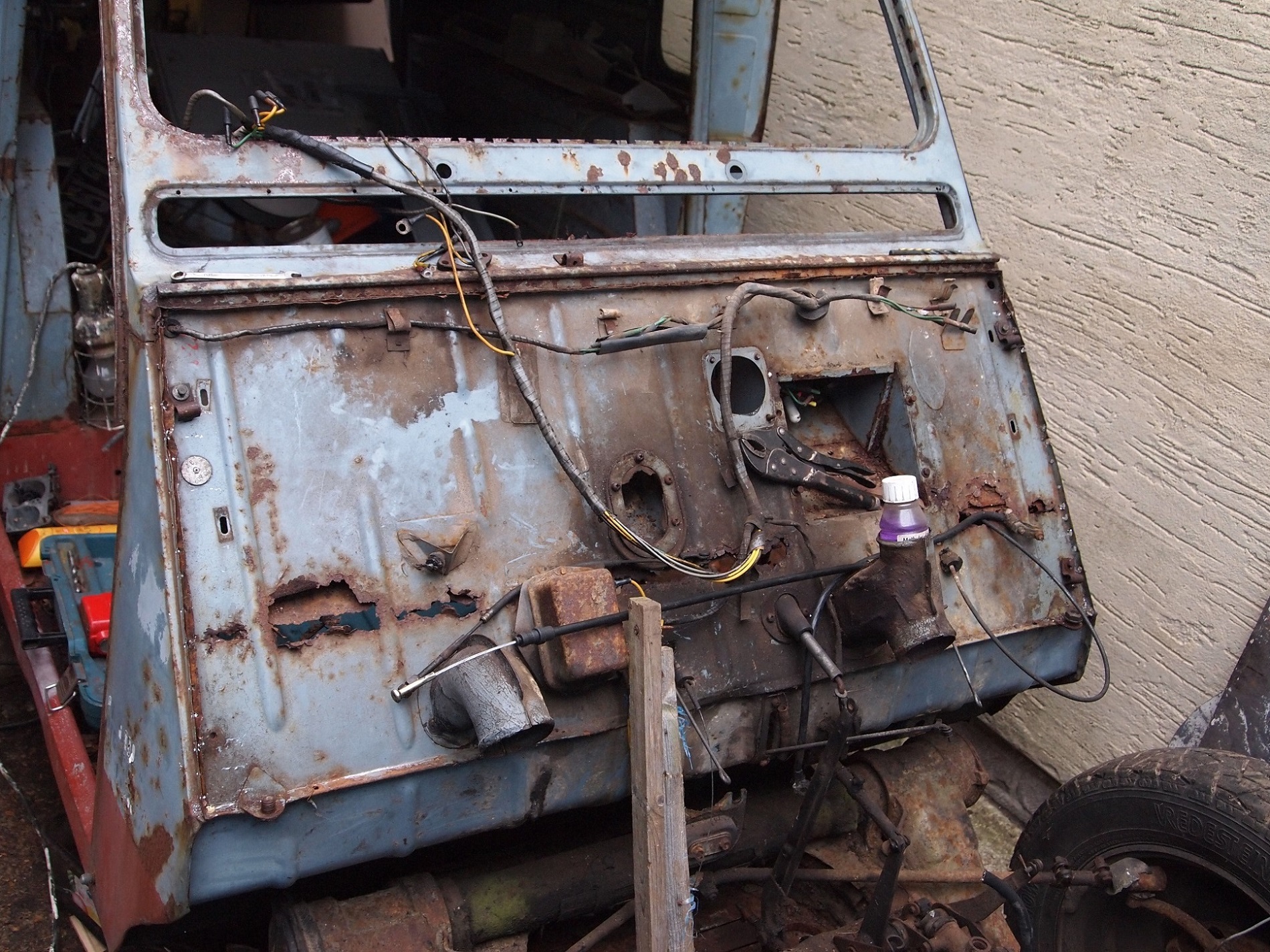

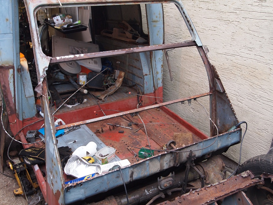

So everything came out :

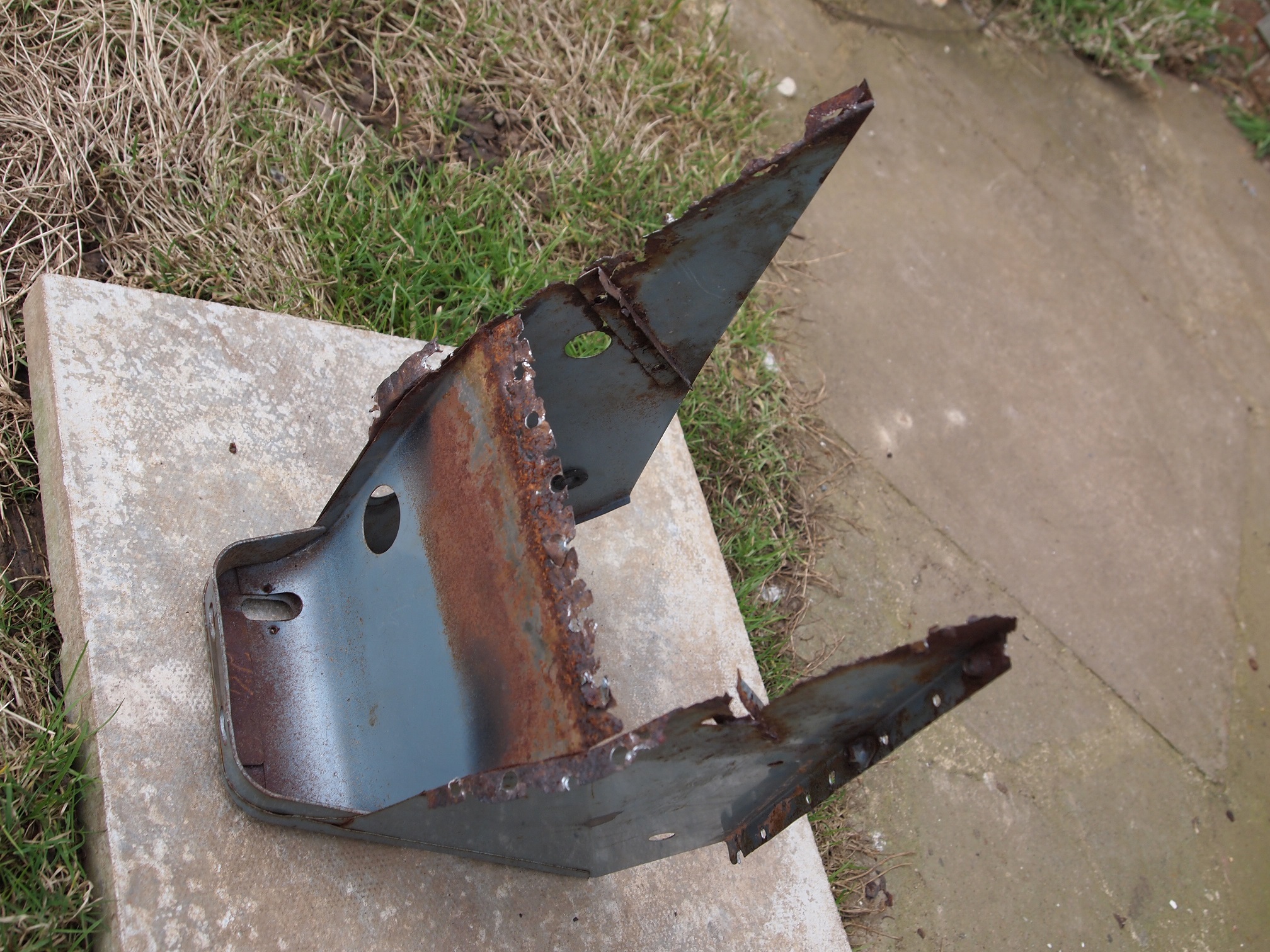

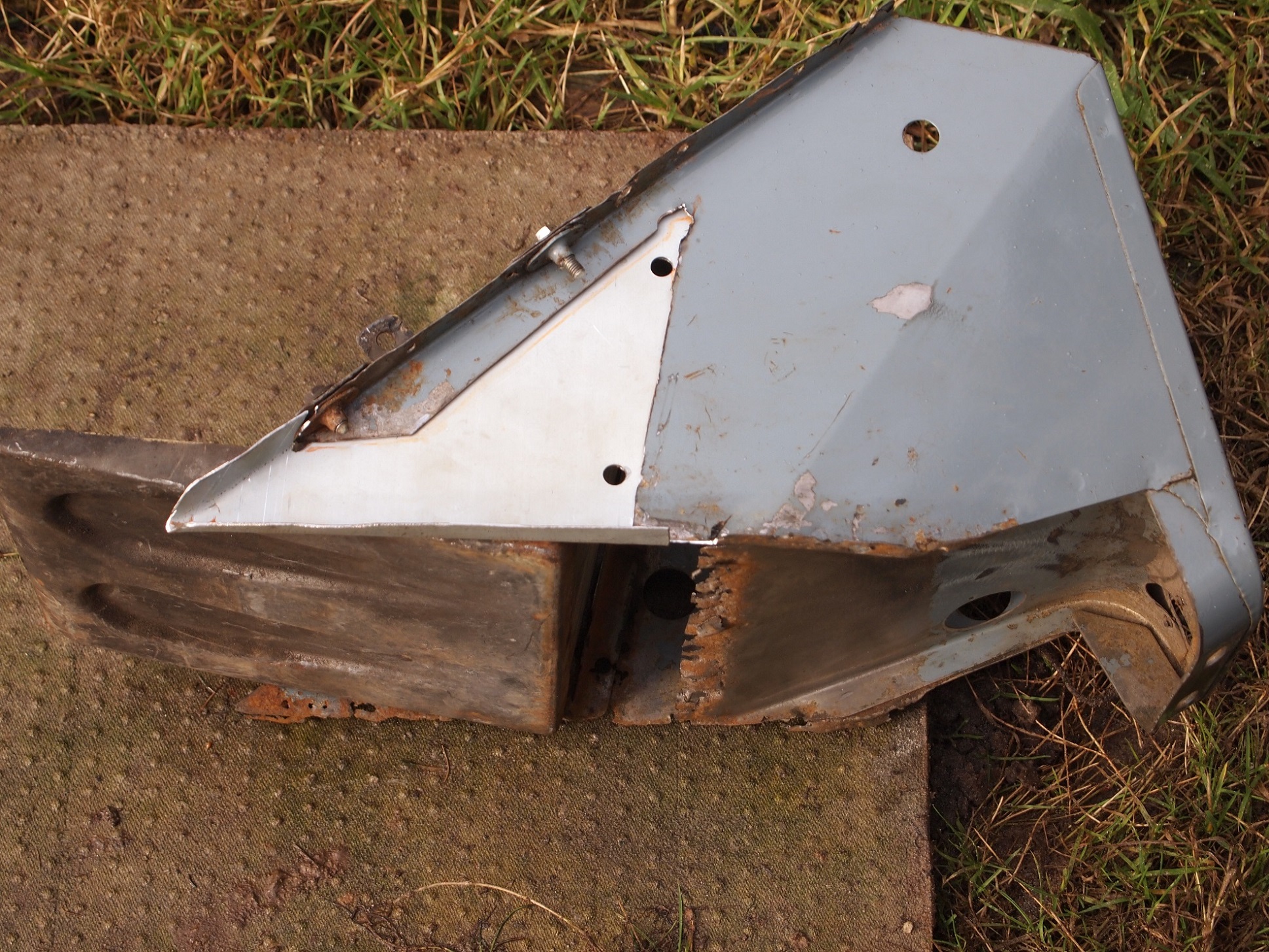

The binnacle had suffered badly along the bottom edges & up the two r/angle braces for the rear of the battery box :

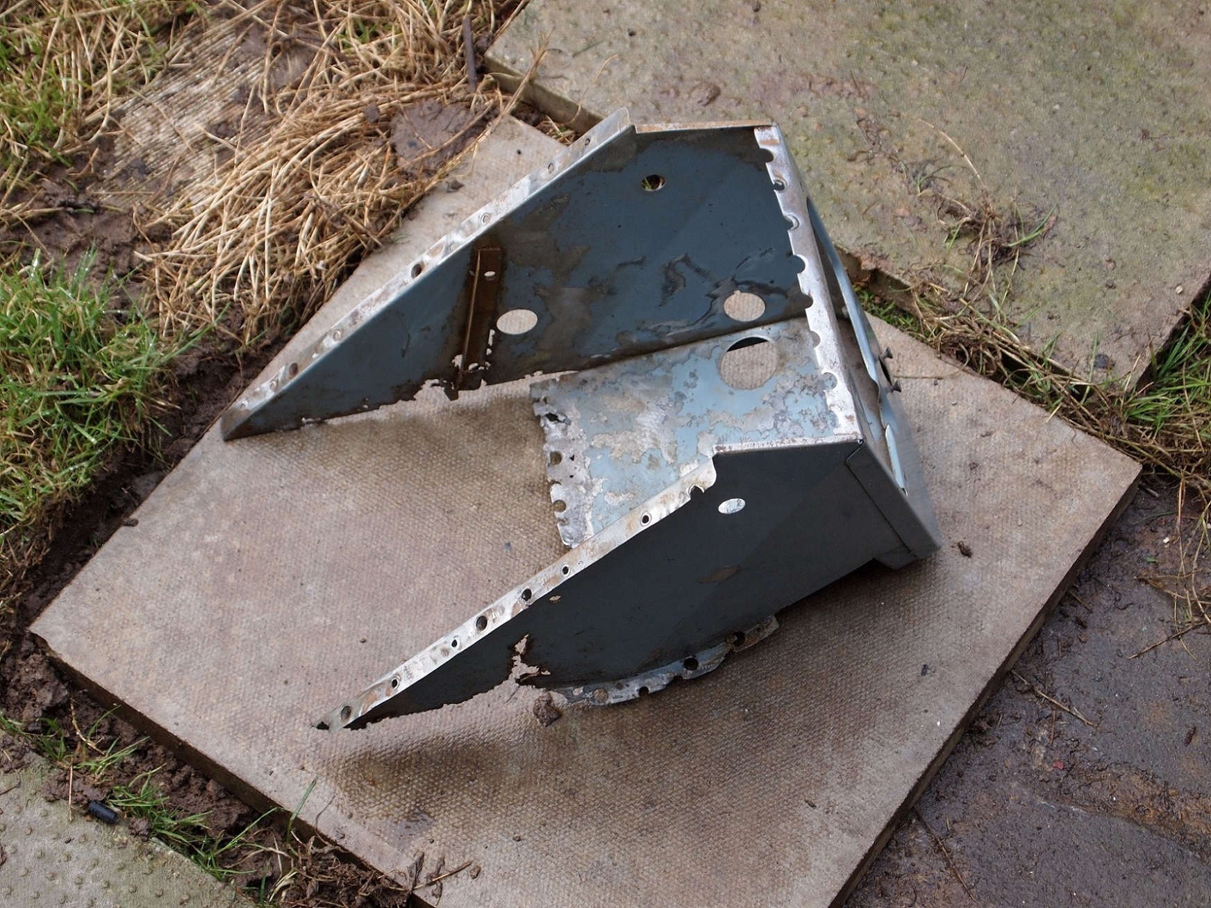

A bit of chopping & bending later :

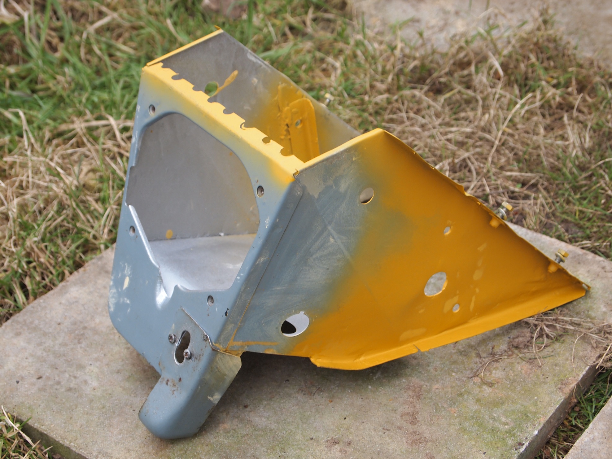

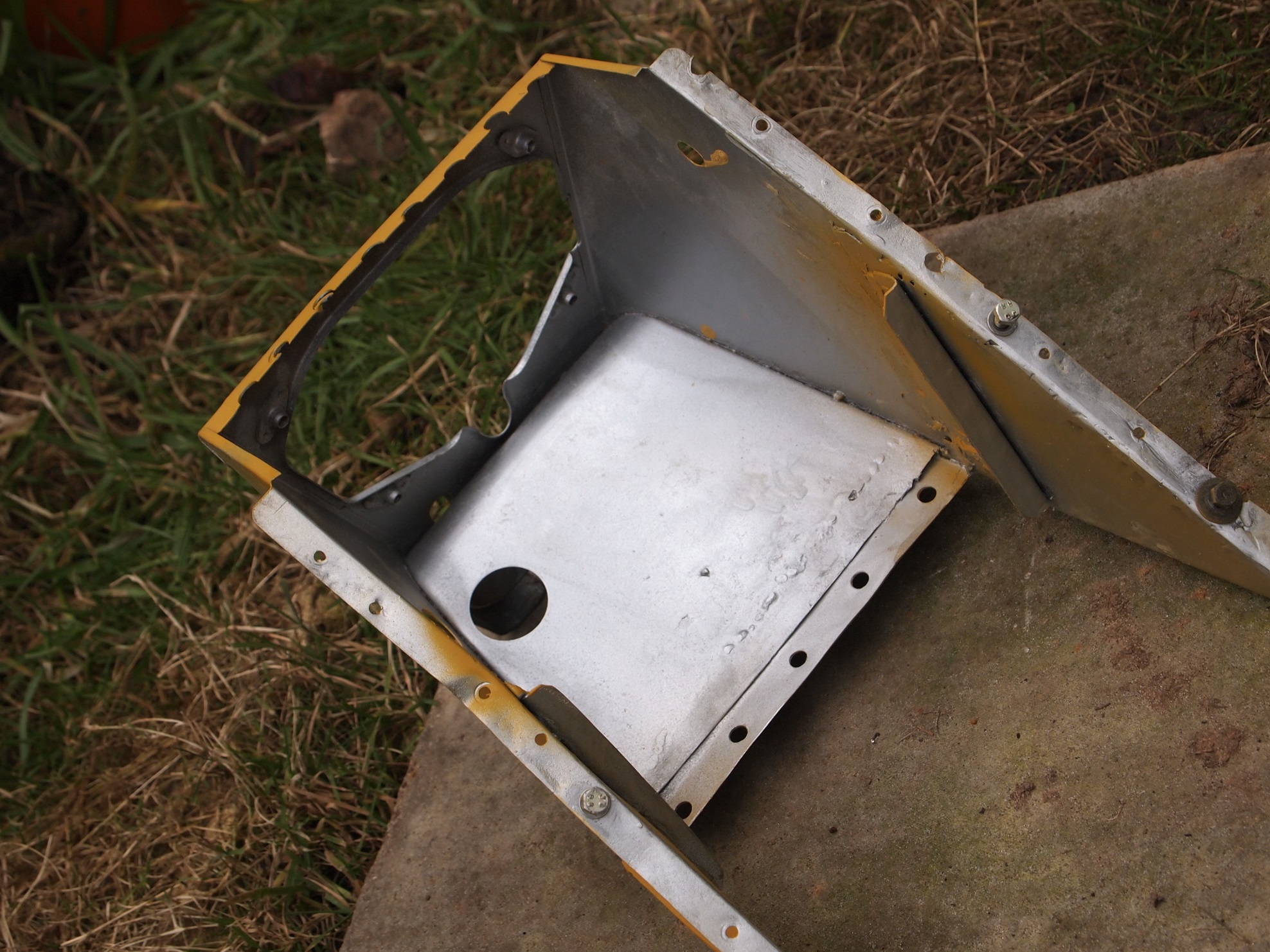

And then some filling & painting - not too fussed about the inside having some lumpy weld as it will be invisible :)

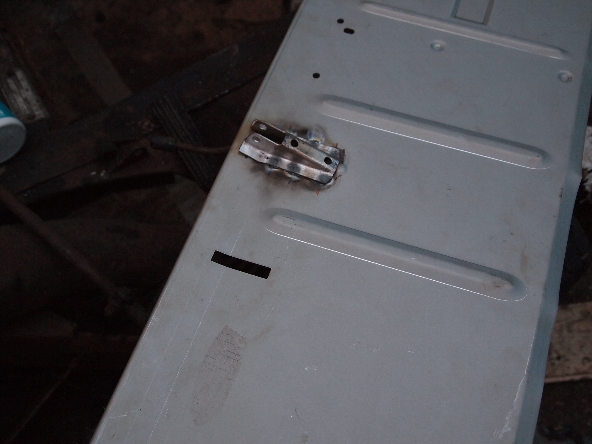

All the brackets for the handbrake, gear lever and all the captive nuts for the 8mm head bolts got removed from the old panels and the brackets were plug welded to the new parcel shelf - also the little body number plate that is folded through 2 slots in the r/h underside of the parcel shelf got transfered, looong befor the parcel shelf got welded in! :lol:

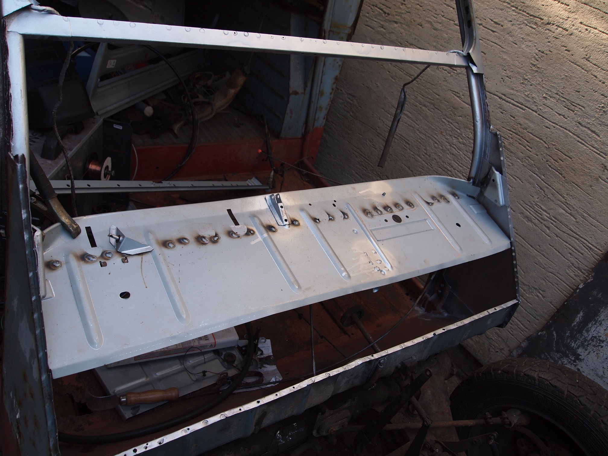

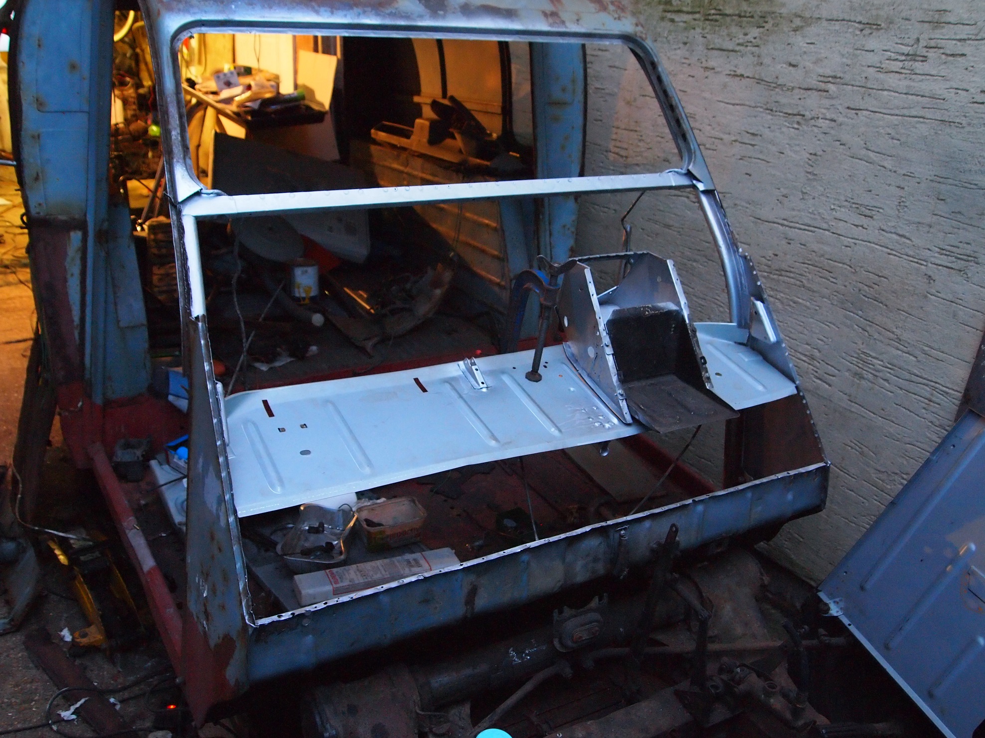

And finaly with much trepidation the parcel shelf was plug welded to the cross bar and the ends buzzed on to the 'A' posts...

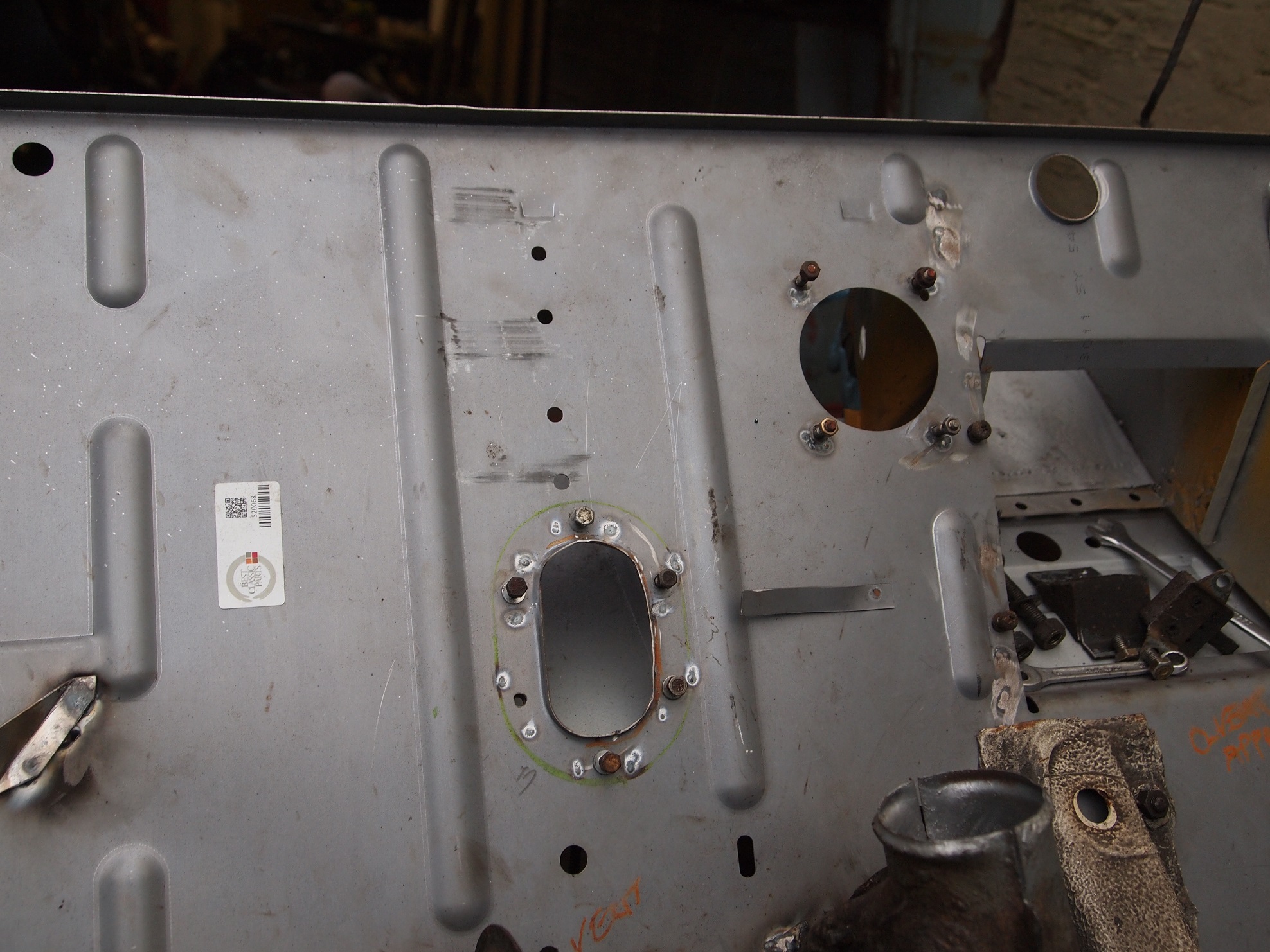

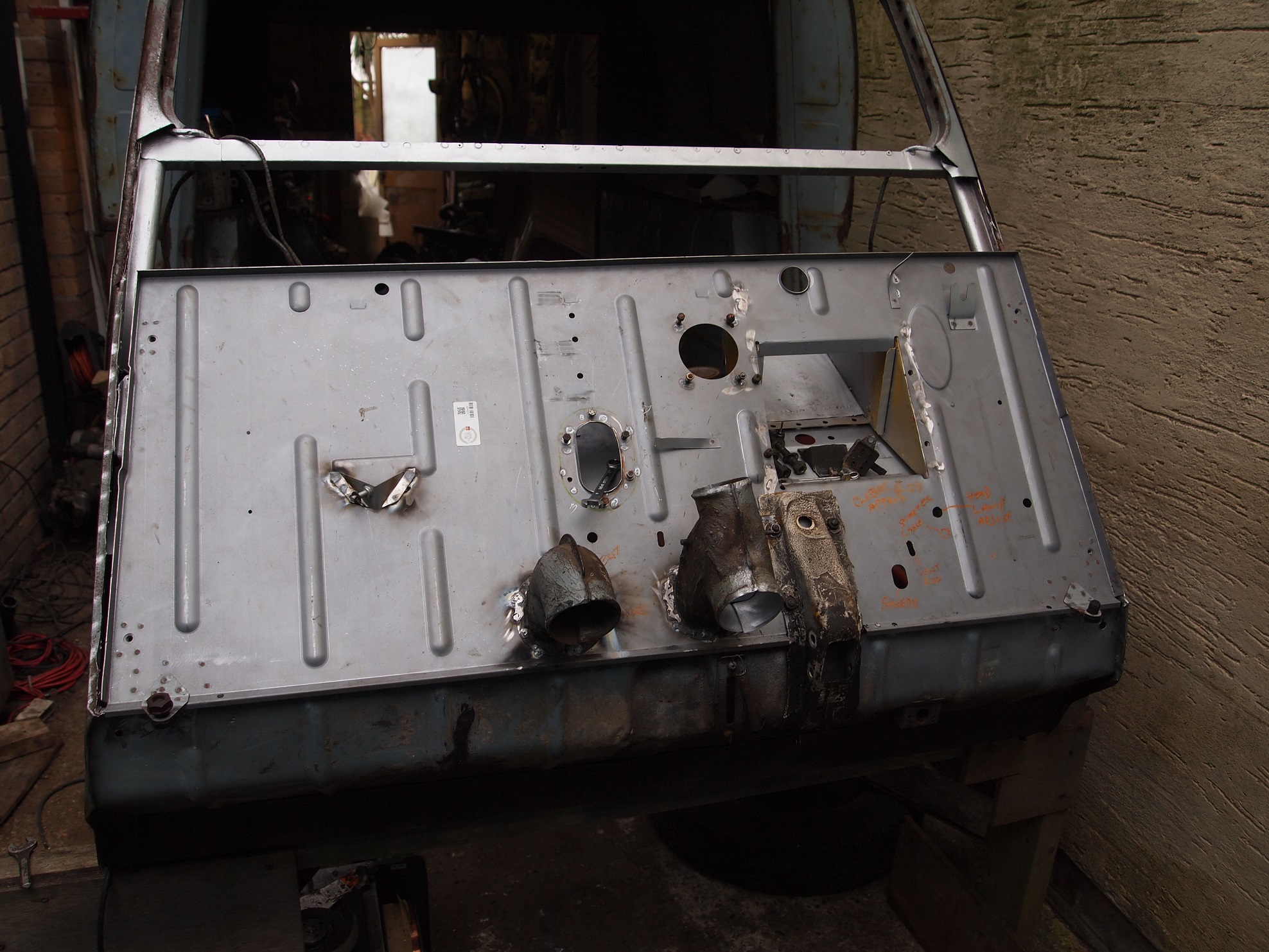

There is a fair bit of difference between the old bulkhead and the new panel I got. Most obvious being the placing of the heater inlets and the holes for the master cylinder/hanging pedal box.
I want to put the modern pedal box in the van so I can run an M28 in it thus I've used the heater duct holes as supplied. Their position will still accept the heater tubes from a 425/M4 whereas getting an M28 to connect to the early position ducts is a pain. In order to get the master cylinder mount on the bulkhead the l/h duct has to move anyway. Getting the old type handbrake & the vent operating rods through is a bit of a challange.
Most of the rest of the work on the bulkhead was captive nuts & studs. These are around the gear shift, handbrake & demister 'oles. The gear shift hole has to pe enlarged a bit for the old braced gear shift.

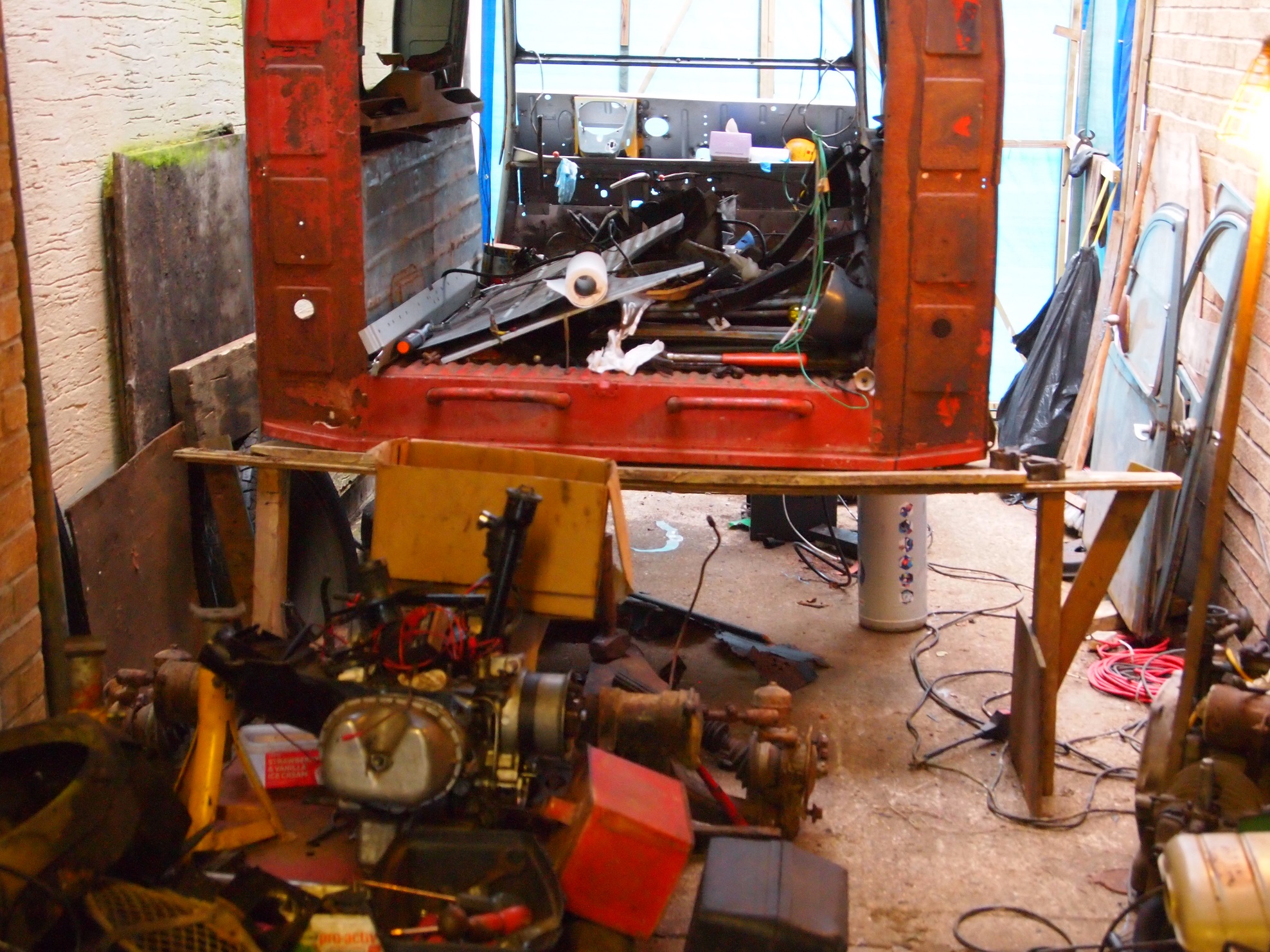

Last week I had 13 year old nephew as a garage slave so we got the body off the chassis (he plays rugby...)

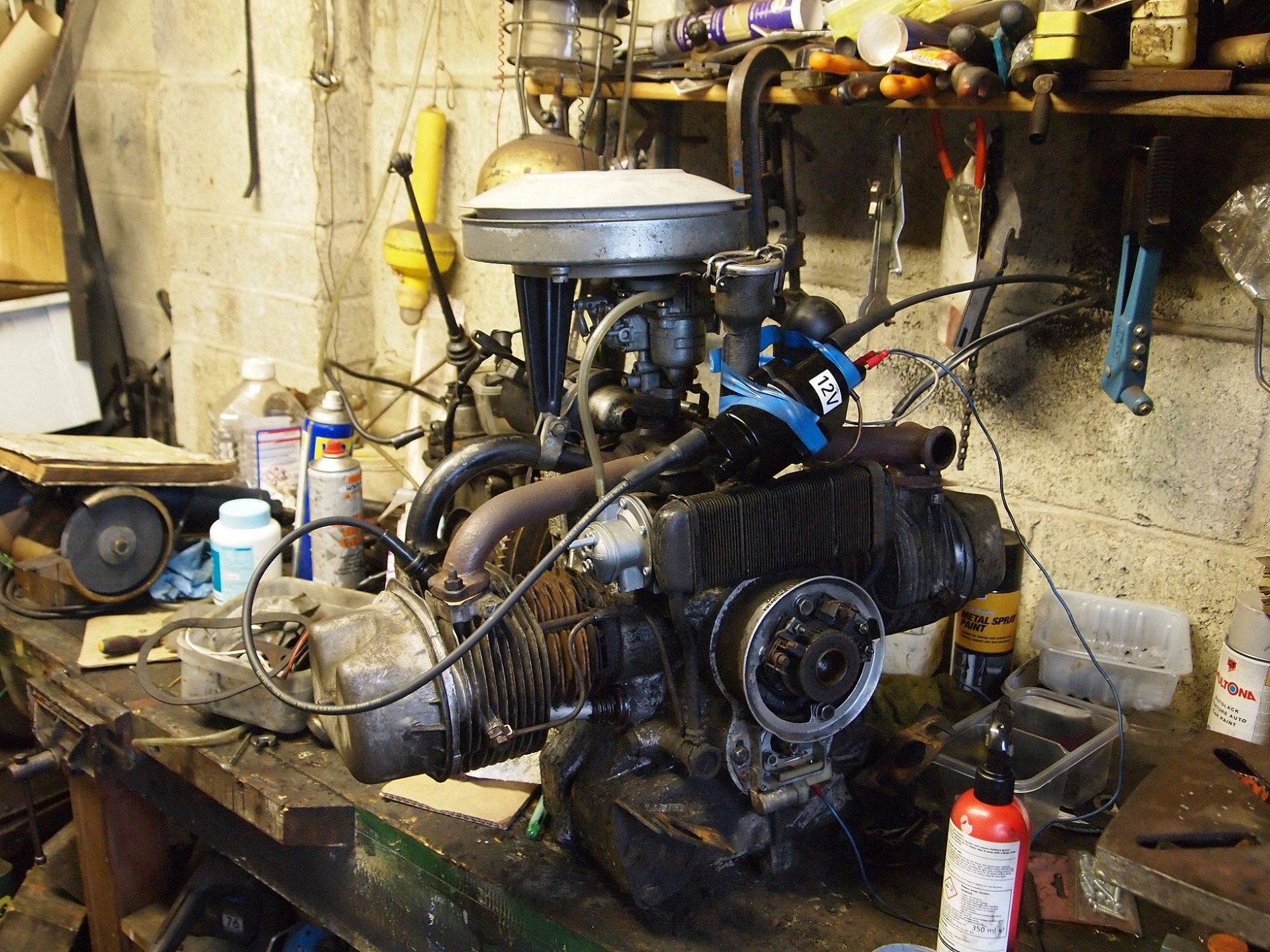

And as a reward(?) he got to strip the heads off the vans engine & find out why it wouldn't run - well that was the plan. It did run & he did actually lap some valves but somehow I ended up doing most of it :shock: He did like the 6inches of flame out of the end of the manifold tho :lol: He spends a lot of time @ Santa Pod and thinks that's how all engines should behave. There's potential there... :lol:

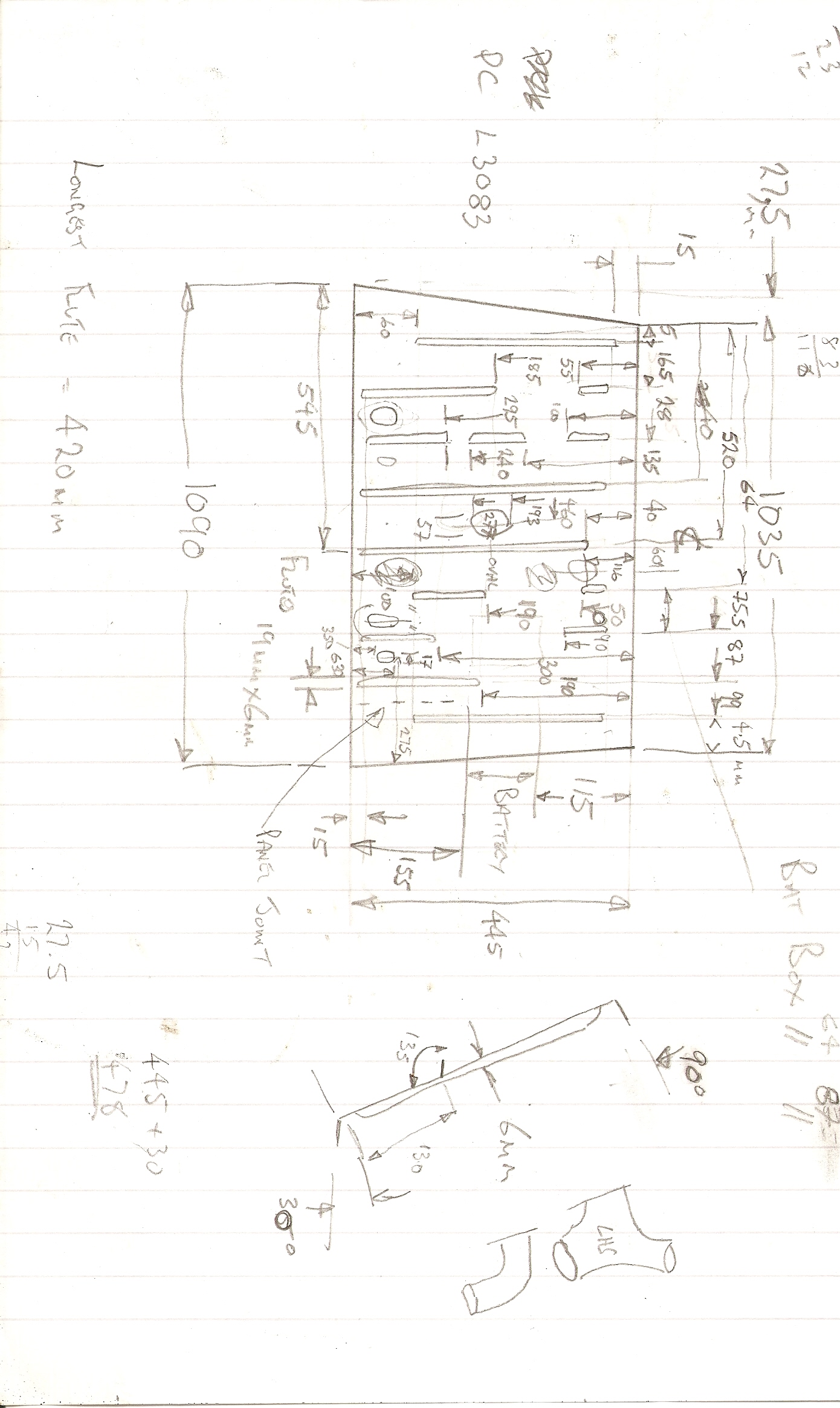

Whilst talking about bulkheads (its a bit late now), I came across this sketch I made when I made mine.
March 3rd, 2015, 9:59 am
Post Re: The Nameless AZU
Cheers Bobh that's still useful - querying some of the dimensions on the new panal, a second set of eyes on the measurements is v. helpful :D

measurements taken off a 1963 french LHD AZU Fourgonnette.
