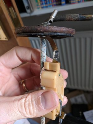

Smiffy,
the 'wiper' which moves over the windings of the rheostat may be worn, as in the photograph below.
A repair can be carried out with a blob of solder, as long as it's not too late and it's damaged the windings...

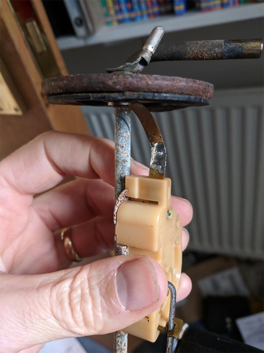

Thanks for that tip, Ken.
Checked the "wiper" and it looks fine.
Soldered the broken strip. Job's a goodun!
