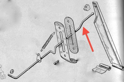

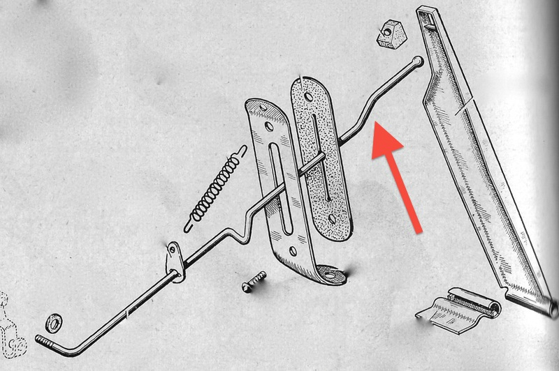

Ordered a new accelerator pedal and mounting bracket,
ImageP1010682 by Robndaisy, on Flickr
before I hang myself from the engine sling chains, how in Flame do these go together and work?
March 10th, 2018, 5:29 pm
Posts: 2228
Post Re: Van repairs
I think they are different generation. The old pedal is put in flat on the floor pointing direction seat. Hooked in and moved forward. Then the rubber is clicked on to the accellerator rod. See this pic don't pay attention to the arrow. You can try and replicate this or find a 60s pedal...
