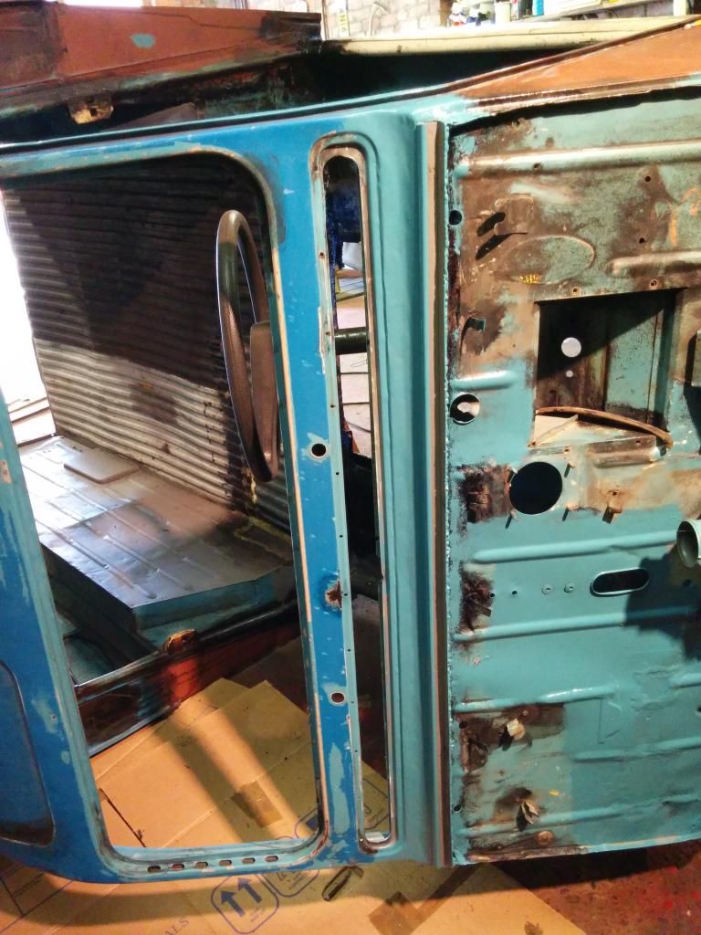

Spent the day preparing for some more welding next week, and cut back the old topcoat on the outside of the bodyshell, ready for a bit of paint action soon.
Took a couple of measurement pics of items I needed to cut out, so that I could repair beneath them. Got a message from Google about an hour later telling me that they'd done something arty to one of the pics!

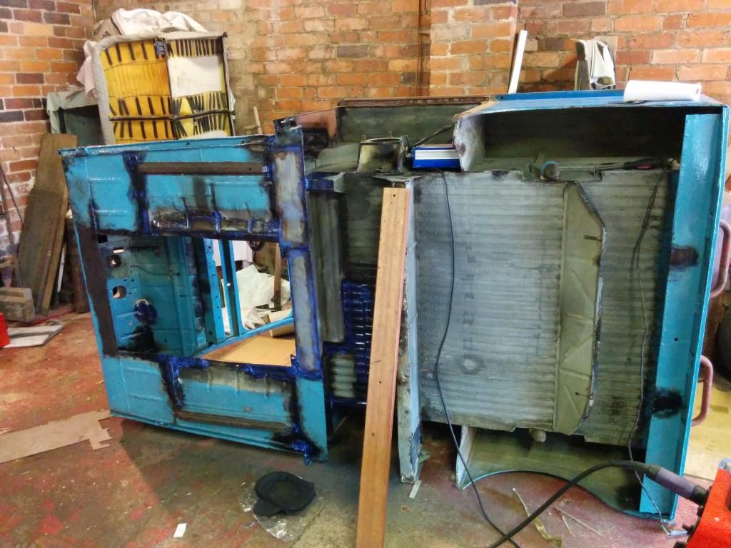

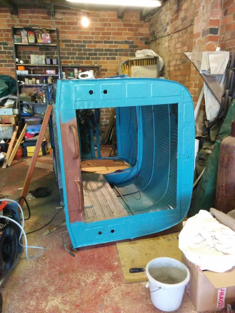

Flipped it on its side for a bit more welding fun... and then actually managed to do a bit of painting. Woohoo. Finally feel like I'm making some progress.

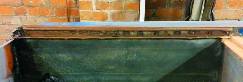

This hinge thing for the spare wheel cover. Are replacements available? Can't find them on the ECAS site.

Int it the same as bonnet hinge or summat? I wish I had a van.

'fraid not. It's the same as the back door hinge, but I can't find any of those either. :(

hinge for the reardoor of a normal 2cv on the b-pillar could be the same?

AfaIct the 'hinge' is basically the same arangement but the angle it is set at compared to it's base and the size and shape of it's base are different, the 2 halves of the hinge are different cross section shapes. It should be possible to mix & match but it will be neccessary to 'bugger about' with angles & such.
ECAS have rear door (body side) hinges : http://www.ecas2cvparts.co.uk/door-hing ... -2184.html & its friend of course... I just bought pair for the AZU - 'kin expensive but I couldn't make them & the buggering about looked too much like hard work... :lol:
