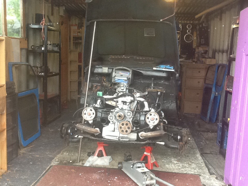

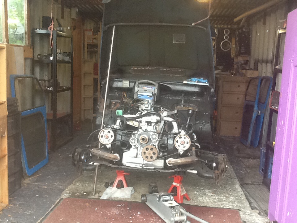

The garage door has been opened and a few hours ( well a while anyway) might be spent having a play... Wish me luck :D

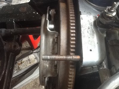

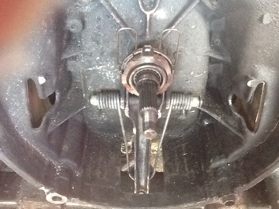

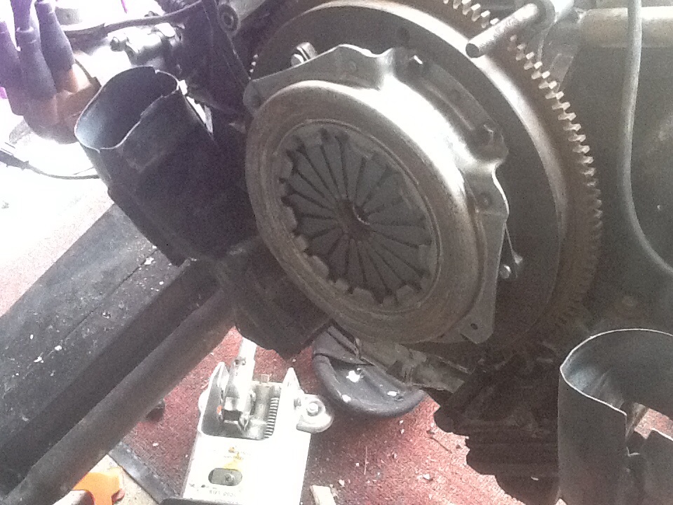

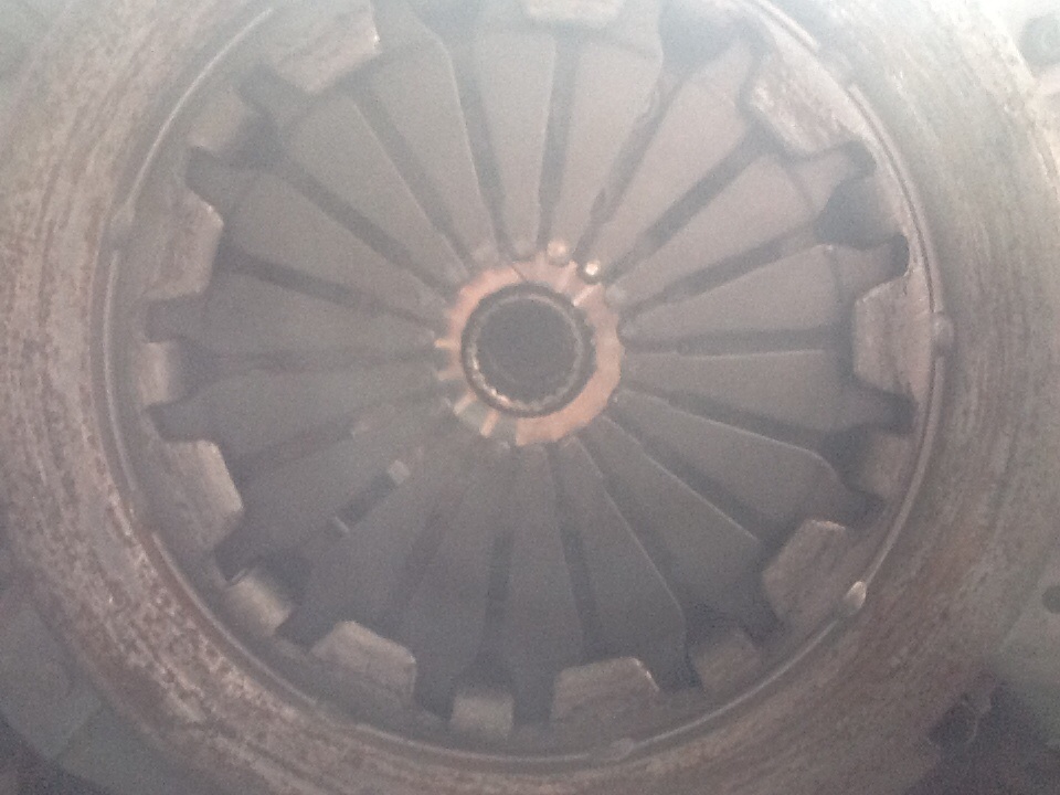

I'm almost about to list it on eBay,

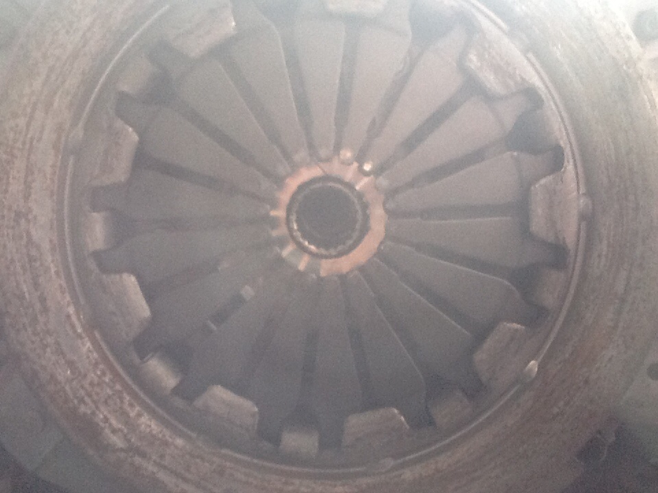

Managed to get engine parted from gearbox and rest on front of chassis, put the correct release arm spring that joolz kindly gave me, bolted back together and still the drive/driveshafts r locked up solid!!!! :evil:
Started to loosen the 4 engine/gearbox off yet again and slowly the driveshafts started to move again but with the background of an awful metal on metal noise!!!!!
Sounds like the pressure plate is rubbing on the inside of the bell housing, but why the hell is it doing that??
Gearbox is a standard 4 speed out of a GS and the clutch was supplied by rob at chevronics
The whole set up has been fine with the old 1220cc in, then I put this 1299cc I got from Paul aka nelsthebass and suddenly another fucking problem!!!!! :|
I've hopefully attached a couple of pictures, I know is hard to see when not in the flesh but to those in the know does anything look wrong????
Sorry pics ain't great!!!

Are all G flywheels the same, or are there different thicknesses?
June 23rd, 2014, 4:18 pm
Posts: 300
Location: Netherlands
Post Re: LGY 275P Rises Again!
Gearbox input shaft looks to be cut off.
June 23rd, 2014, 5:50 pm

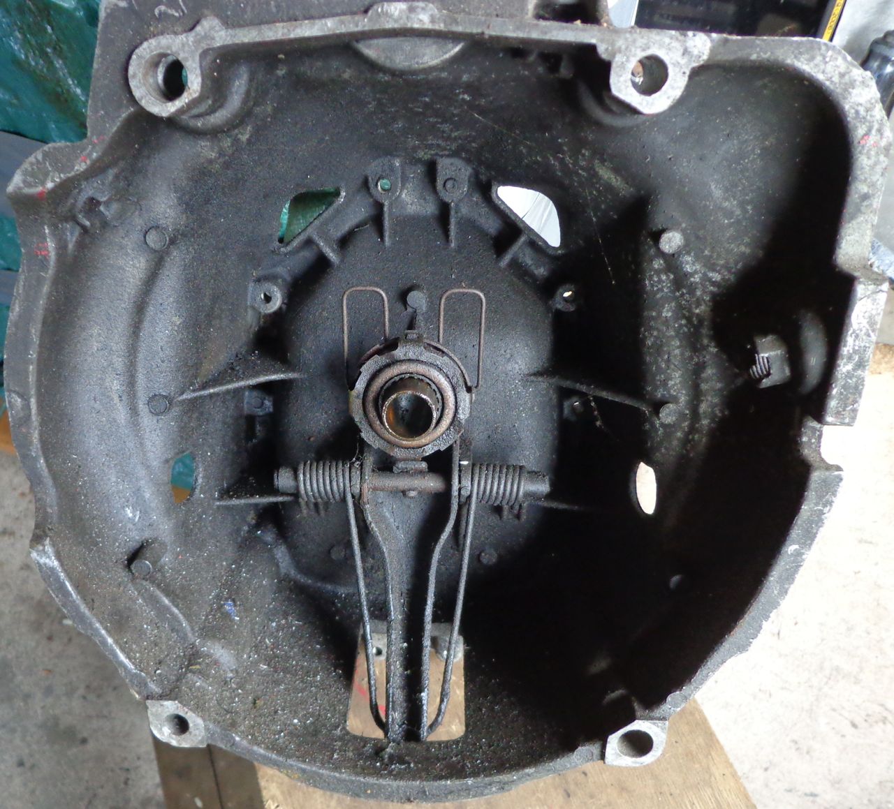

GS Bellhousing?
June 23rd, 2014, 6:21 pm
Location: Northumberland
Have I got an ami box not a gs one???
