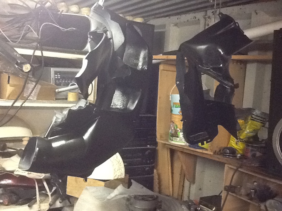

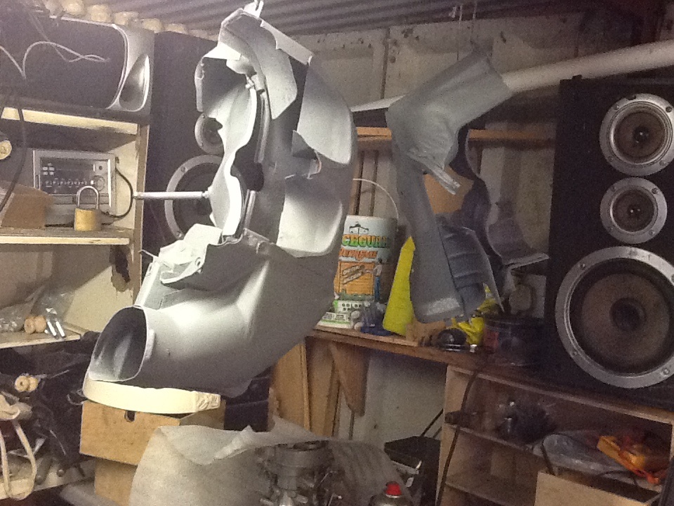

Actually been in the garage 2nite, haven't done anything useful really, just been arseing around with some paint, if you can see what I've done through the background of shite in my garage!!! :lol:
Got the summer hols coming up so will make my best efforts to get some mink done!! :lol: :lol:

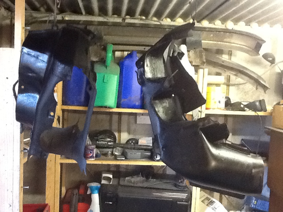

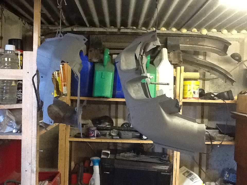

A bit of a waste of 10 minutes but hey ho there are done now.. Might get round to fitting them next... :o

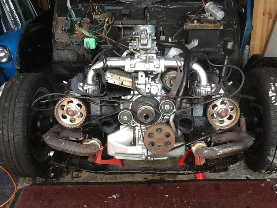

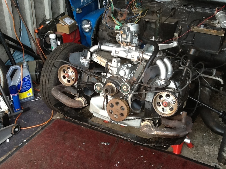

Eventually "dressed" the engine well got the important stuff on, and engine back in..
Just to find that the gearbox/drive was solid wheels wouldn't turn....bugger..... :twisted: :evil:
File comment: Engine out again then....FFS!!!!
