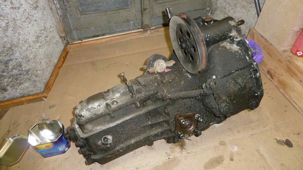

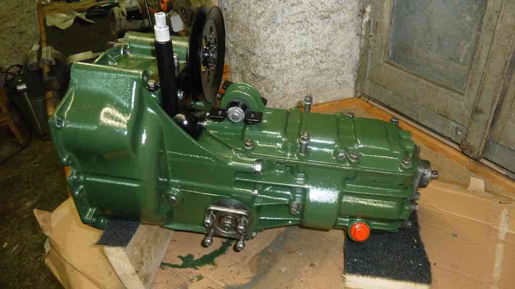

In the mean time I have checked and serviced my gearbox and got into a state it will be allowed back in the car. It was in a bit of a state and I was worried it was going to be the same inside but from the previous photos it can be seen to quite nice in there.
After about 2 days of cleaning - I am whittling these cleaning jobs down now but they still suck big time :?

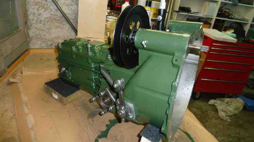

And then finally, the nice job of painting and making everything pretty again. I am also learning a lot about the operation of the gearbox...the hard way... by rebuilding, unbuilding, rebuilding correctly. I like the way the thrust bearing when activated towards the clutch activates the middle lever of the gearbox to allow gear selection. So without pressing the clutch down you can't select a gear (I know you wouldn't anyway but this seems to be a fail safe way)
No new parts were used in the making of this photo :lol:

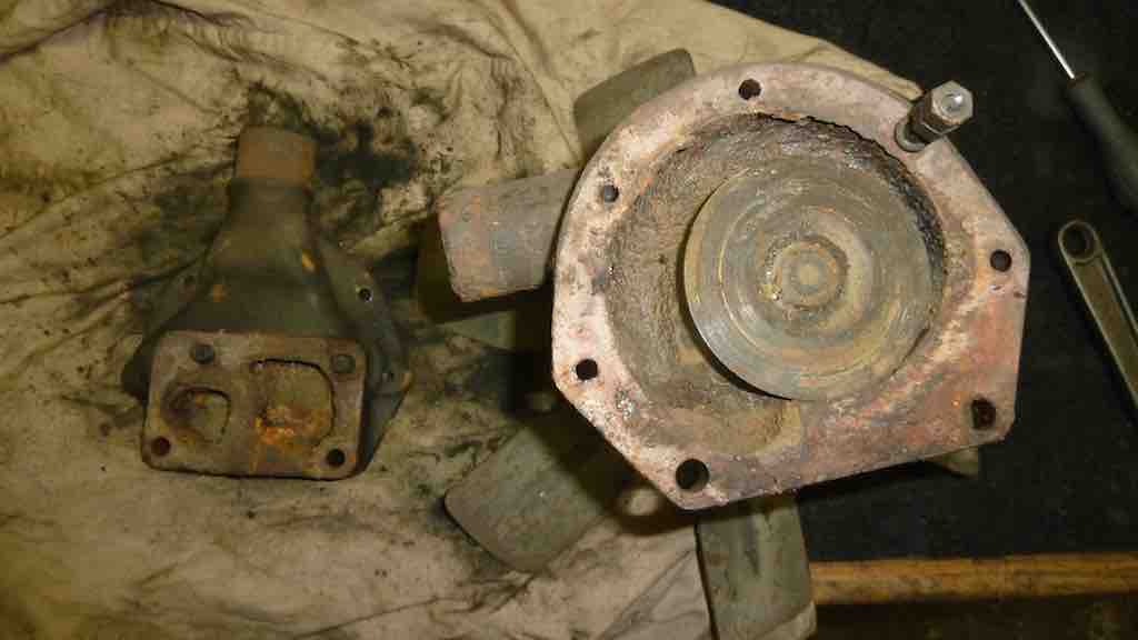

Then I progressed to the water pump which I thought was going to be totally rusted out. But after wire wheeling and scraping the guts out both units looked to be in good shape. The propeller is in perfect condition as are the bearings and seals.
So more cleaning and paint work and greasing and rebuilding.
Where the rubber hoses attach there is pitted holes but there is a good 3mm of good metal left. Plus I will using a waterless coolant when I rebuild so the corrosion will hopefully not get any worse. It will last another 50 years at least ;)

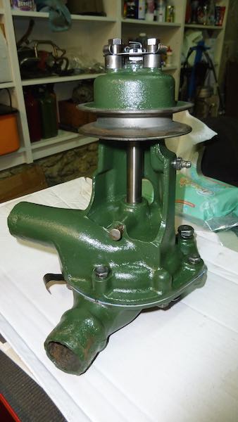

All done and rebuilt, just to add the fan later (in its bright new yellow look)
