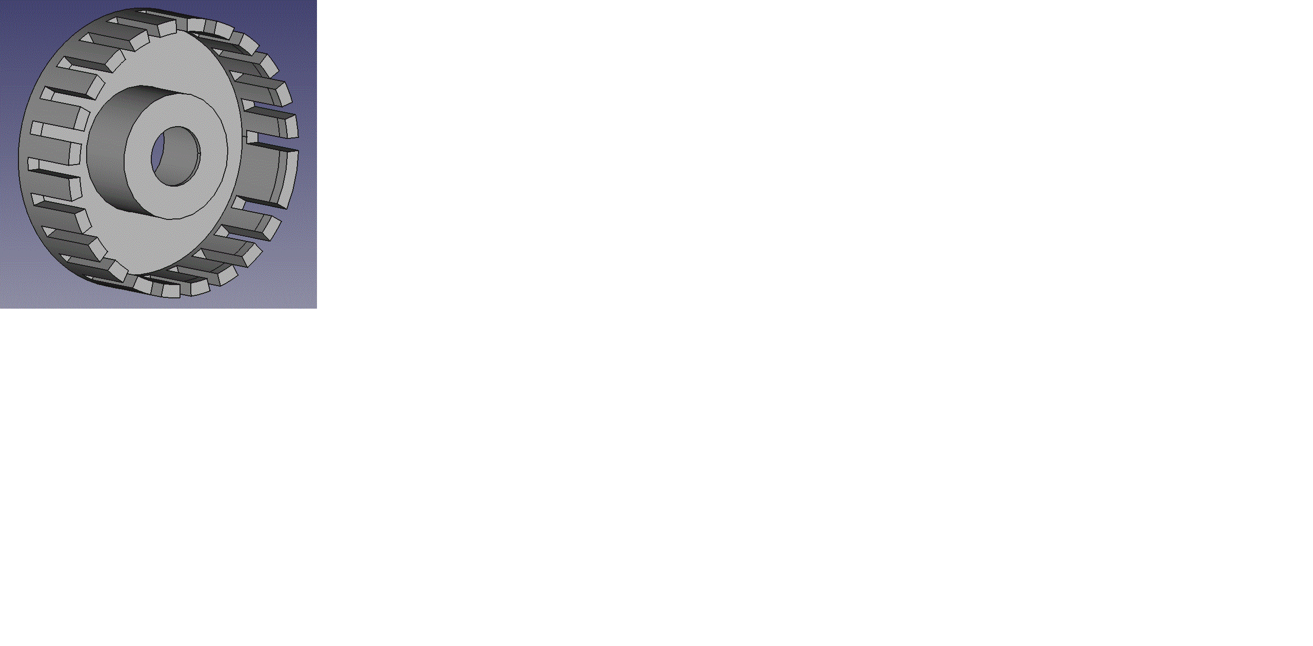

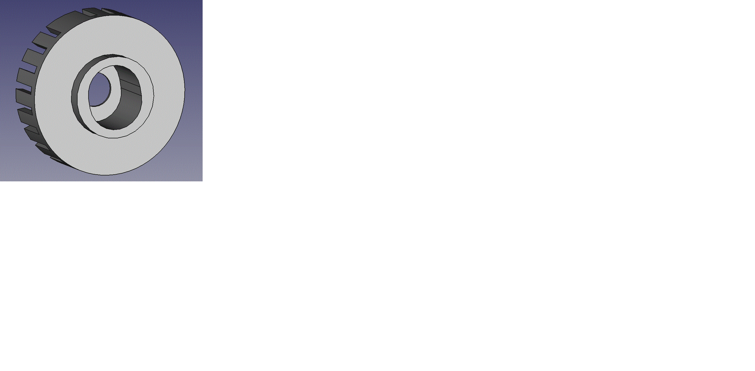

A little bit of progress on the Shedouin. My efforts using FreeCad. The wheel is only 42mm in diameter and 24-1, and the idea is to replace the Lumenition trigger, but use the Lumenition sensor connected to Speedy.
Now I need to get it printed.! I've been looking at 3D printers and they range in price from about 3k to a 100 pounds. So you really have to wonder what your going to get for a hundred pounds! Brother in Law says he knows people with cheap ones who spend more time getting them working than printing with them. :lol:
File comment: Trigger Wheel Rear

File comment: Trigger Wheel Front

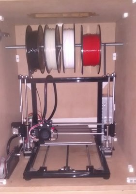

I acquired a 3D printer a few days ago. Just have to learn to use it now. :D

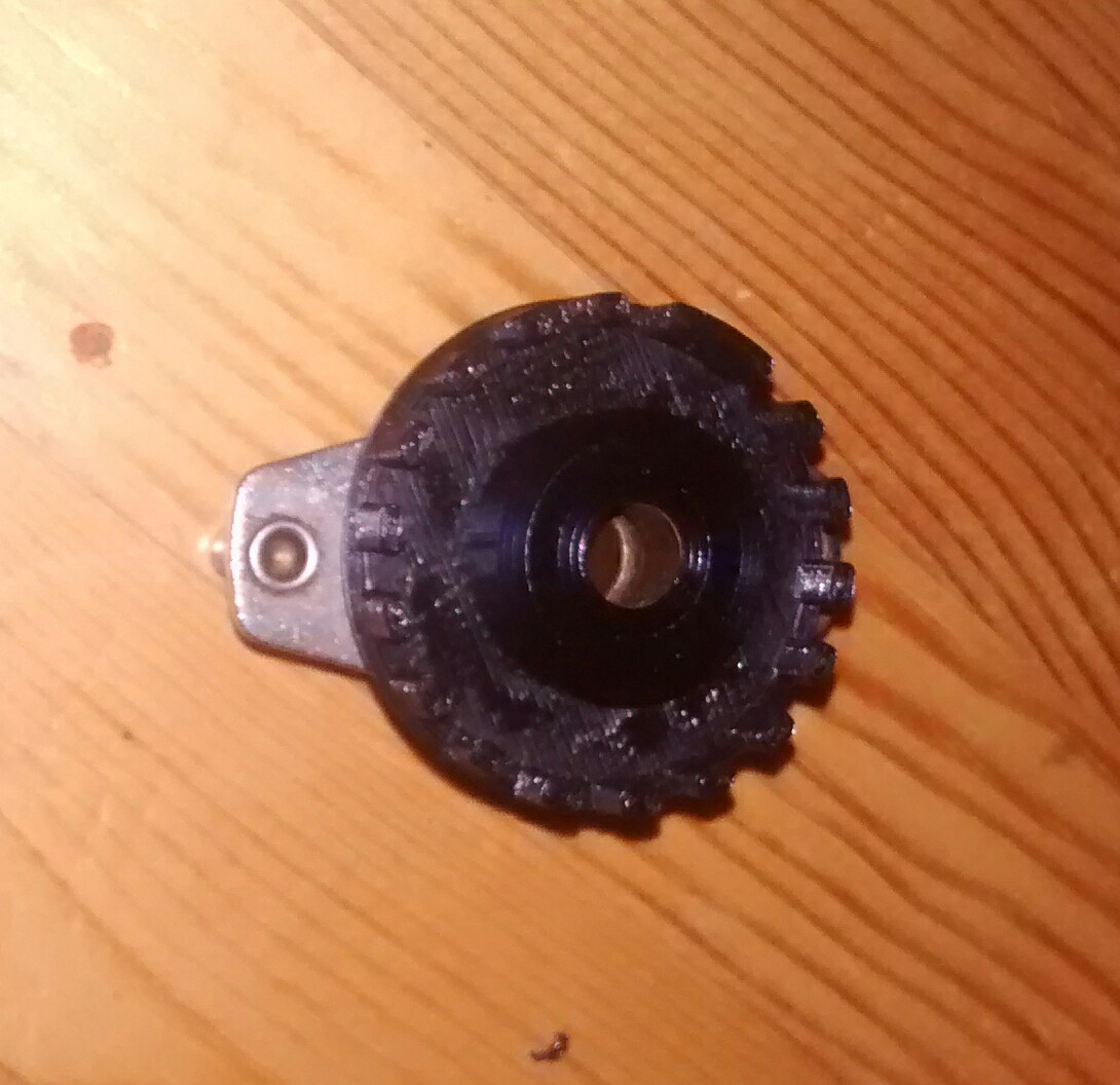

Some progress on my steep Learning curve :D
I have a prototype 36-1 wheel. As it's running on the cam, the resolution is really 18-1. I may get away with a higher resolution but thought I would try this. Although, it fits the points cam, I don't know if it will fit the optical sensor yet. :D
File comment: It may look rough, but its the light reflecting off the tupperware

Post Re: My Beduino
I have 36-1 trigger wheel on cam on my Sm, controlling ignition with MS2. Couldn't believe the accuracy with that, the advance is right there where it should be, checked with strobe and fixed advance. Don't be worried about need of higher resolution...
