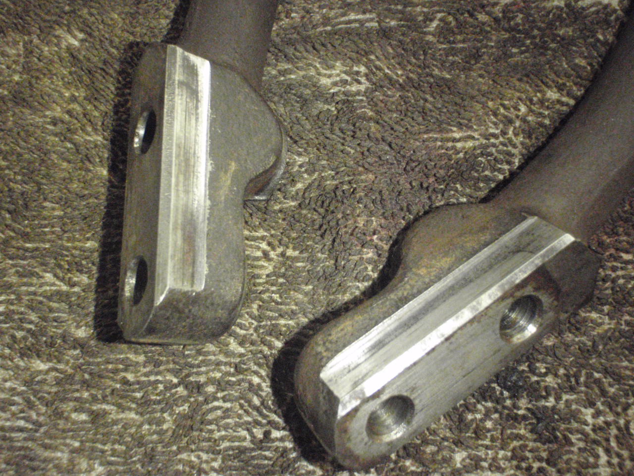

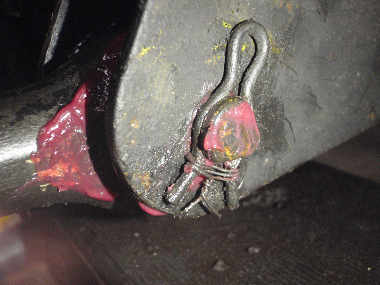

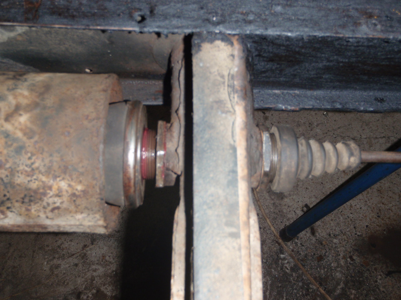

Finished all 4 swing arm bearings, cleaned and greased up. Fitted both spring pots and connected all tie rods, end eyes and knife edges. Clips secured with wire so I won't loose them on the raid if going through high grass or bushes.

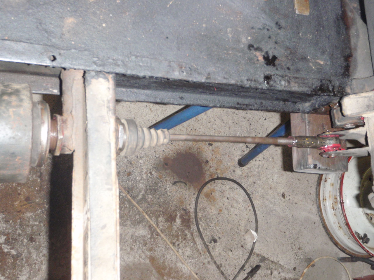

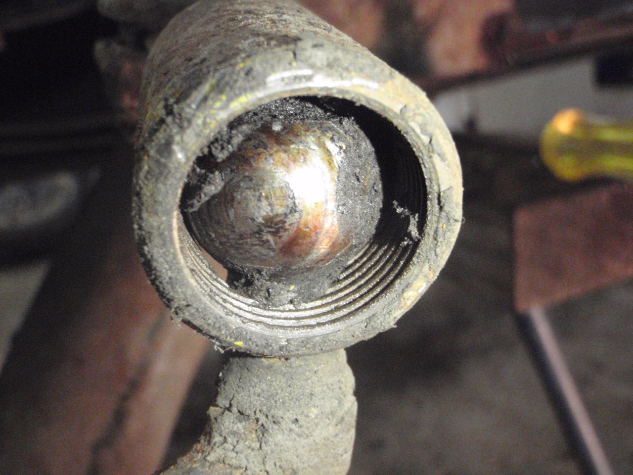

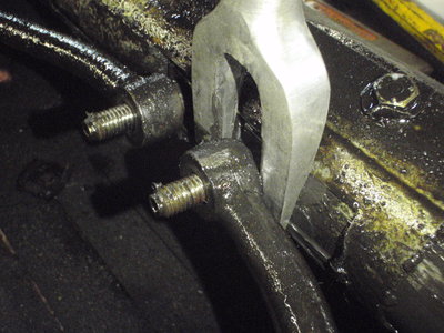

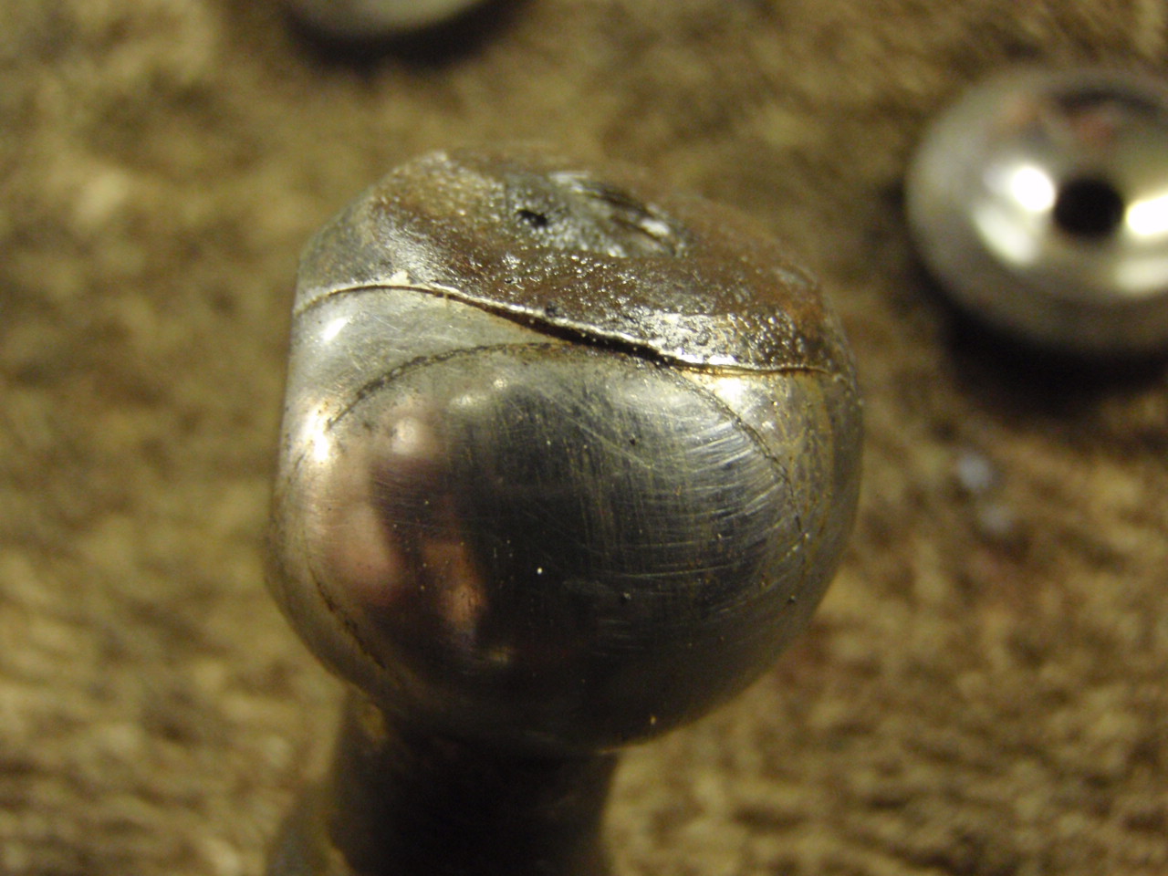

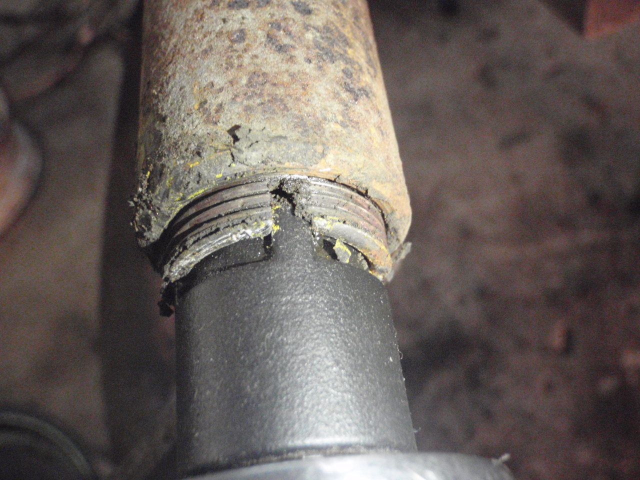

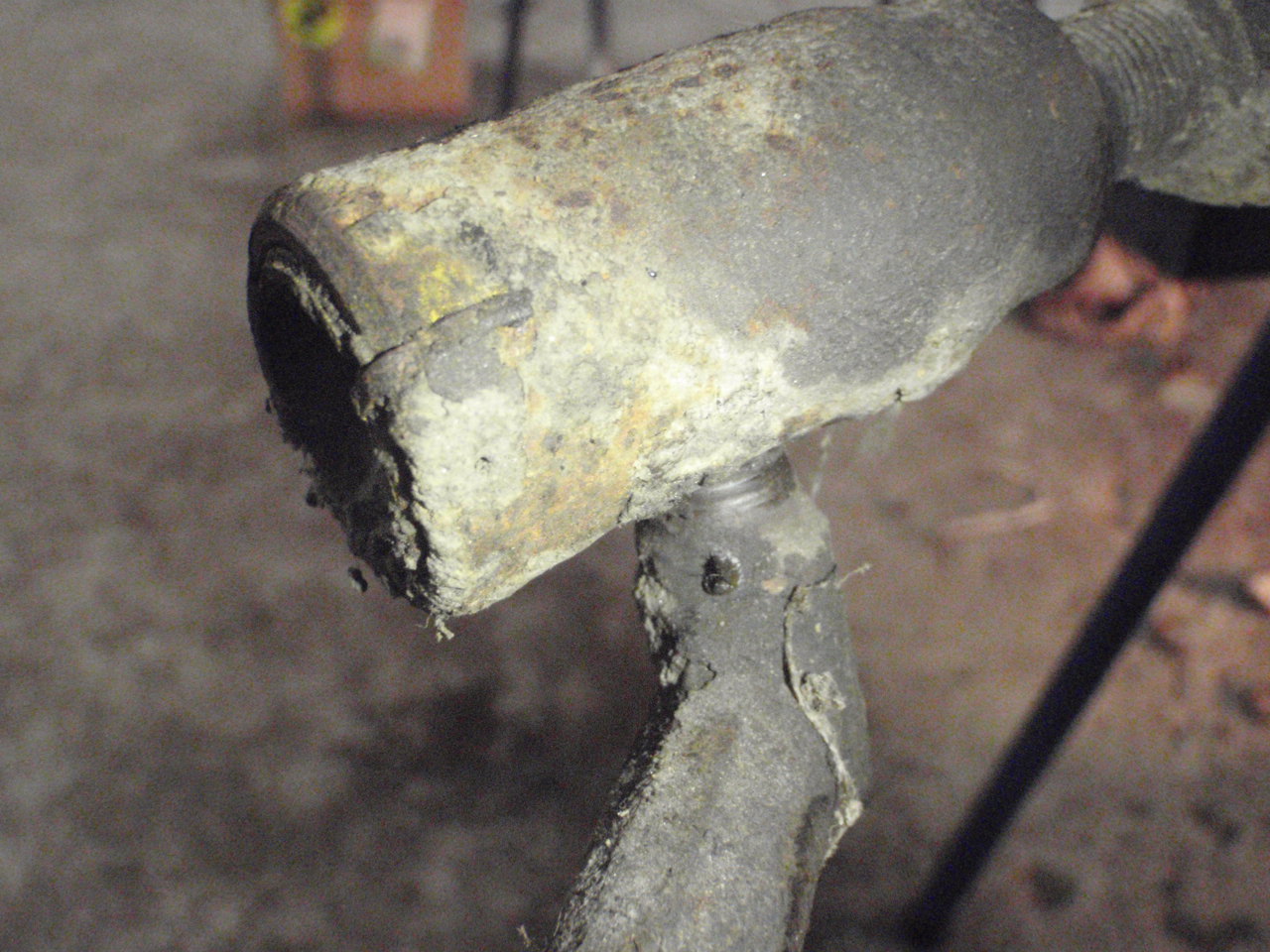

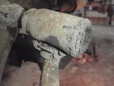

Moving on to the steering

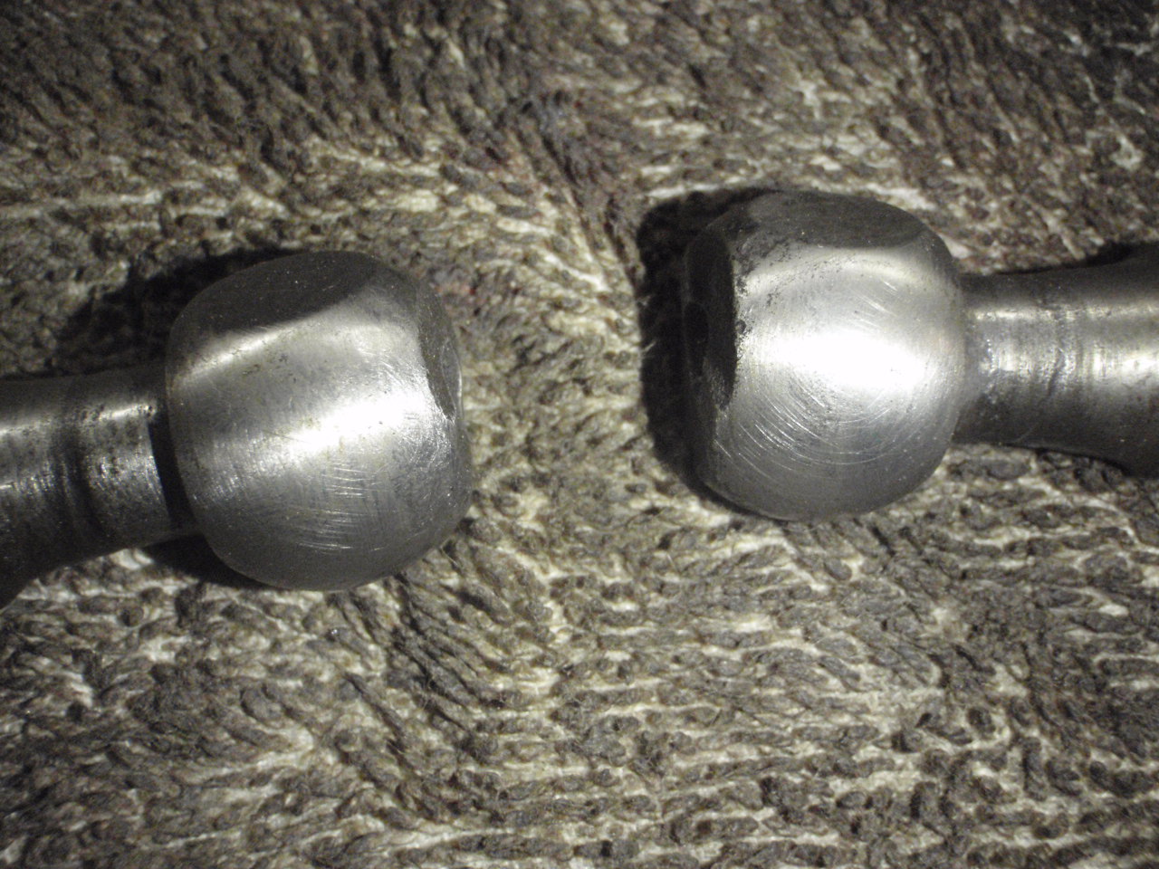

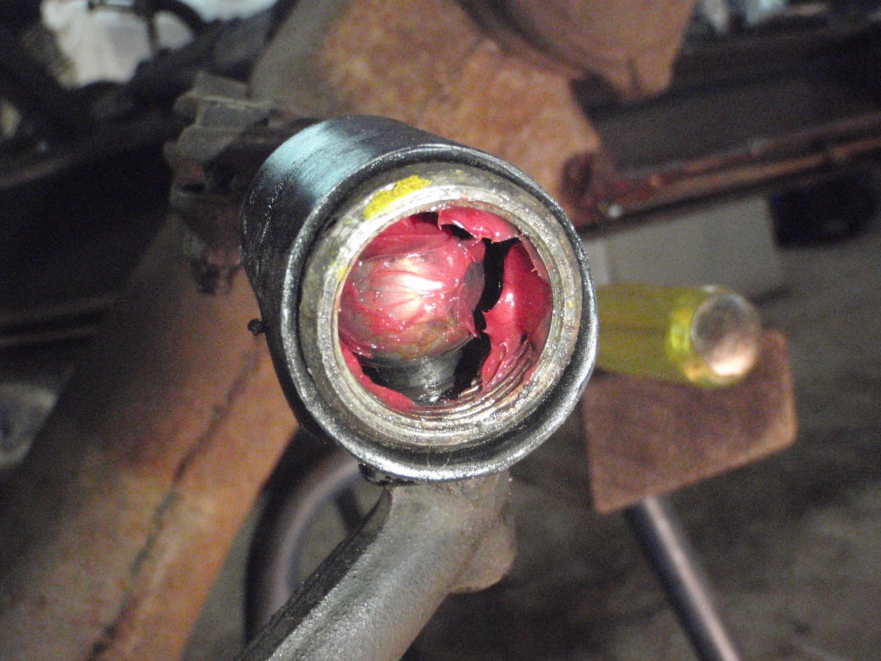

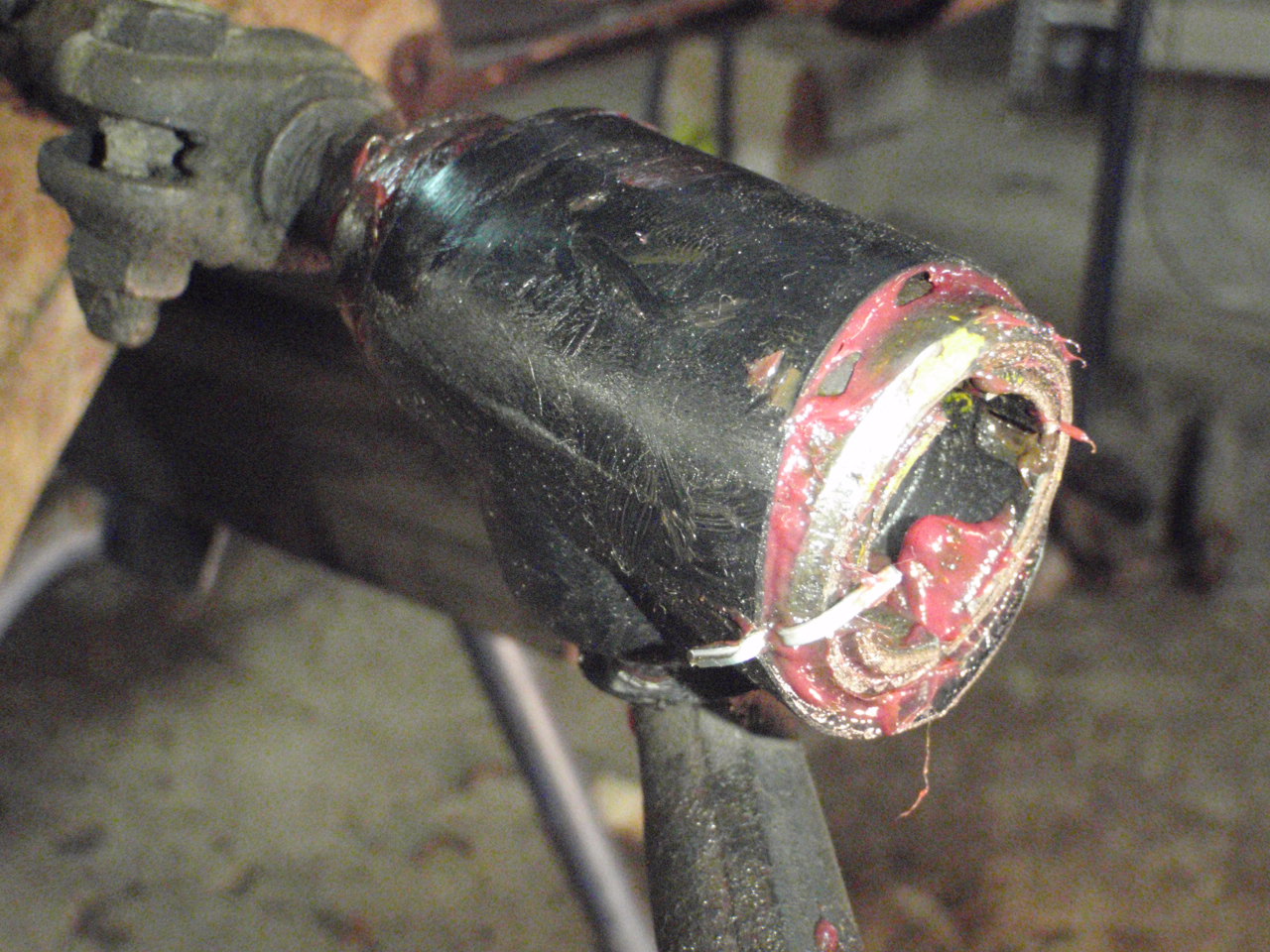

Track rod end housing and steering arm ball joints dry as bone + some minor chips to file away. Cleaned, greased and fitted again with new boots.

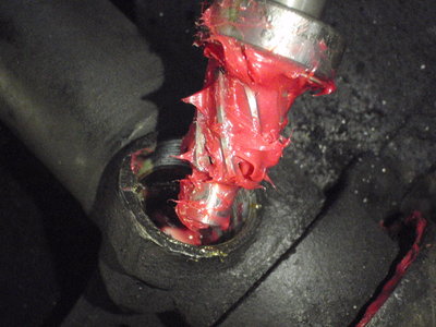

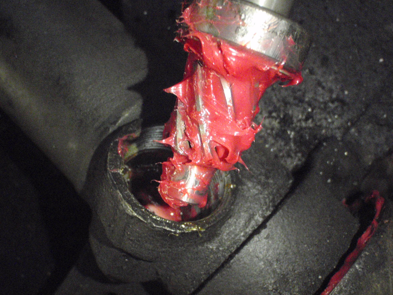

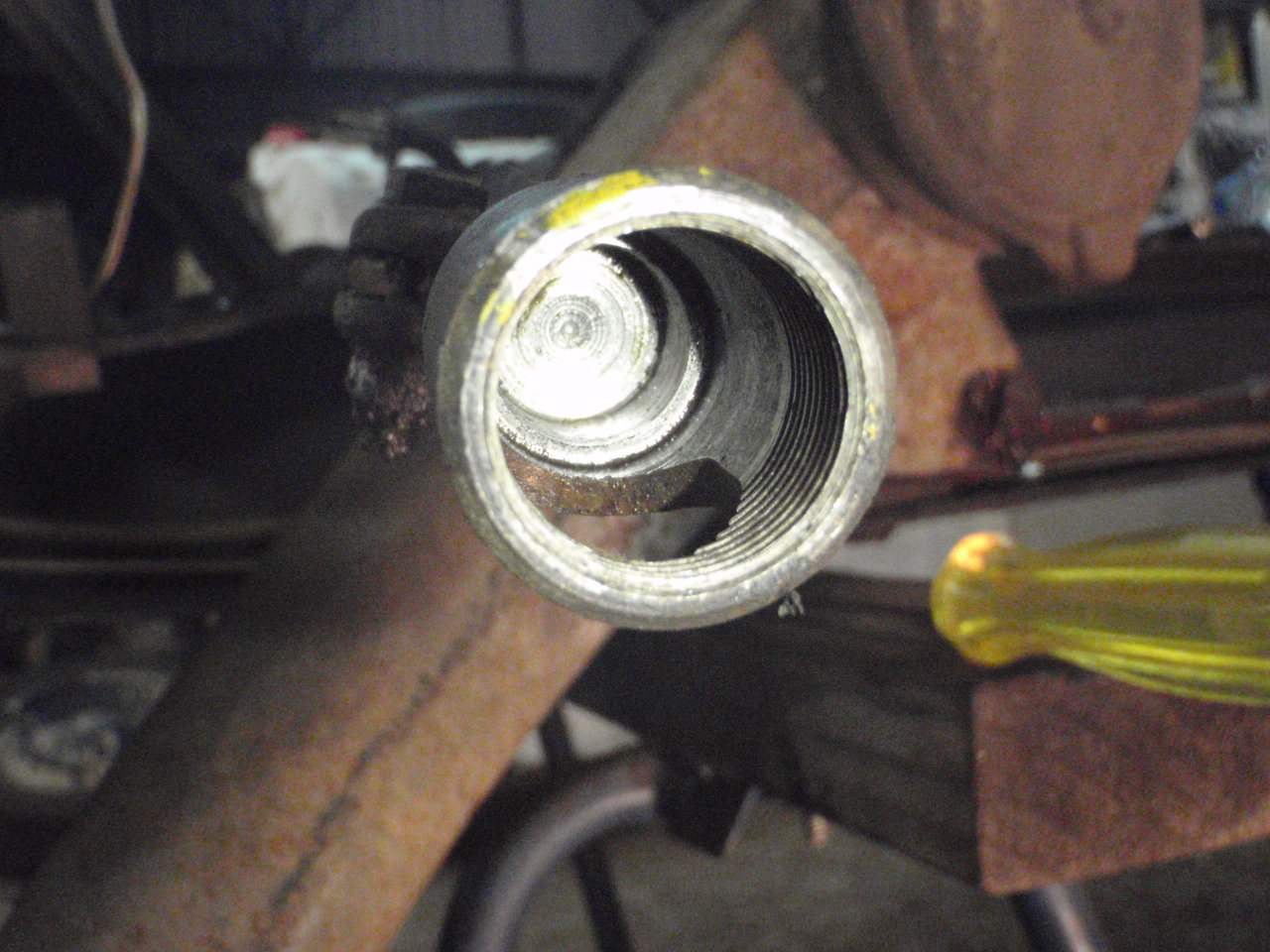

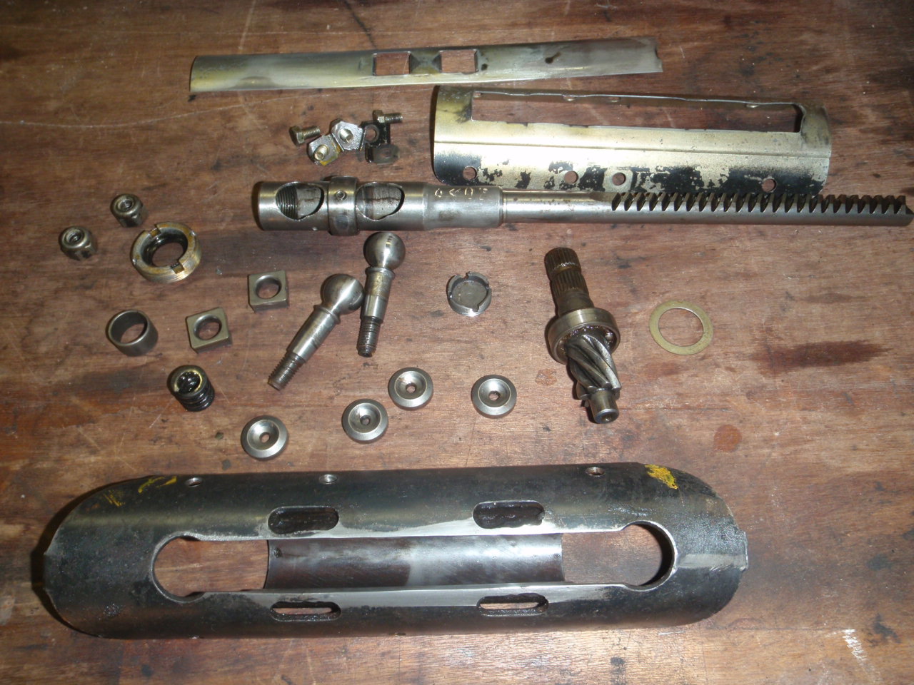

Post Re: Odin

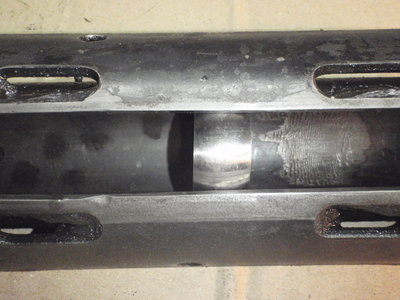

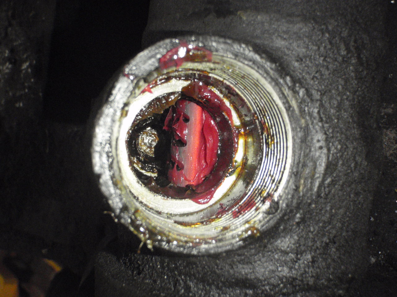

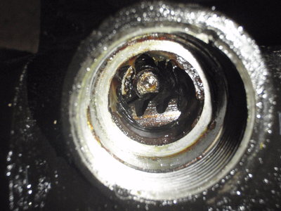

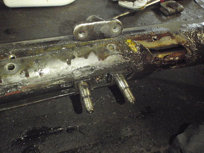

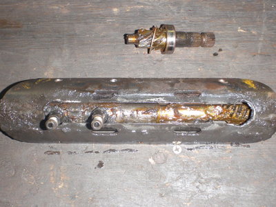

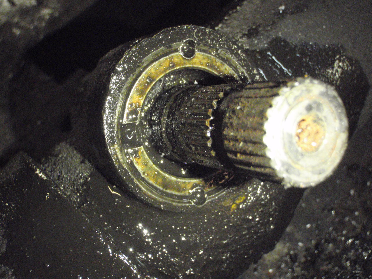

Last job today was stripping the steering rack for a good clean and regreasing.
Pinion bearing buggered.
Guide ring a bit worn.
November 3rd, 2010, 10:38 pm

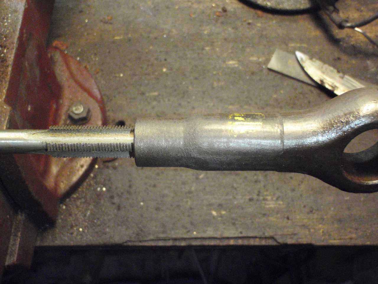

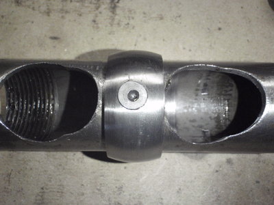

Post Re: Odin

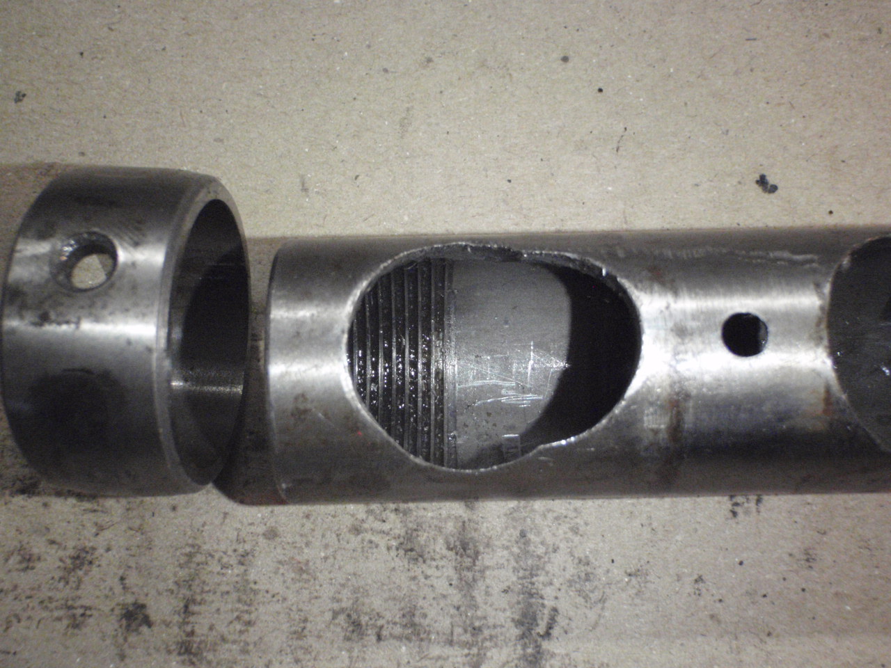

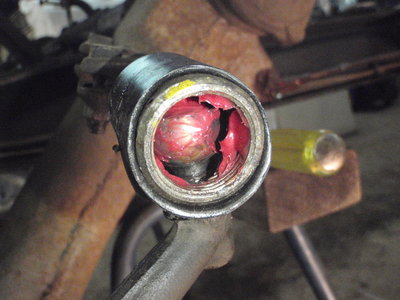

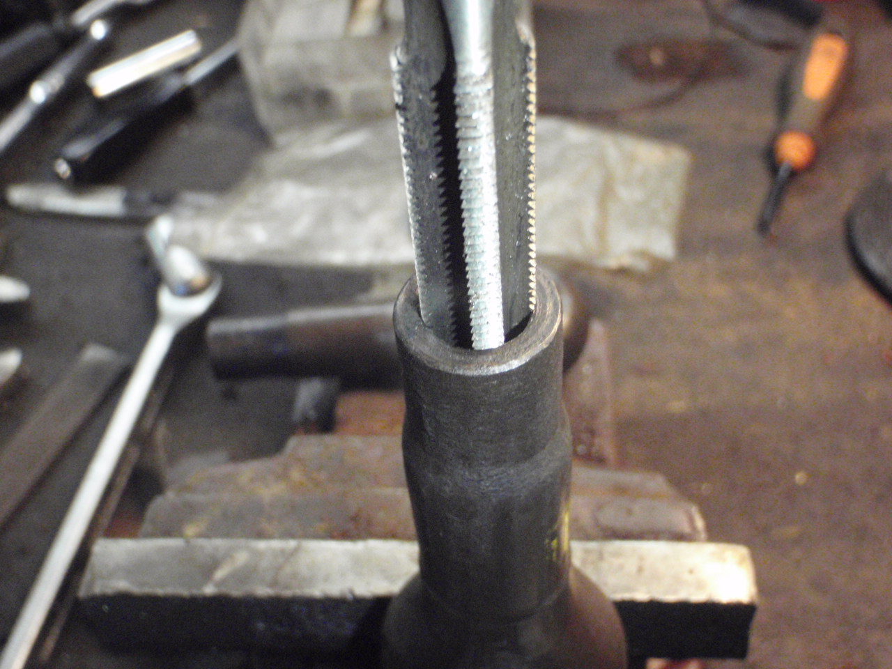

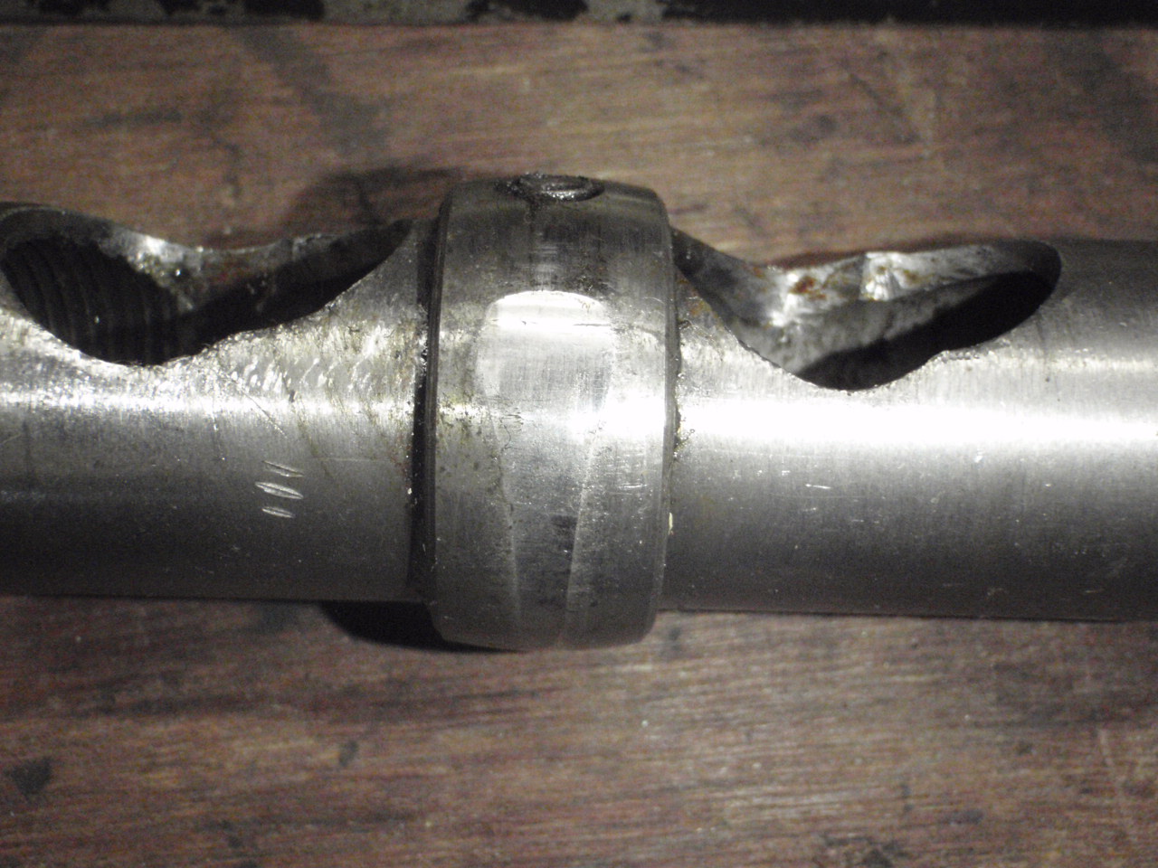

Finished the rack today. When time comes, I'll do a proper steering rack over haul. This will do for now
Removing the guide ring manily due to too much play between the ring and the guide. New ring is fitted tested inside the guide making sure it does not bite on the guide moving it from side to side

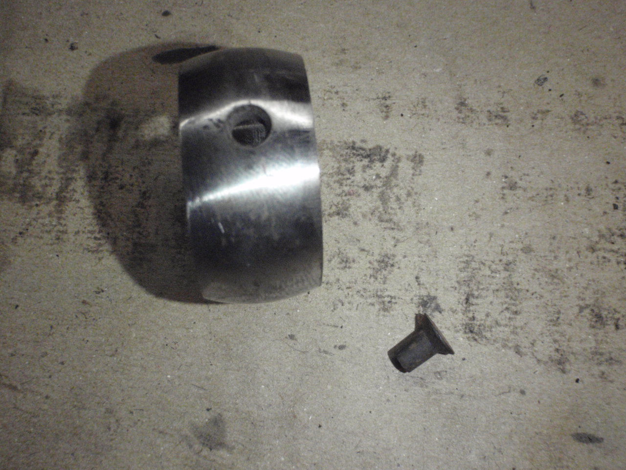

Securing the guide ring with a rivet

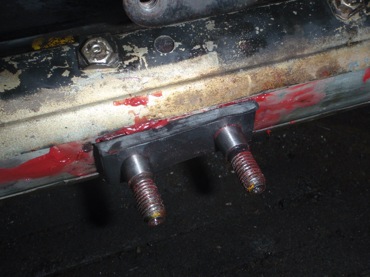

Sorry not photo of fitting and adjusting the ball joints, next time

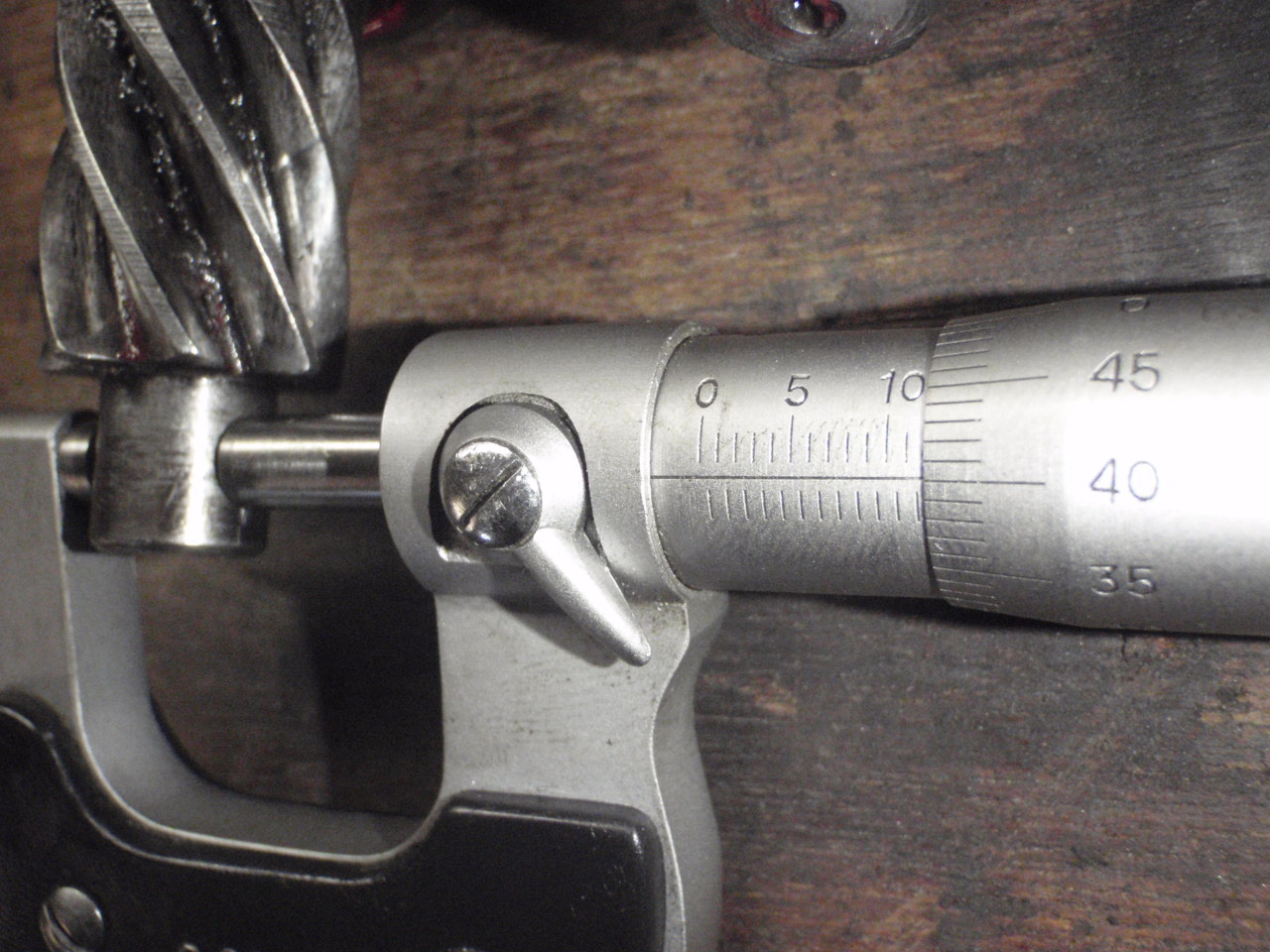

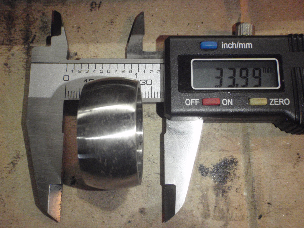

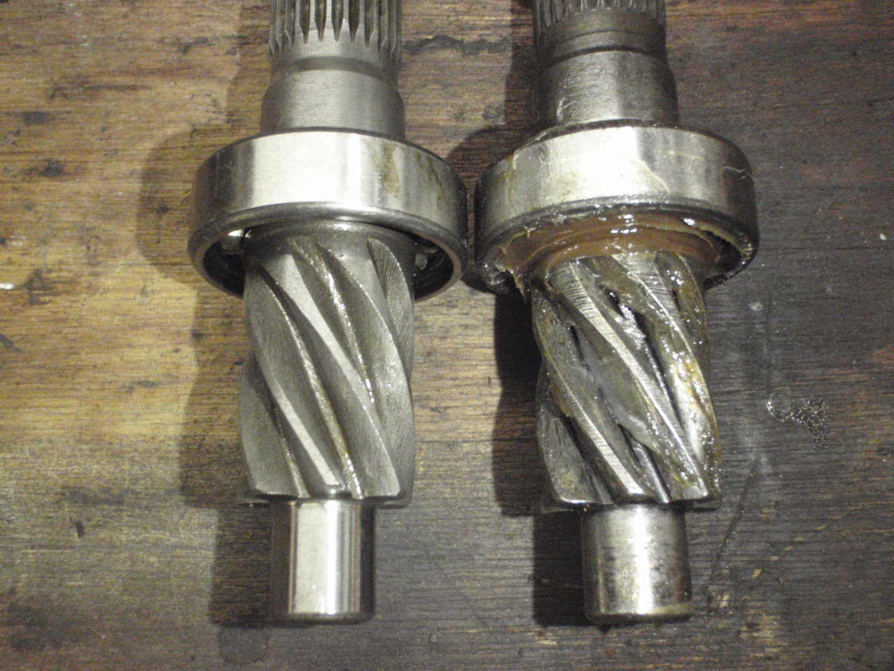

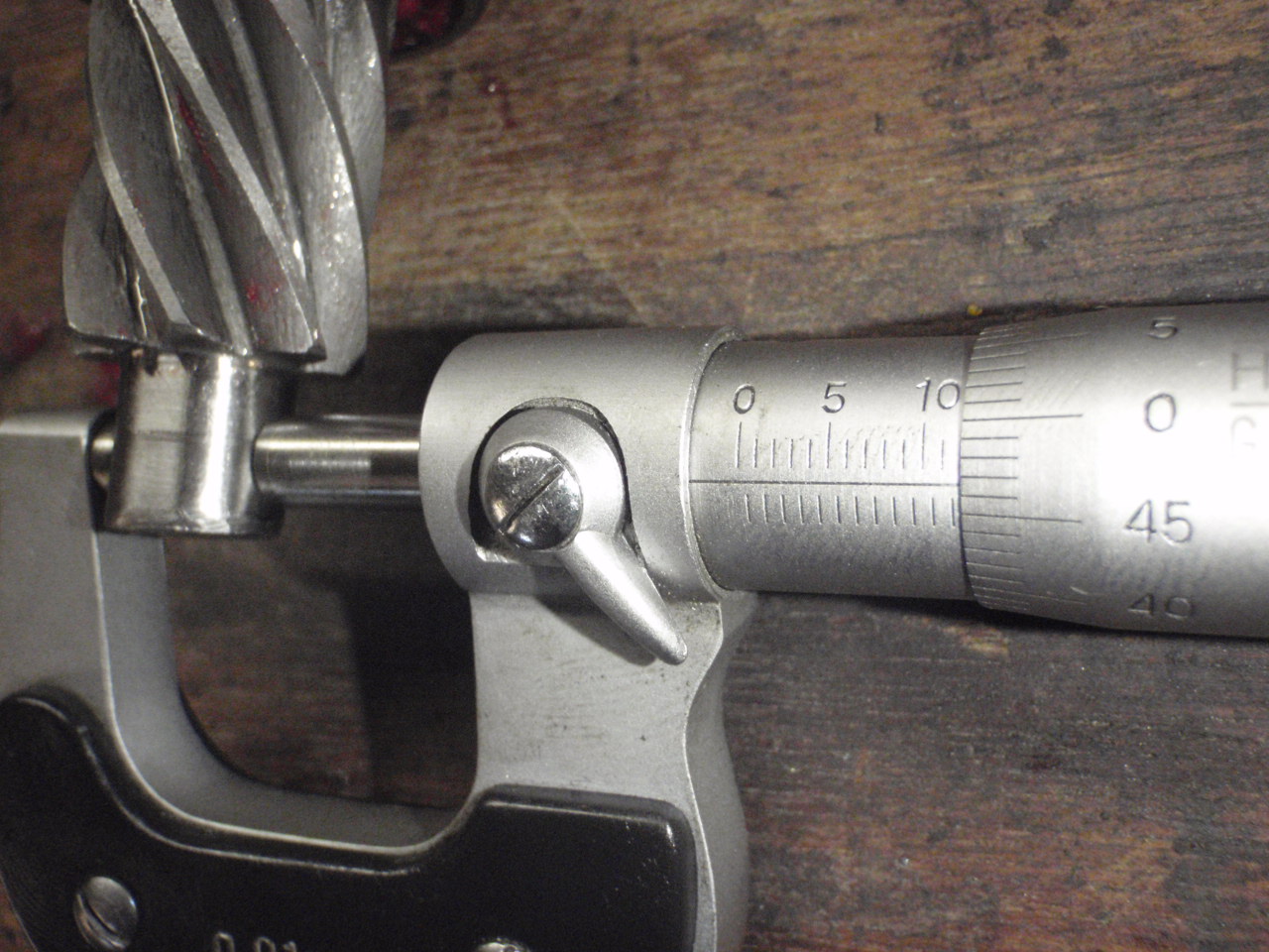

The new reproduction pinion is too big and is biting when fitted in it seat.

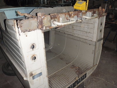

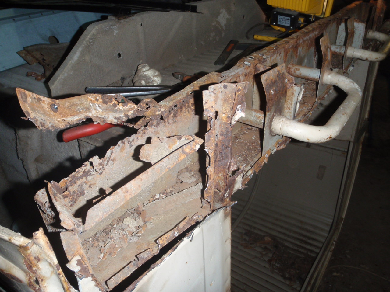

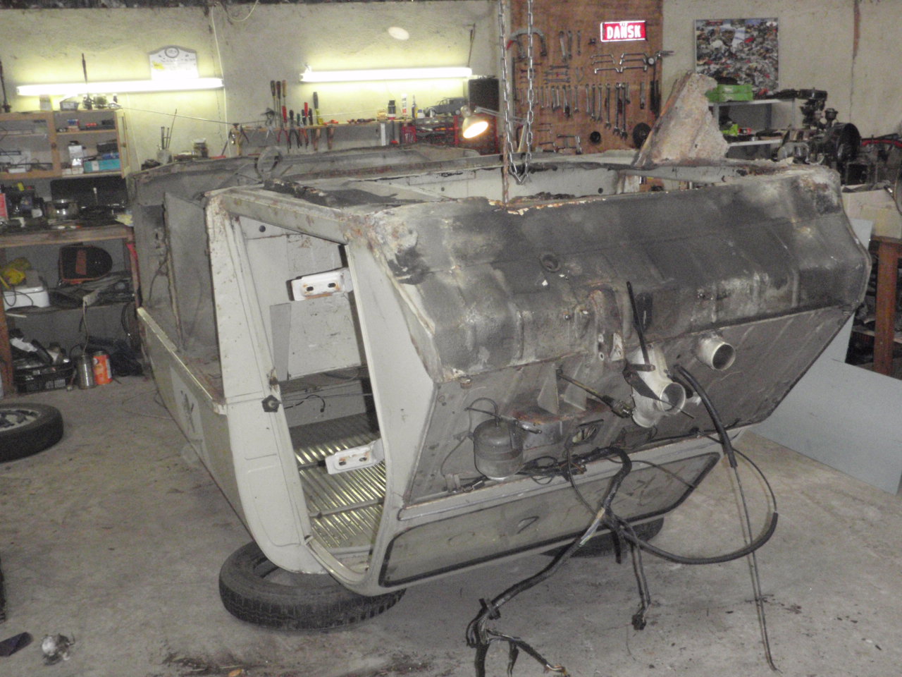

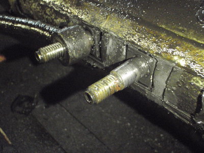

Post Re: Odin
Body work, gives me a break from the mechanics
Not much need for text here, photos says it all.
