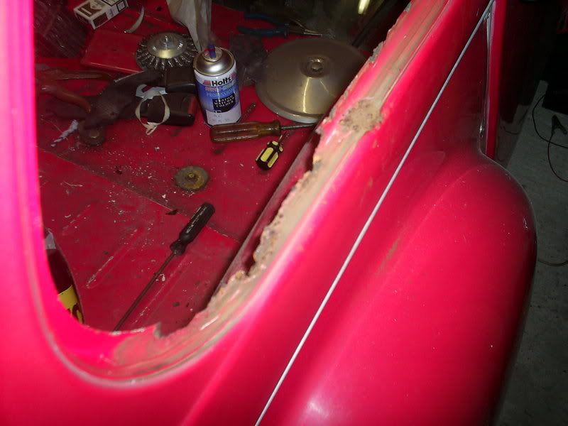

Milde update.
I have left the 3/4 panel for now while I decide what's going to happen with it :( and turned my attention to the corrosion at the LH rear seatbelt mounting.
What initially appeared to be heavy but localised corrosion turned out after grinding etc to be fairly widespread!
I'd been struggling with loosening the mounting bolt that was seized.
As the bolt become increasingly stuck it began to twist the semi corroded mounting plate and soon the reinforced plate added for the seat belt mounting was itself giving way in the wheel arch!
Looking up = looking BAD:
So I got the angle grinder to lop off the bolt and started to remove the crappy rusty grot.
Oh bumhats!
wire brush on the grinder:
More and more of the car vanishes....
So! this entire corner of the car is really quite rusty!! the rest of the car is very solid - including the opposite rear quarter which seems to have survived solidly. I suppose this LH side has succumbed to the ravages of the 'Gutter side' !

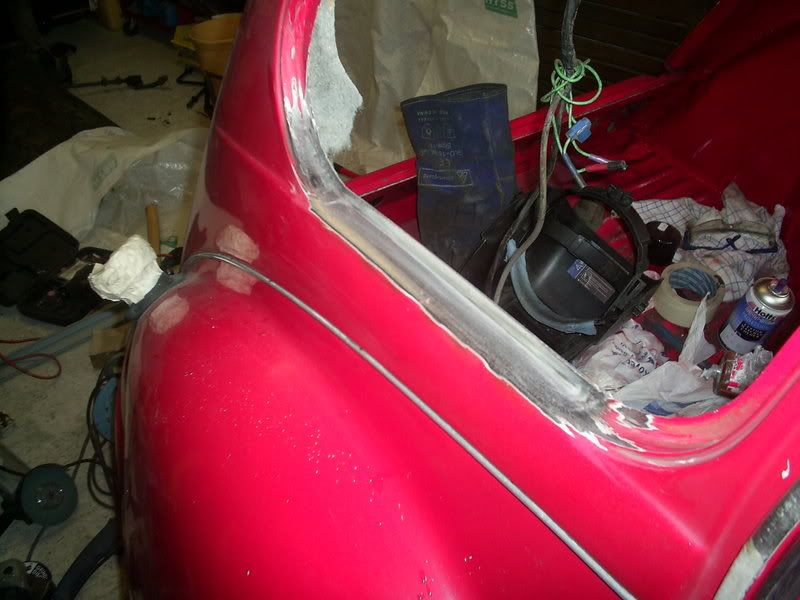

Late, but as promised:
Simply a piece of angle, approx 15mmx15mm welded in and sanded back. The curve at the end was put in by cutting a series of slits into one leg of the angle and curling it up, then welding the slits up and sanding. The curve along the bottom of the window was put in by simply using a rounded hammer and an anvil.

THX what sort of welder were you using for this bit?
A really gash 150a Clarke Mickey-Mouse-MIG, throwaway bottle job. IIRC I used 0.8 wire, but have since been using 0.6 which is nicer.
