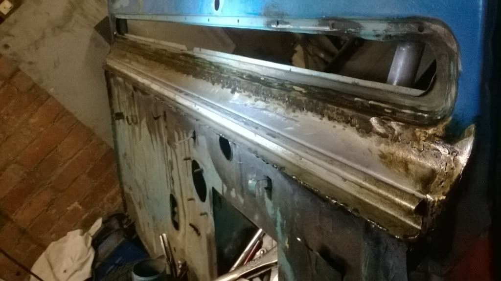

Bit the bullet today. Cut the bonnet hinge to exact size and butt-welded it in place. Took my time - worked out OK if I say so myself:
The welds need a bit more dressing to make them smooth, but that can wait till next time.

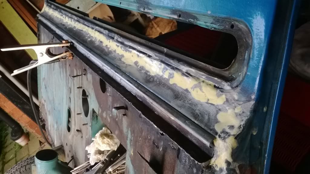

Spent a bit of time dressing the welded bonnet hinge.

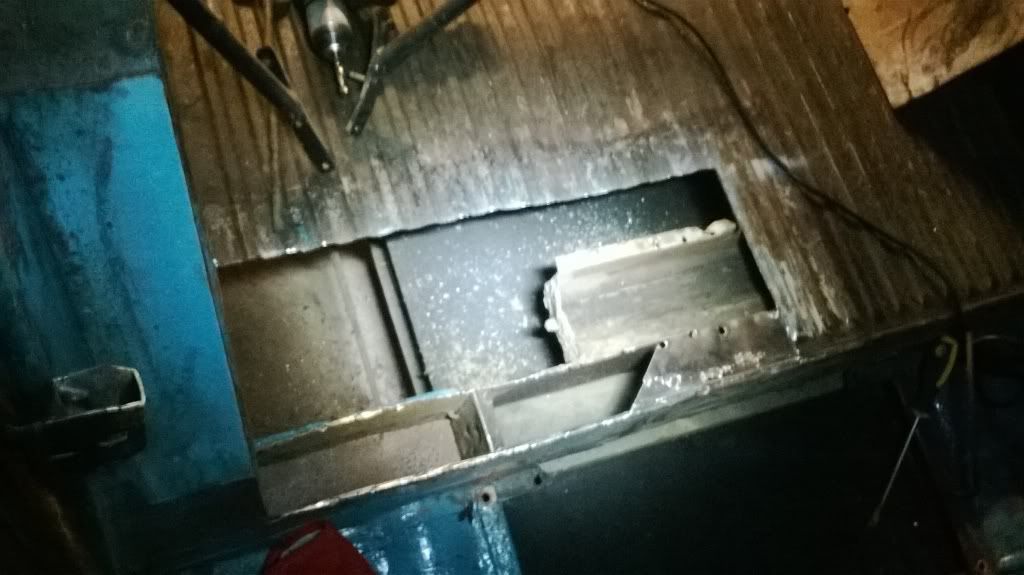

It was cold - the filler took ages to cure. So I set about cutting out the rotten bit of floor.
Quite a lot of cutting and careful drilling out of spot welds later:
Now to get the patch made.
