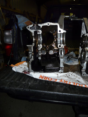

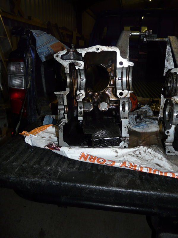

Just split the case and had a look inside... when I looked inside it occured to me (duh!) that I hadn't got a clue what I was looking for!! I took some pics (I'll upload later) and everything looked fine to me, but I need some pointers from you experts with regard to the telltale signs of what constitutes a knackered crank.

Post Re: 1976 AZU250
B@gger,
if I'd noticed this earlier, I'd have advised against splitting the cases, as putting things back together correctly is always more difficult than pulling them apart.
A preliminary test of the crankshaft would have been to check for any 'in & out' play of the con rods, as it's invariably one of the big end bearings which fails first.
Mind you, now that it's apart you can do the definitive test which involves suspending the crankshaft in one hand and striking the top end of that con rod with a gloved hand.
If you hear a definite 'clack' noise, there's play in that rod's big end...
Also check the camshaft for wear on its lobes, most common on the ramps of the exhaust lobes for some reason.
Opening the engine case was an interesting and satisfying experience. After removing the various nuts and bolts, cracking it apart felt rather like separating the halves of a chocolate easter egg!
There was a load of sludge at the bottom, as I expected, which all cleared away after a quick dunk into a bath of petrol. Everything moved freely and I couldn't see anything horrid - although I'm going to have to go and look up the whereabouts of con rods, big end bearings, exhaust lobes and so on in order to know for sure.
Here's what I saw:
Putting the case back together was interesting. The crank wouldn't turn when I tried to tighten the case (the two halves were very reluctant to mate together), so I loosened everything off and will leave it with a slight gap for now.
