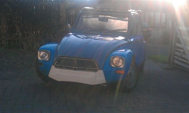

File comment: Still loads to do, as I'm not just going to get it roadworthy and Mot it, will spend a bit more time and get everything done before it hits the road..

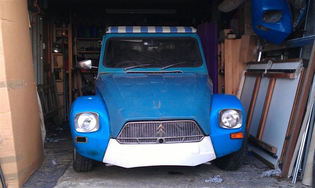

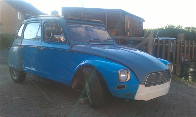

File comment: Back home on the drive 2nite...

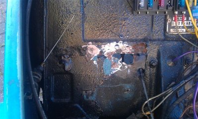

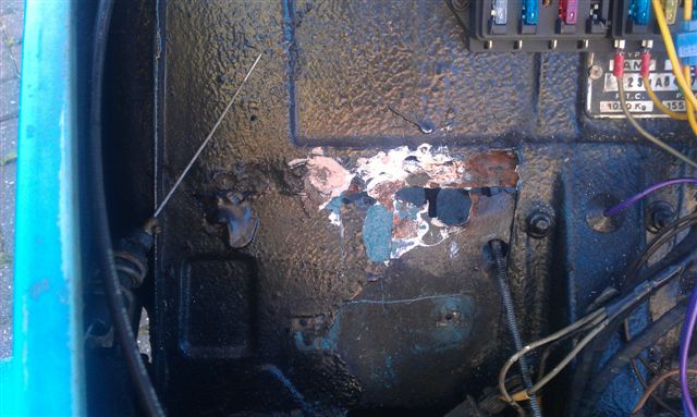

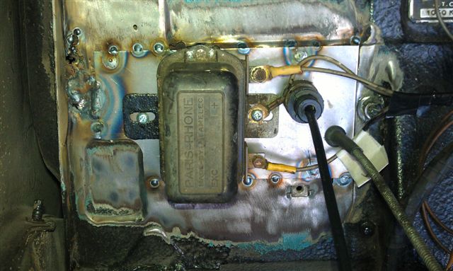

File comment: Still need to weld in new metal on bulkhead for the accelarator cable as it looks a bit tasty!!!

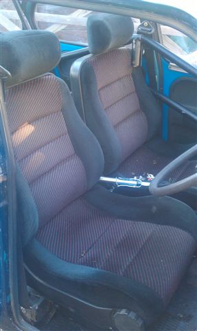

File comment: Got some Bx seats in...

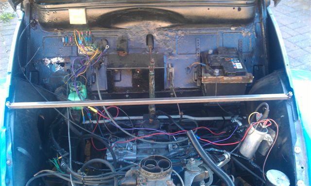

File comment: new brace across the middle, will support a bit more bracing going on bulkhead later.. and the standard one was fouling the gear change!!!!!

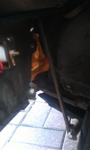

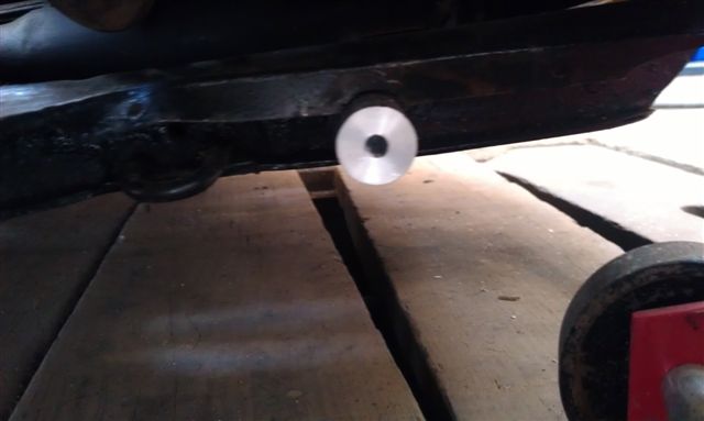

File comment: new aluminium spacers, found 2 M8 holes in the chassis which were ideal to mount a wing support off the headlight bowl as on a dyane...work out quite well..

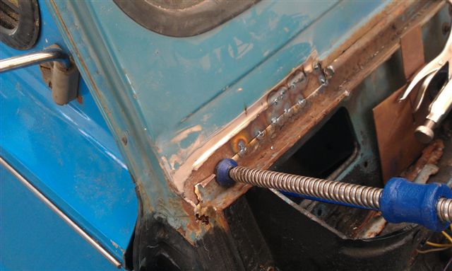

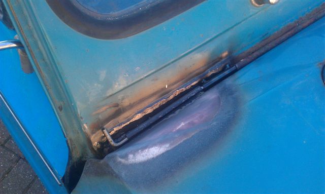

File comment: Trying to fix the bonnet pins, what a twat...ending up finding a load of rot and having to cut out and weld in new metal!! Eventually got the pins out of bonnet after some heat as you can see from the paint on the bonnet, but at least that are out and now it open up properly!!
