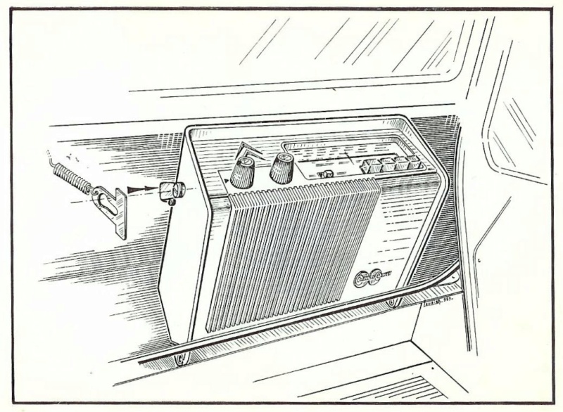

Also , just received from our friend Fer this interesting document :
... which will allow me to replicate the famous hooks
Many thanks Fer

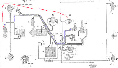

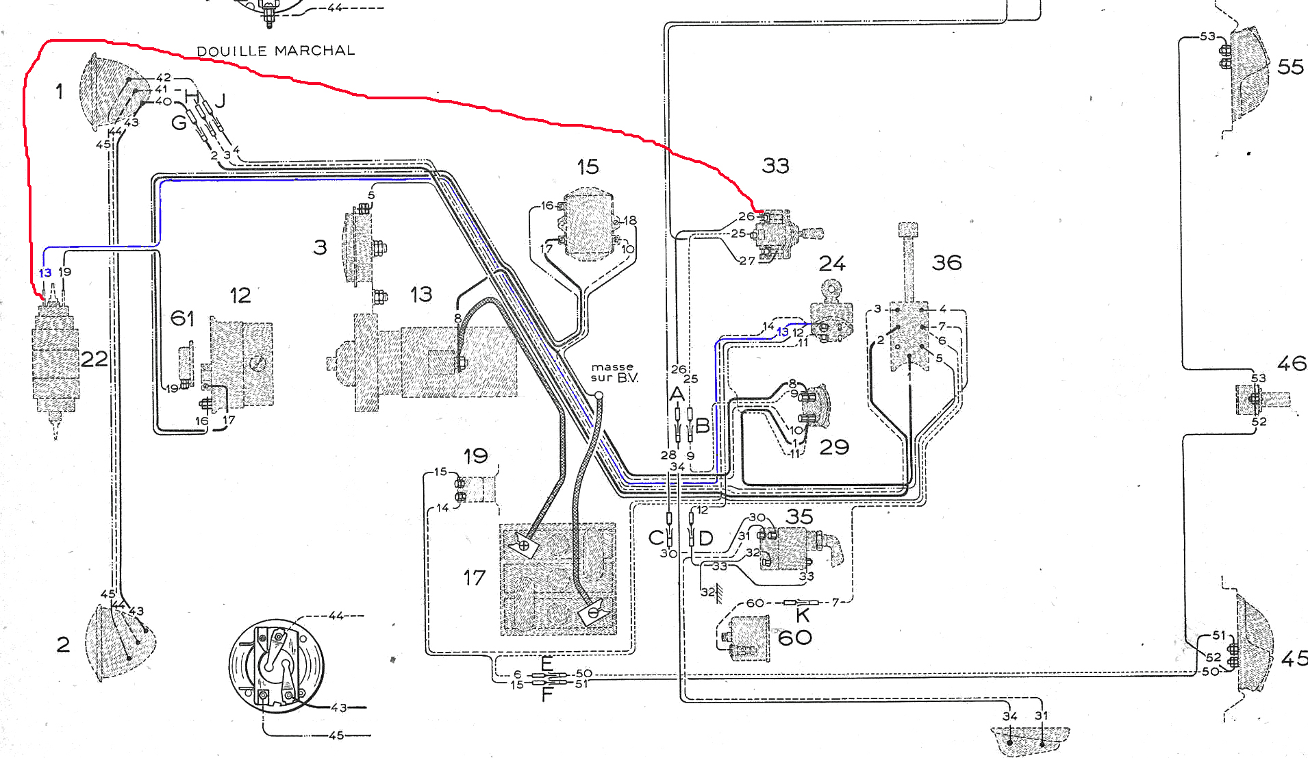

My AZ 56 is running well ... most of the time !
From time to time , there is a misfire or the engine stops! ... but can be started again . Annoying !
I checked , dismantled the ignition switch .. No improvement .
I have added a wire ( red ) between 26 ( parking light switch which is directly connected to the ammeter ) and 13 ( coil + ) to activate as a back up if this happens .
Curiously this gremlin is more and more frequent ;
I cannot see any reason for interruption on the ignition cable 13 ( blue )
Any idea?
Many thanks
MG

Broken cable or connector?

Hell Fer,
As can be seen on the diagram, cable 13 is in one piece without connector .
The cable must be broken somewhere but the difficulty is that the interruption is only temporary;
it lasts maximum 30 sec so i cannot test the cable .
Anyway cable 13 is within a large conduct cable , and impossible to reach without dismantling it.
This is the original cabling in good condition and there is no sign of wear ,
I think that i will have to disconnect cable 13 and fit a clone of it .
MG
