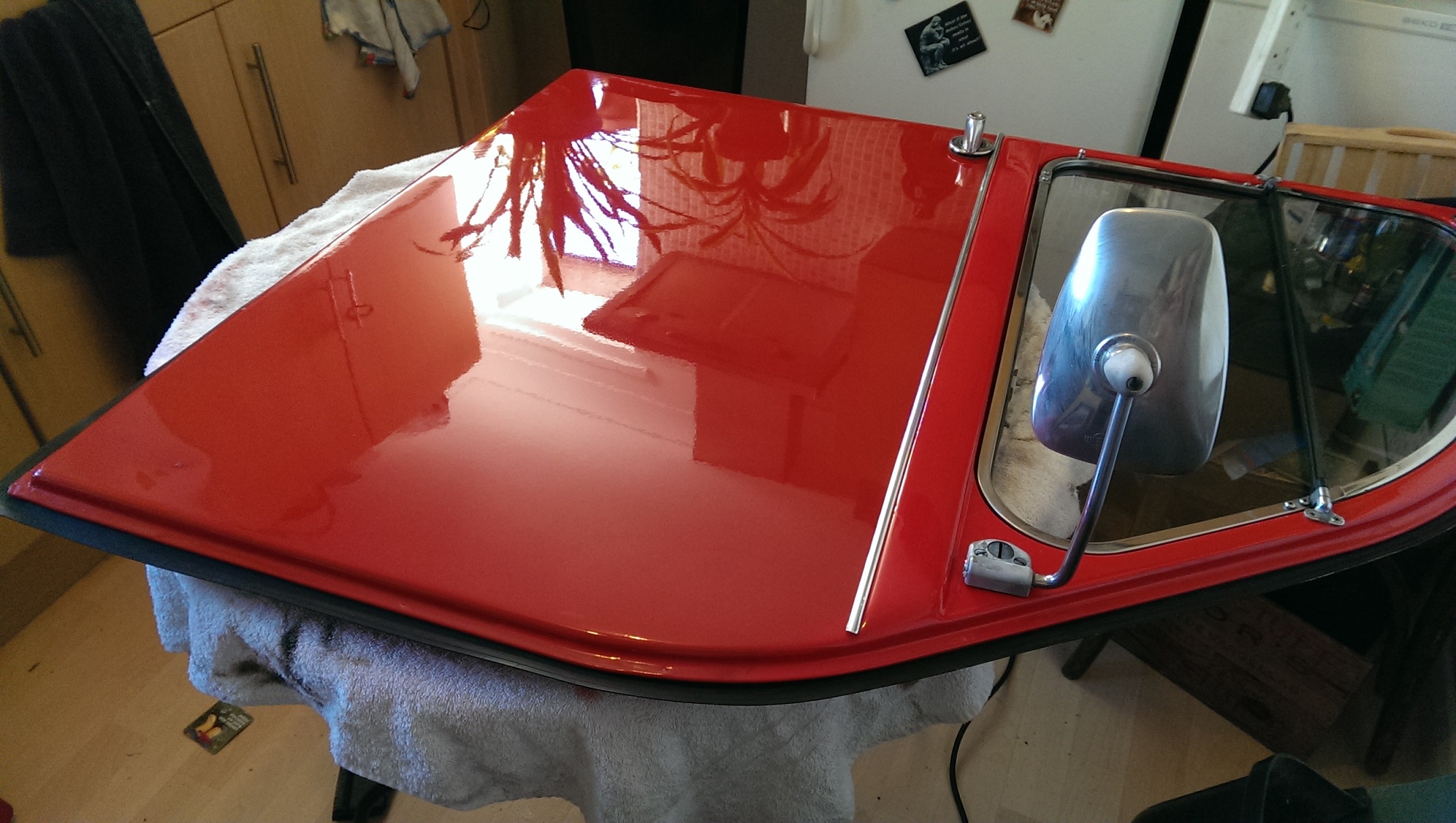

In total i did the windscreen surround, each B pillar, each complete sweep, and the tops of each door from the side trim upwards. As there were blisters where the water sits in the window opening. I'm learning, with a 2cv if you poke at a blister, even a small one, the metal is so thin theres probably a hole there. I rustproofed the surfaces from the inside with Dynax wax too.
My paint is badly dehydrated from using a diesel powered jet washer too hot and it fades after even one week in the sun. I thought doing these upper parts would make it look a lot better.

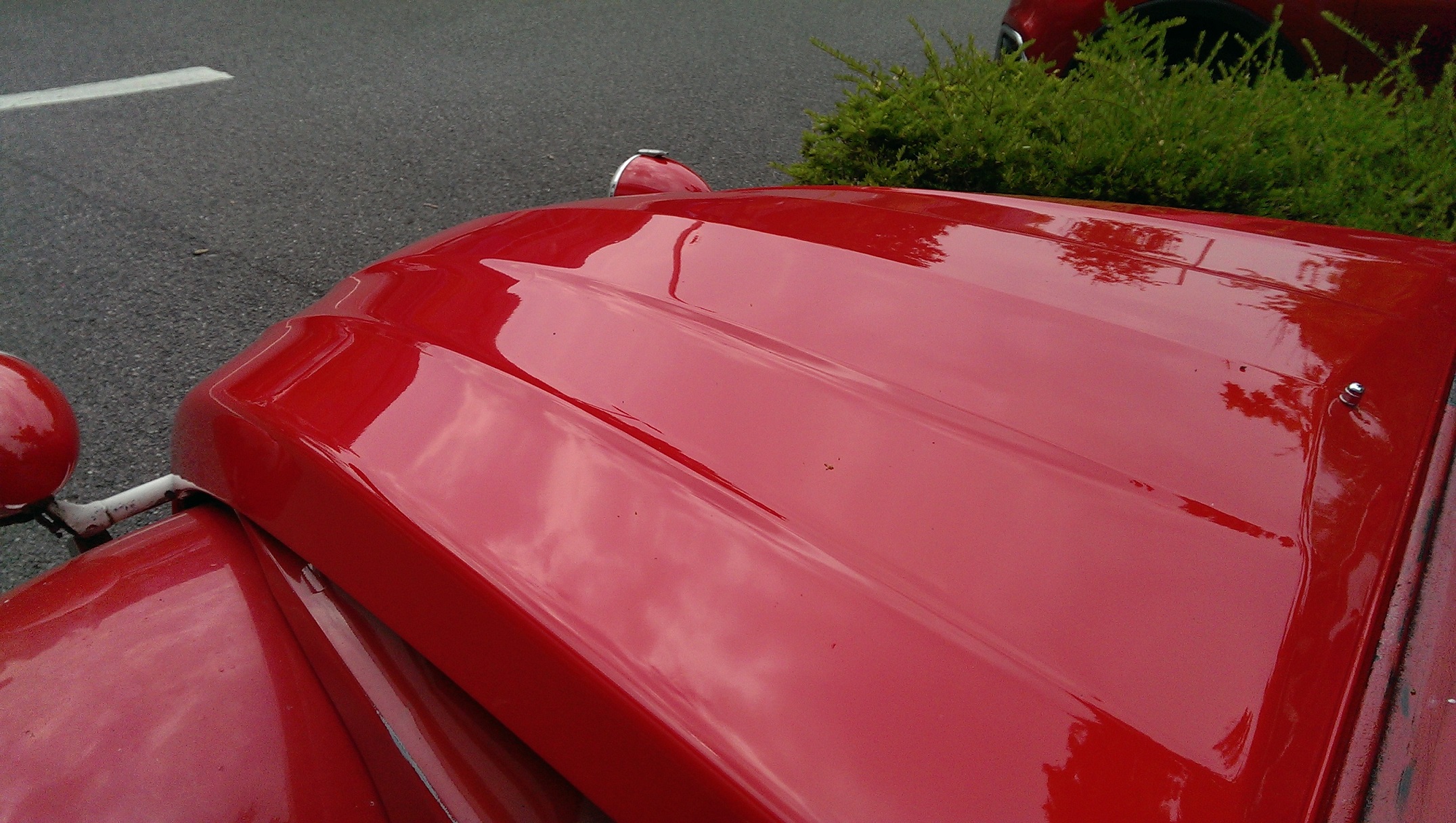

I've machine polished the remainder of the paint on all the panels I could bring indoors. Shiny! Also got my bonnet painted professionally - money well spent I expect, as he said the paint should be UV resistant and its been baked etc. It looked like a total bag of poo before even after polishing so I'm pleased with that. Example of door shinyness! Putting these back on the car made the rest of the bits that I hadn't done yet look really funny...
And shiny bonnet.

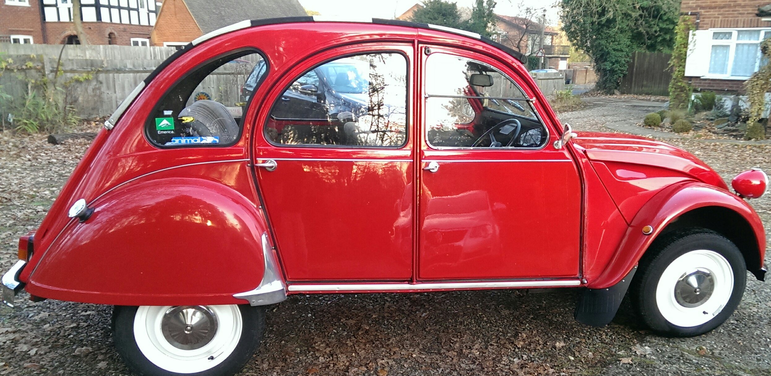

First wash and brush up since putting it back together. Very pleased with how it looks. Next up will be new wings, painted by the bodyshop if possible. I got a quote of £90 each if I paint the backsides.
It's fine as it is for now though. Now to angle to get some new wings for Xmas.....
